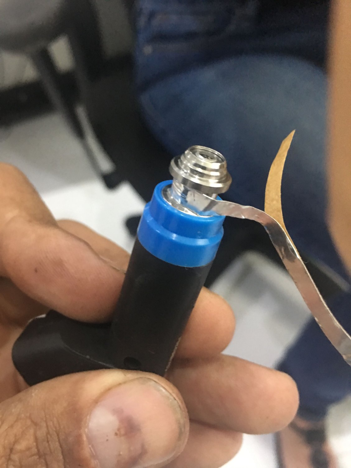

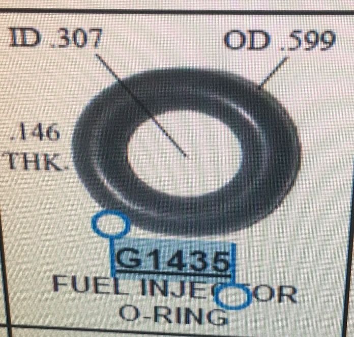

Hey guys , well I'm using a Fast Lsxrt intake for my turbo setup with Deka 80 lbs injectors. The problem I'm having is the o ring that Fast provides ID is to big for the Deka injectors and they are loose. The size I need is
.61 OD x .30 ID The closes thing I found is .599 OD x .30 ID and they are a bit loose on the intake side. What O-rings are you guys running with the Fast intakes. Thank you in advance.
I was thinking of making the OD of the actual injector bigger by wrapping it around with some aluminize tape to make the OD match the Fast O-rings but I'm not sure if that would be a good idea.

This are the closest o rings I've found but the OD needs to be .61

So I needed up making the OD of the injectors bigger with aluminum tape to make the o rings fit better. It worked like a charm

I would like to hear why it wouldn't work out ... I spoke to injector connections and they said that is fine and they do this for a living ... but if you guys have another input as off why this wouldn't work I would love to hear it

I don't think you understand. They don't have the correct o ring to work with the deka injectors .. we would just have to agree to desagree.. not everything in high performance fits perfect sometimes you have to cut , bend , and think outside the box to make it work .. I needed to build up the outside diameter of the injector so I used aluminise tape that its actual aluminum... but that's the way I did it and I'm happy with it.
