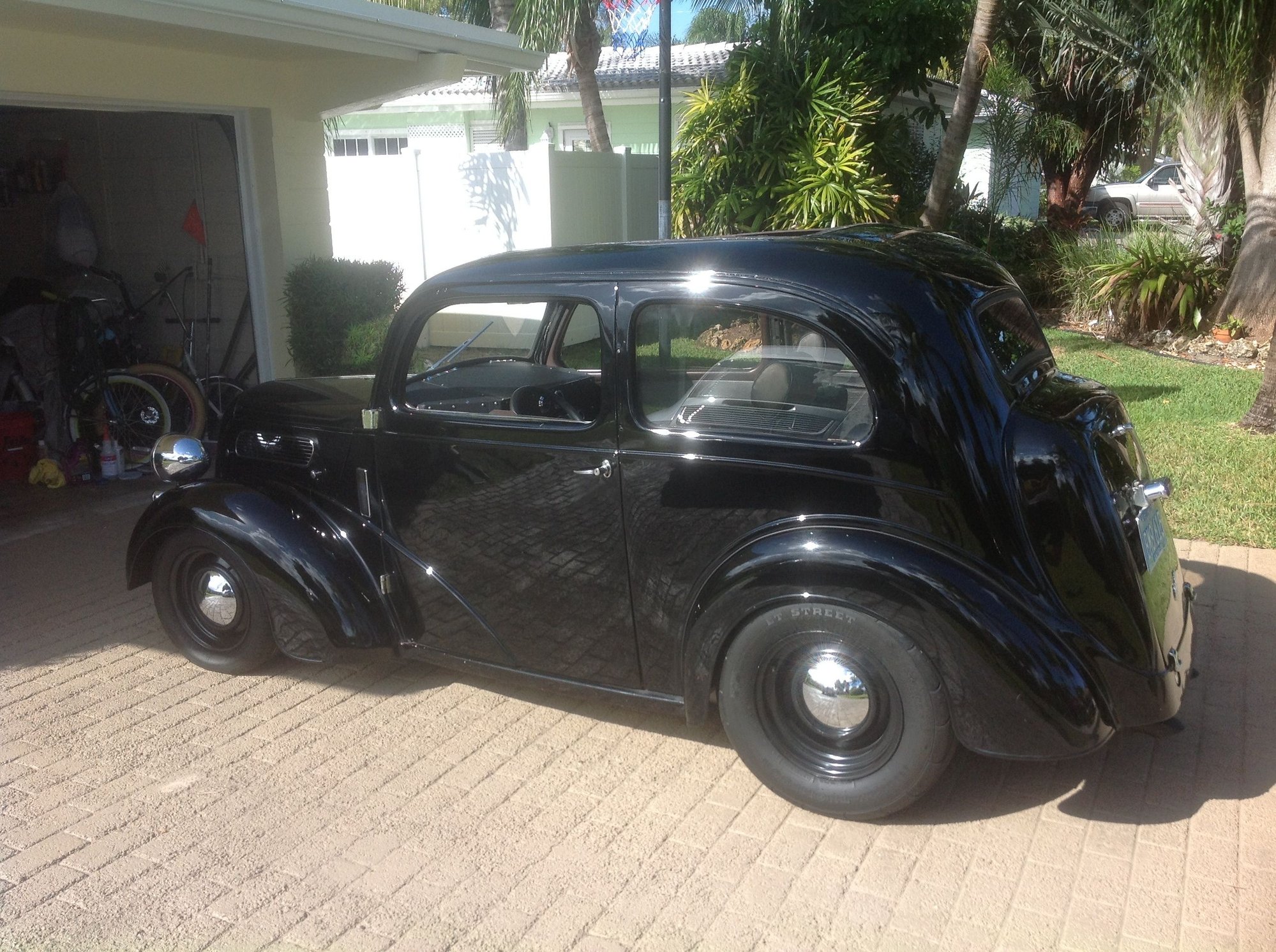

Subject car
Here are my goals: car to be street driven power range 500-600rwtq reality is doing turbo for looks and sound cuz 2500lb car moves pretty good NA, prefer no meth but open to E85 After reading a ton of turbo/turbo build threads I believe a 2.5" piping with a BW variant turbo. I don't have much room for an IC so I might have to do meth. Thanks for any advice.

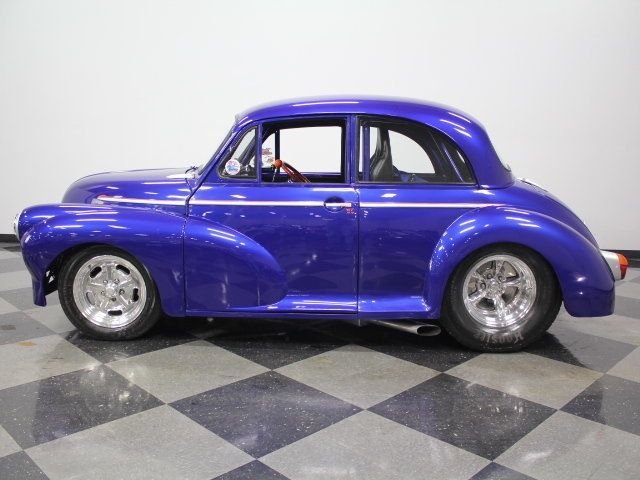

Here's a couple pics of oi' Morris

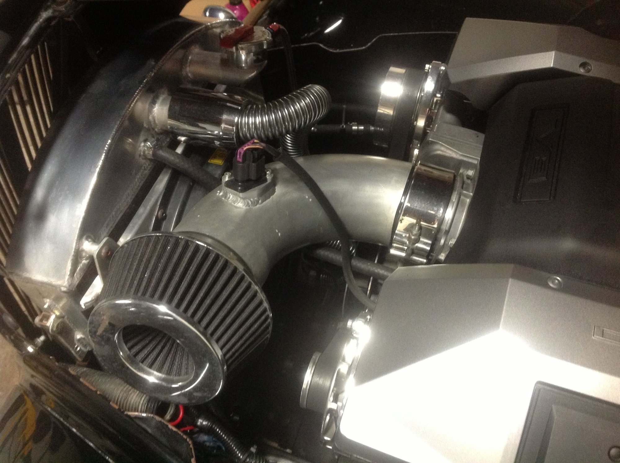

Here is the air intake setup not the best but limited space.... IATs are north of 150*

The more I look at your car the more I like it. Did you convert it to left hand drive? I like the smoothies on it, but I would probably paint them a contrasting color to the black, like almond, coral, or salmon, one of those colors from the 50s. Is that radiator a PRC outa Indiana? I have one in my '41 olds that looks a lot like that. I'm guessing a vintage air system too, so you have a condenser on the front of it?
Seeing your engine bay I'm not sure where you could fit a turbo. You could probably gain power, just as it is without turbo charging, switching to E85 with IAT like that. I would think if you found a way to draw the air into the turbo from in front of the condenser you would drop IAT considerably.
Have you considered pulling it all out and making a custom recessed firewall that would allow the engine to move back about 6". Then you would likely need to raise the trans tunnel. A lot of work just to add a turbo. Prior to the LS engine invention we old school guys used to do that to get big blocks in those prewar cars. It is certainly a challenging looking situation.

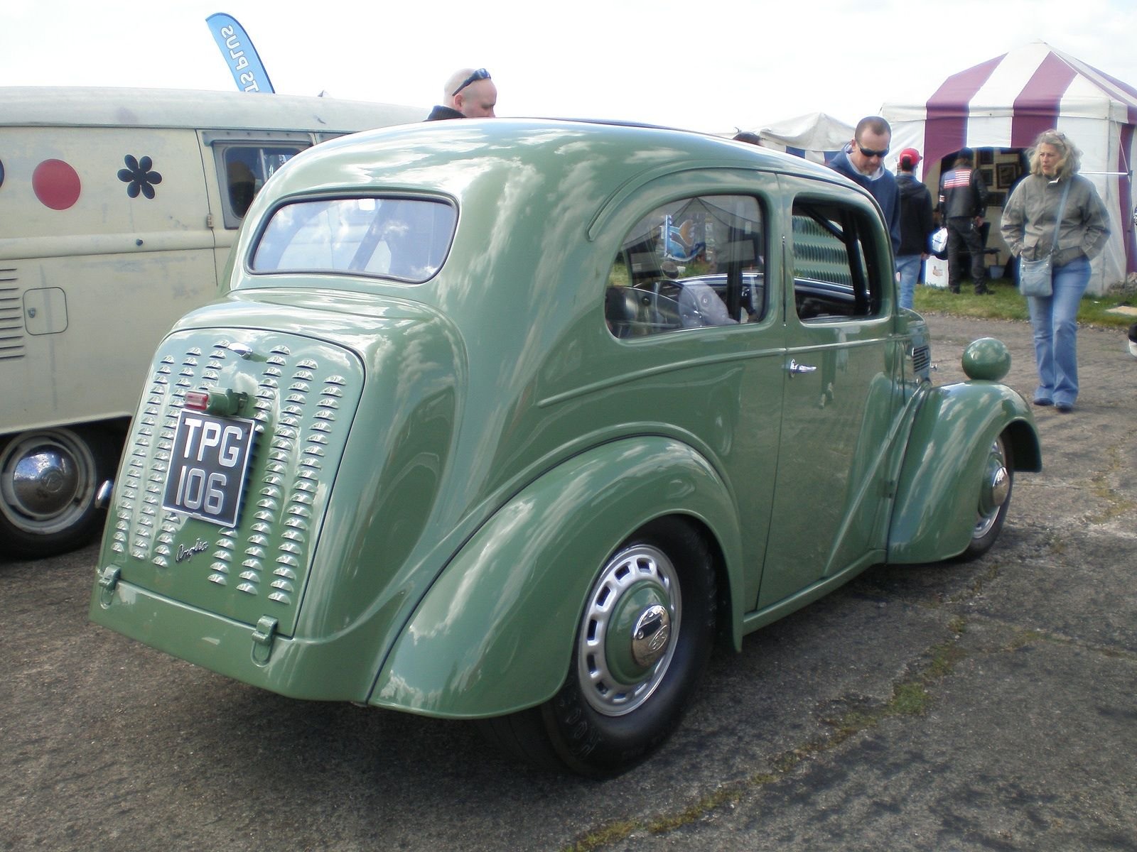

Acquired converted to right hand drive. Paint was done in mid 80s for Car Craft shoot. Original color and wheels looked like this car from England

Radiator is an AFCO unit. Was thinking that turbo would go where filter is with intercooler in front of condenser. I have a gap above the radiator and shroud to bring cooled air charge back into engine. Engine is setback a good amount now as I basically sit over rear axle. Maybe LT replace the cast manifolds a little meth call it a day and skip the turbo?.....
