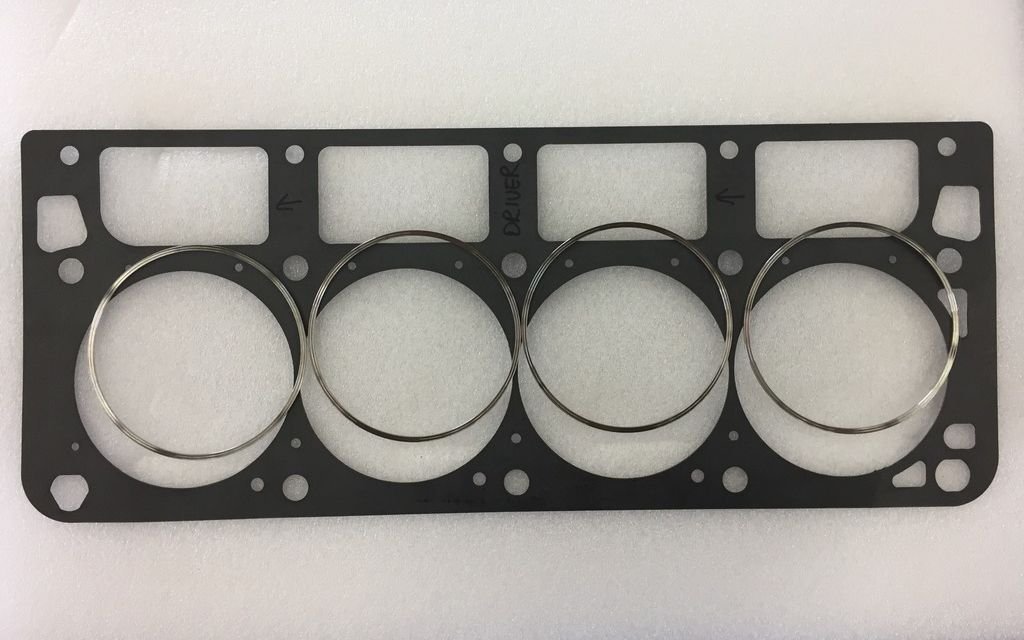

These gaskets and 1/2" studs. And the gaskets are USA made!!!
truth.....these things are unreal
Details?

^^^I have not seen those. Please provide details and vendor
Old Jun 15, 2017 | 12:12 PM
DBRODS's Avatar
Joined: Jan 2009
Posts: 368
Likes: 44
They use a stainless ring with 3 cutters machined in the top of the ring. When you torque the head down the rings cut into the head 0.004. The graphite gasket seals the oil and water. I have been using these with great success for the past few years along with 15+ other setups. They require no machine work to run them. My setup has been pushed to 38psi on 4bolt heads and not a sign of lifting a head. The vendor that makes these is NOT a sponser on tech so I cant say. I used to import them from Sweden from Andreas but now they are made in Texas with a few design upgrades. Here are some pics of a head that was using them. You can see how they cut into the head.
Old Jun 15, 2017 | 12:32 PM
asubennett's Avatar
Joined: Jun 2012
Posts: 363
@dbrods.... The rings are supposed to be reusable but have seen a few that look ovaled out after removing the head. Have you experienced that at all?
