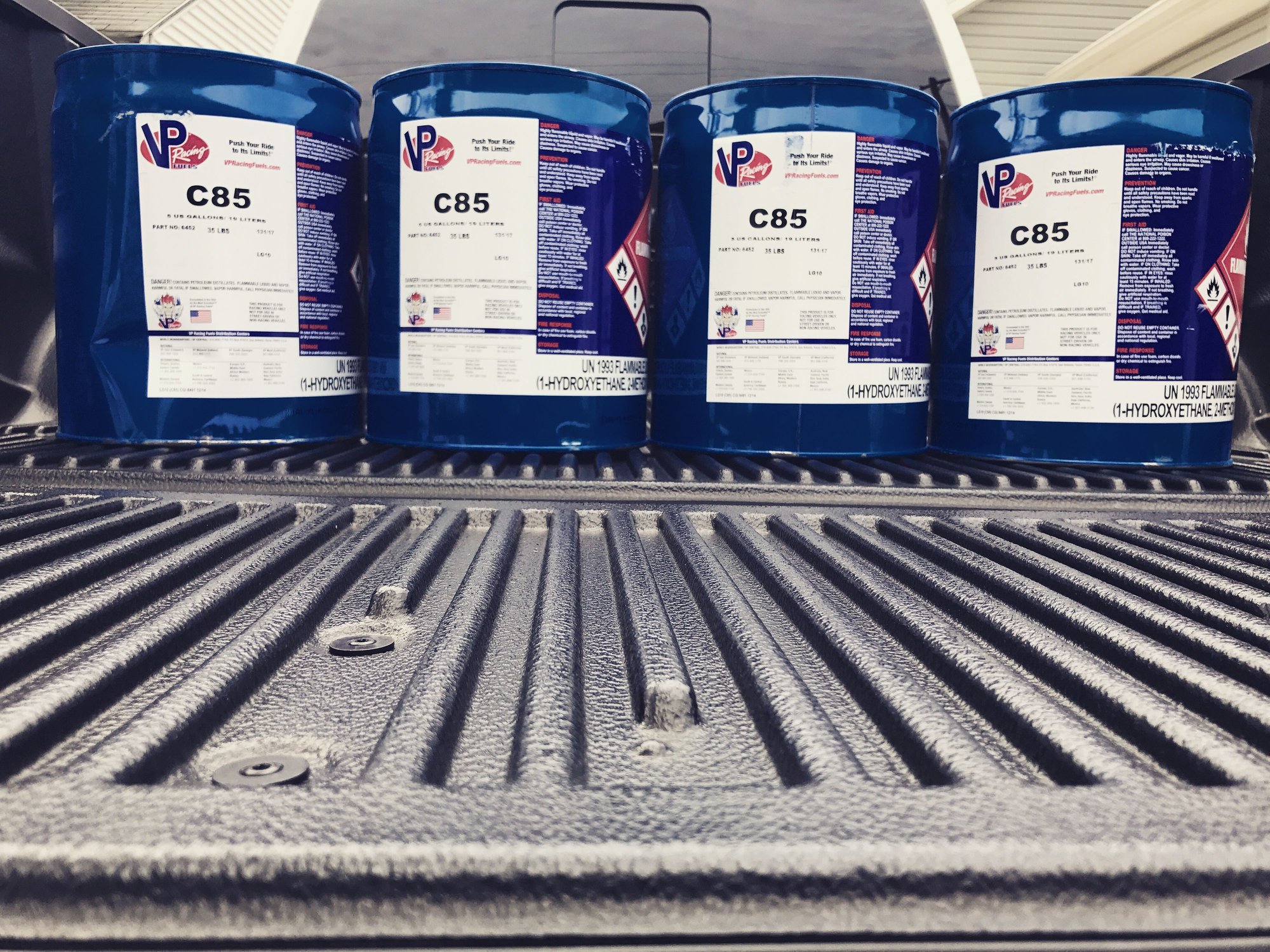

Likes: 74
From: Woodward Avenue
Just picked my order up
