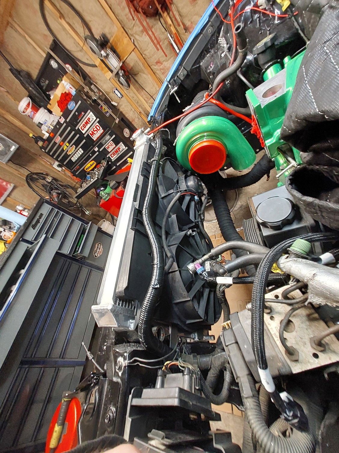

Old May 9, 2024 | 07:28 AM
cammednnbs's Avatar
Joined: Jul 2019
Posts: 201
Likes: 20
I was able to fit stock ls1 fans with only minor trimming of shroud in stock location.
