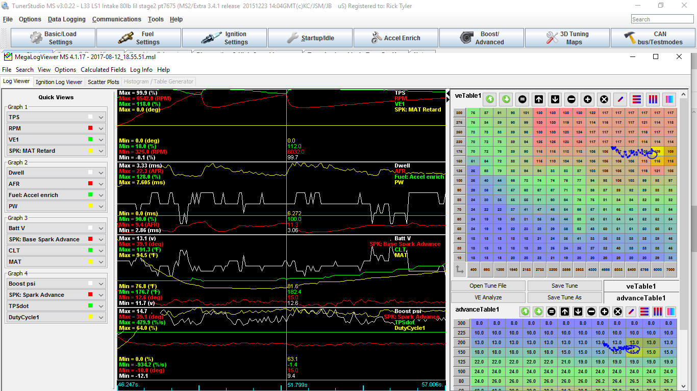

I have a 5.3 th400 with a 78/75 on3 turbo and with it set at 13 lbs it holds there during first and second gear but during third gear it drops to 9 lbs. What are things to consider for this. Other car I did with a glide held same pressure from start to finish. All help appreciated as I must be overlooking something.

As a starter>>>data logging?

What ecu, wastegate, boost controller? Where is the wastegate placed?

Microsquirt, 50mm that I have checked for problems and no leaks, turbosmart dual stage controller inside with hardlines to it. Wastegate is set on 45 angle just prior to turbo on merge to T4 flange. Also checked charge pipe for leaks and there are none there.

Will try to get datalog for you but I havent seen anything there that is wrong in my eyes

What does it do with no boost controller hooked up?

going to do that next as I think the signal is slow to recover after going that far, But what do i know lol
