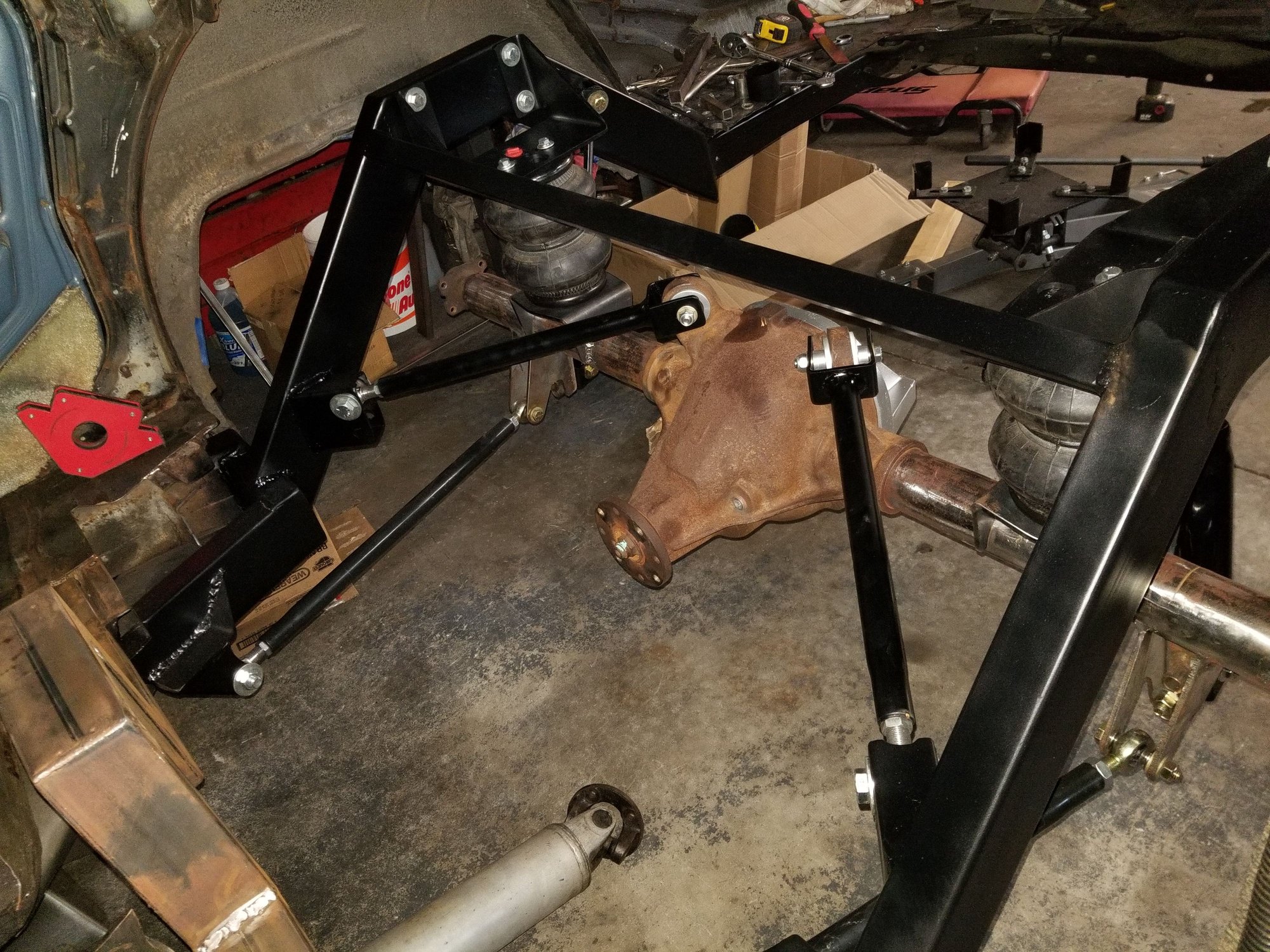

I'm doing heims on the axle, polys on the frame, I'll let you know how rides.....
