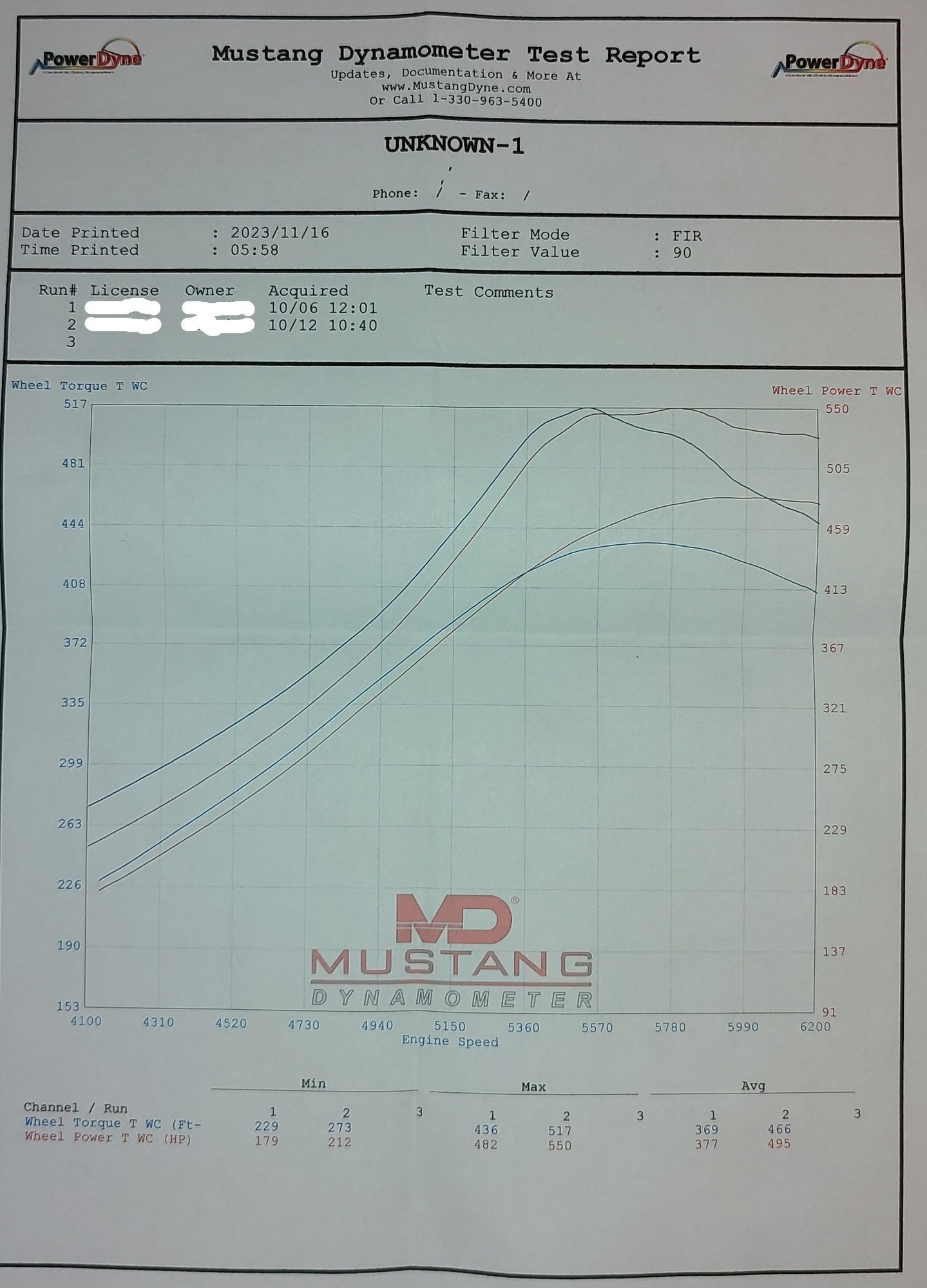

Here's my dyno. I think something is seriously fubared, even a naturally aspirated 5.3 with a good cam outta make 350 or more ftlbs at the wheels at 4000rpm. Agreed? My turbo car is making 273ftlbs. WEAK. WEAK. WEAK. So its probably the tune but maybe the cam is installed incorrectly. A shop did all this work but I'm not so bad of a mechanic myself. So if I gotta go ripping it apart to check, its worth considering a new cam. I just want whatever is best for the combo, I would say it should be *this* cam or darn close but I made this thread to see what secret sauce others might be using.

Without seeing a datalog of what is actually going on, there is no way to know if the problem is the tune or not. Slow spool and power falling off too quick on the top end could be a result of any number of mechanical or tune related issues. A log would at least give people a better idea of what direction to look in.
