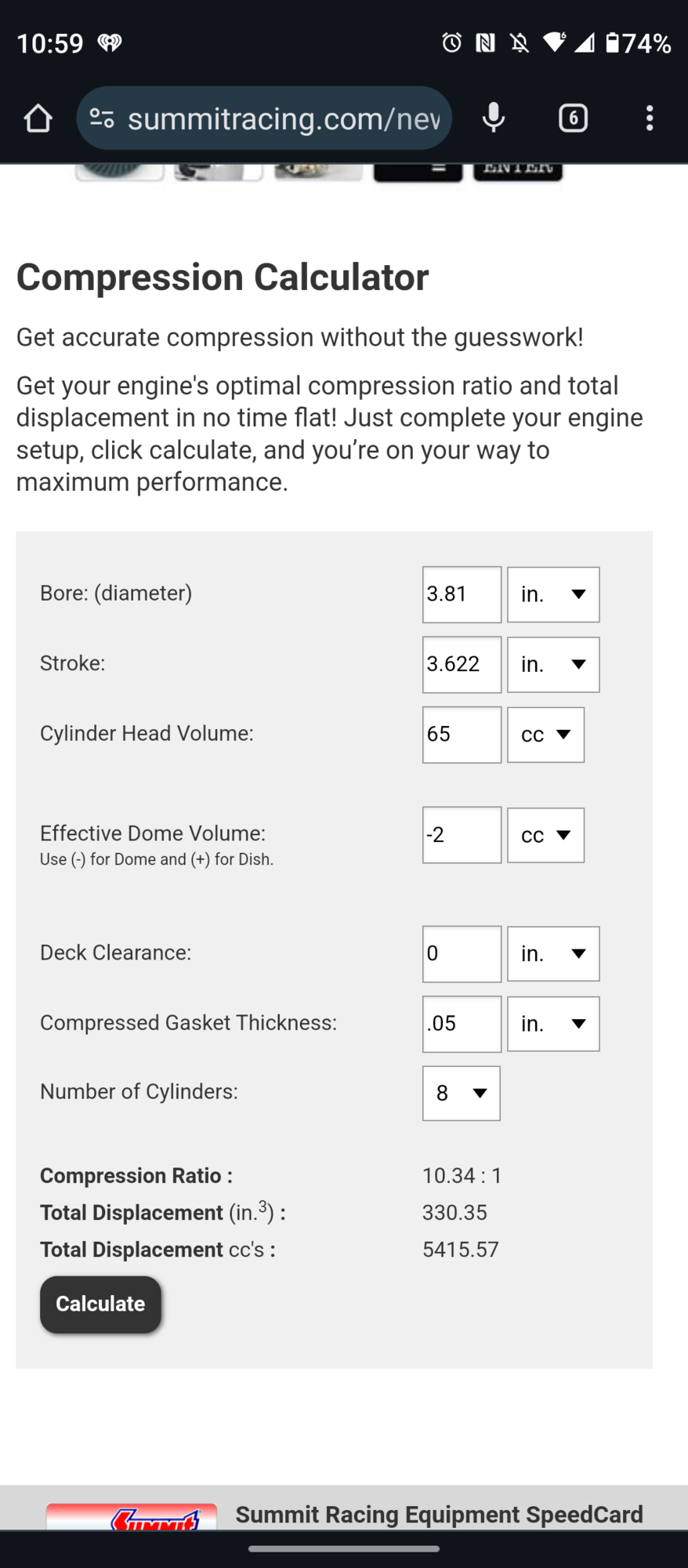

Looks like I am at 10.35-1 unless my heads have been milled significantly.

You have domed pistons as well? That sounds about right, my heads are 62CC, so that would account for the increase ( mine is 10.5:1 ). Just remember, that calculator doesn't take gasket bore diameter or ring land volume into account. You can add 1CC for ring land volume as a general rule. Getting the bore diameter of the gasket into the equation will give you a more accurate final number.
I have Summit domed pistons as well, sounds like exactly the same. I can run either 93 octane or e85 with flex sensor.
