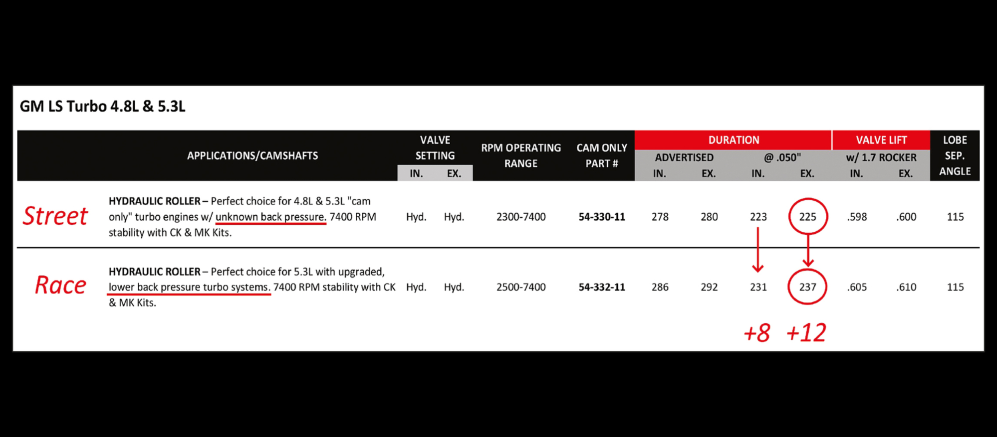

I'm reading a book on cams right now by Billy Godbold from Comp Cams. This is two of their cams. The milder one is meant for small turbines/full exhaust street turbos with higher backpressure to boost pressure. Its got -6 overlap. The bigger cam is for bumper exits and has +4 overlap. My cam is on the safe side but I think it was a pretty good choice. I also think I was on the right track with thinking up to +5 overlap (which is still pretty mild compared to a hairy NA cam) is acceptable for typical street/strip turbo setups. Godbold those would work good up to 1.5-1 backpressure/boost ratio. I still think a bit lower duration and tighter lsa within reason would be the hot ticket for response if you aren't trying for 7k+rpm. Like I said, for now I'll stick with the cam I have but if anybody finds this maybe they'll try a Truck Norris or similar with a turbo and let us know how it goes.

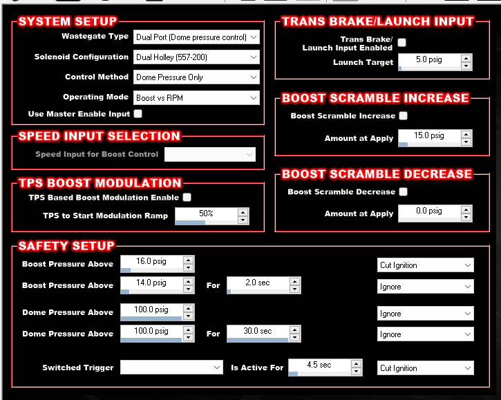

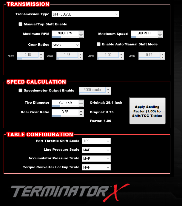

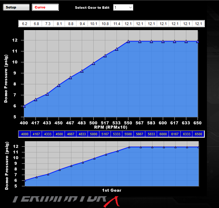

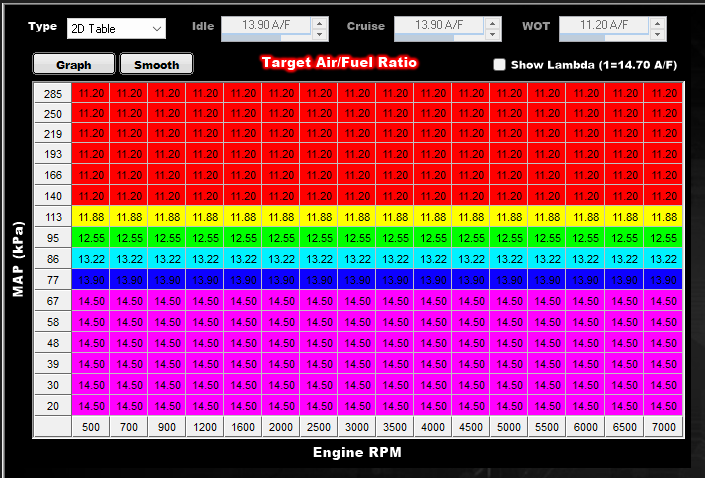

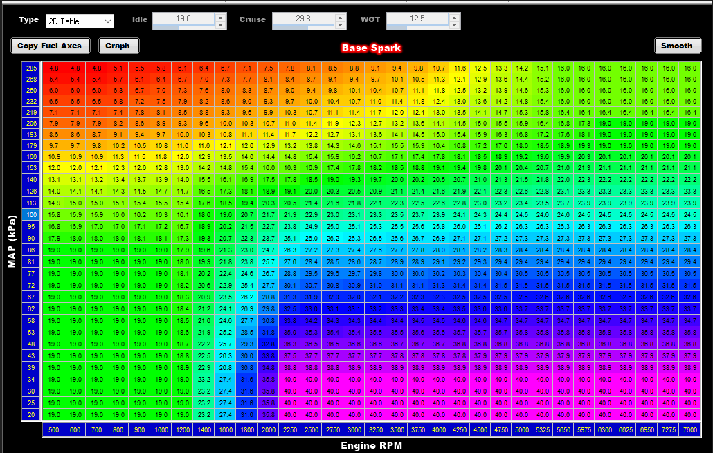

Here's some screenshots. The boost vs rpm is probably my biggest problem. Should be way more aggressive. I've been told the fuel is also too rich going 11-1 as soon as it hits 0psi. The tire height and rear gear is set wrong too. Probably not helping. Should be ~25" and 3.25.

How is your dome pressure set up?? Are you using CO2 or the compressor?? I'd turn your TPS boost modulation on. Try bringing your dome pressure rpm down to start at like 2500 and go up from there. Just play around with the settings and log some pulls to see how things react.

Could be yea or they just played things super safe. Either way I'd just start playing with things while taking logs to see how everything goes. I found the dome pressure PID settings took me some time to get the boost curve smooth without huge spikes

Tune changes can help. But only so much can be done without a proper amount of RPM. If on E85, you can run NA peak TQ timing and AFR up to around 5psi. your map is about 5* shy of optimal timing at 100kpa and prior a well. That can be as much as 30-40hp. More power = more flow, more flow = faster spool.
Most of the factory stuff peaks out at 28-29*. If you are on e85, I’d def up timing in the 81kpa thru 134kpa (id actually make that 126kpa field 134kpa). I’d start at 26* in all the fields from 113kpa to 134kpa. And 29* from 81 to 100kpa. Drop a new plug in the hottest cylinder and go do a pass and read it. Slowly bump timing up to a peak of 28* through the 113-134kpa range as long as plugs look good. Should wake up a bit
With E85 I also target 12.5AFR up to 5psi or so. I’d target 10.8 at anything over 20lbs and 11.8 at 6lbs and interpolate between the group for a progressively richer mixture with boost increase.
