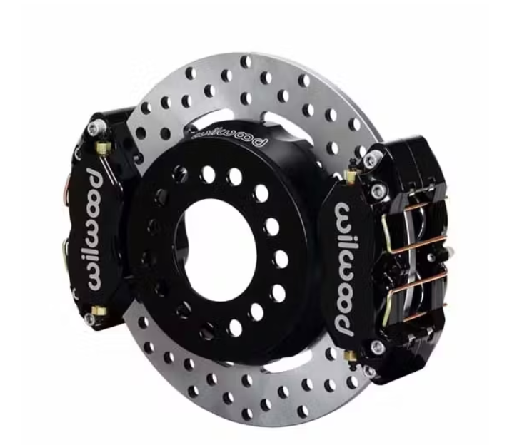

To get the best of both, guys install dual caliper disc’s on the rears. See that quite a bit on the “foot brake cars” around here.

I did modify my rear drums. Used tricks from the Buick GN guys of years past.
changed wheel cylinders, used two long shoes, and a proportioning valve to favor the rears.
The shoes are Raybestos semi metallic.
Surprisingly, it stops quite well even from near 160.
All moot now that I have a trans brake. I’ll prob add discs in the rear down the road.

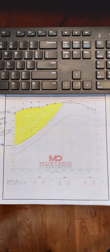

Oh heck no, its only made 550whp so far. The car is slow to spool, making NA power to well above 4k rpms with a 7875 .96ar, that ain't right. Its a boost leak, ebc settings, and/or tune. Gotta figure that out first.

Here's a comparison of horsepower, 66chevelle_02ss vs my car, two different dynos and different transmissions but 180whp difference at 4k rpm? Mine is down all that power in the yellow. Something is wrong with my car!
66chevelle_02ss ------mine
5.3 --------------------------- 5.3
VS 7875 .96ar ---------- VS 7875 .96ar
Cam 220/23x ----------- 222/227
Trick flow heads ------ cnc 243
Fast 102/92mm tb --- LS6/stock tb
T56 --------------------------- 4L80E
3.54 gears ---------------- 3.25 gears
Cast manifolds --------- cast manifolds
12psi ------------------------ 13psi
