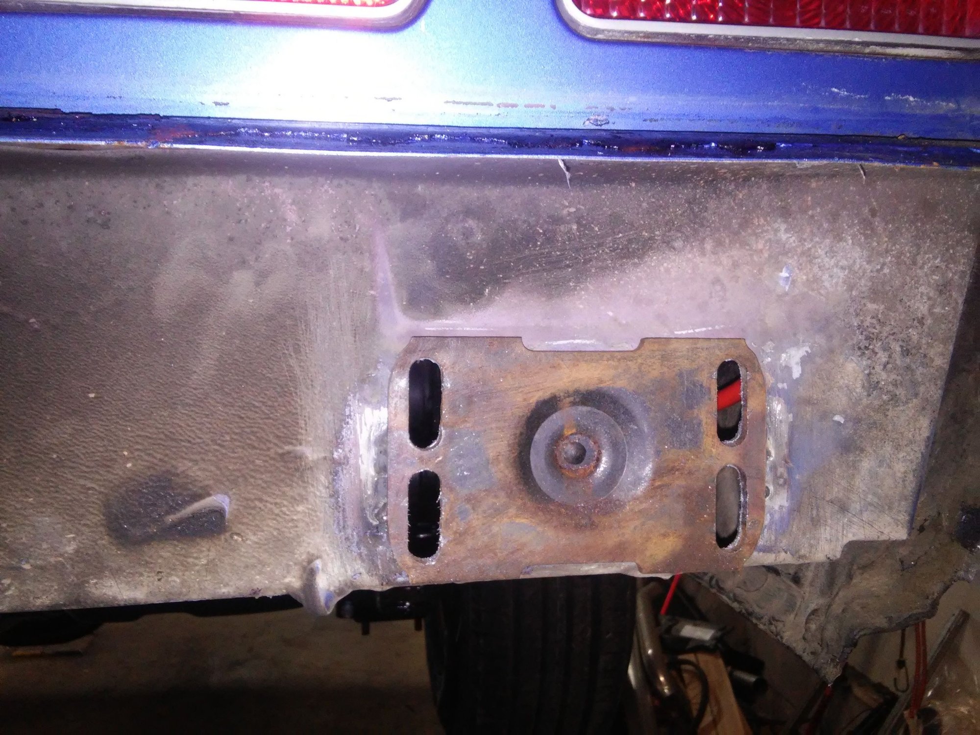

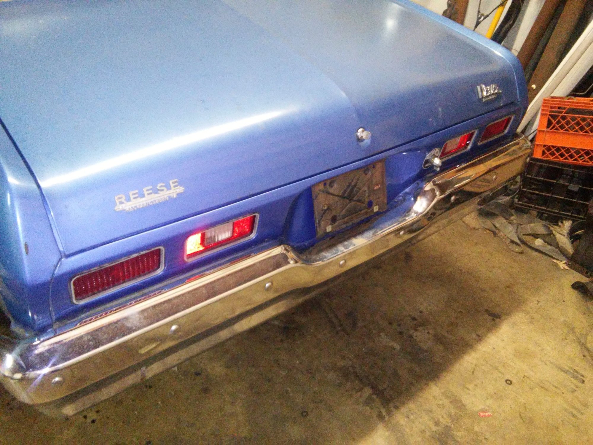

Not much going on, doing some house cleaning, since its been raining for 7 days haven't had it out. So I decided to do the
rear bumper tuck, had to give it some thought, but ended up being pretty simple. I cut the vert. adj. plate off the bumper
shock, tacked it to the body, kind of centered over the shock holes, then used the grinder to slot the holes. Then I bolted
the bumper back on. Still have the vert/hort. adjustment. The bumper and brace had a lot of weight, so I decided not to cut
any of the brace out, good place to have weight, lol. It pushed the rear 3" closer to the body. Hopefully tomorrow I go for
another drive, the new tune has it running good. A buddy gave me one of those vac. canisters for the brakes, so i'll see
if that helps-if not, hydro boost.

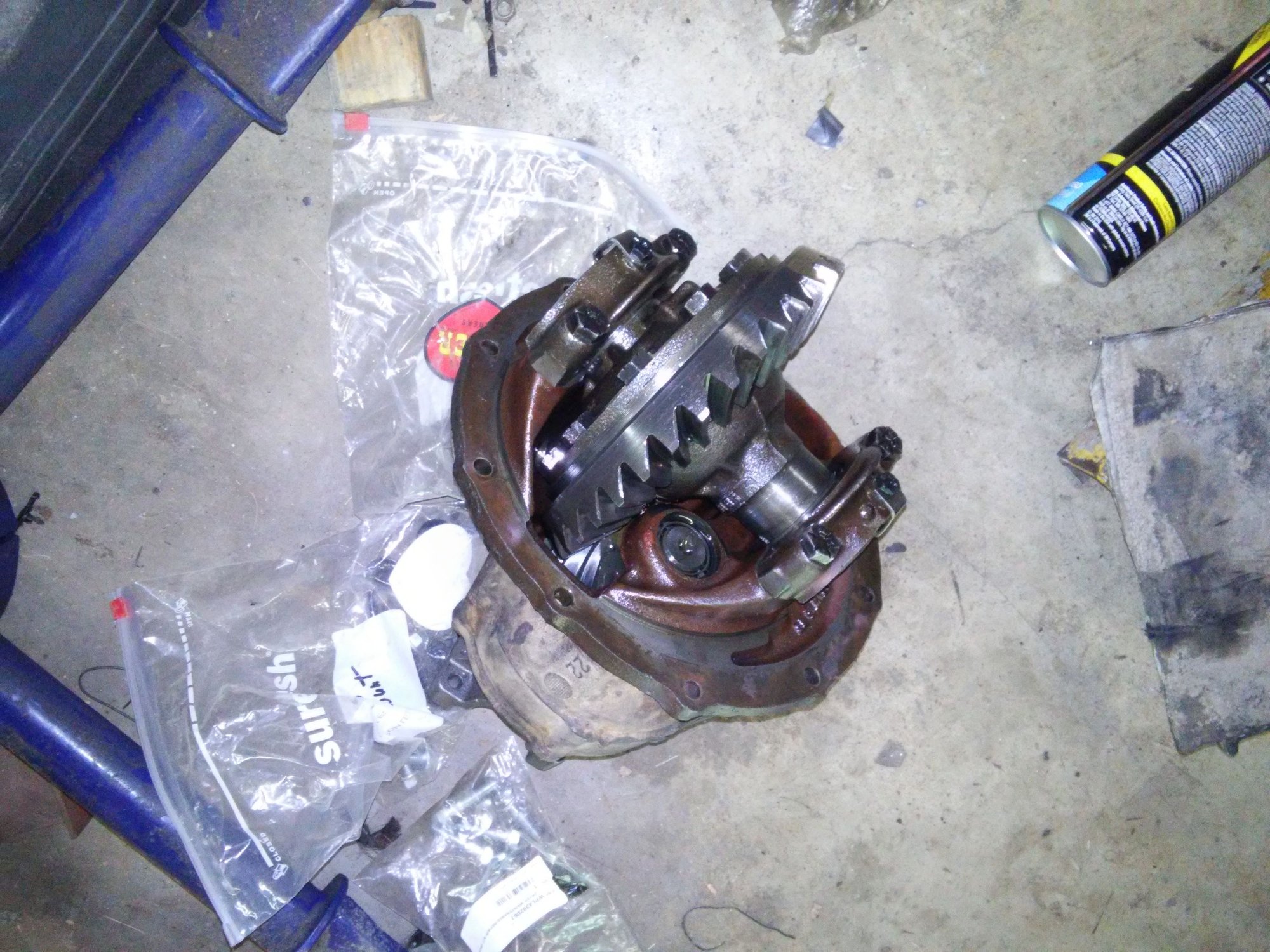

Anyway, I have been using the old rear that was in the 9" housing, it had 3.50's, and 31 splines,
just non posi and noisey. Debated ordering parts vs a comp. one, so I decided to just get
one comp. Same ratio, Quick Perf. had it to me in a few days, was in an hour after UPS dropped
it off (already had it ready) Prob keep the old one for a spare.
Going thru a couple heat/cool downs, then i'll ck for black marks, lol.

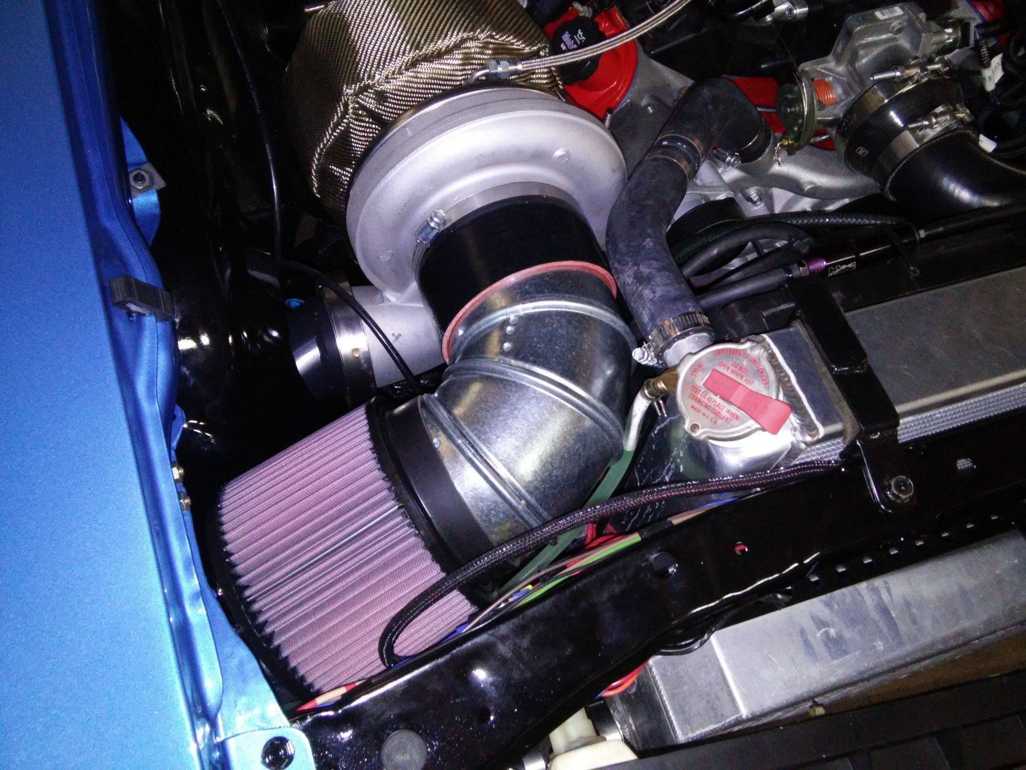

I needed a 5" 45 or 90 degree bend for the K&N air filter, found one at Ace Hardware, pretty
cool, you can swivel it to diff angles. Next up is some Caltracs.
