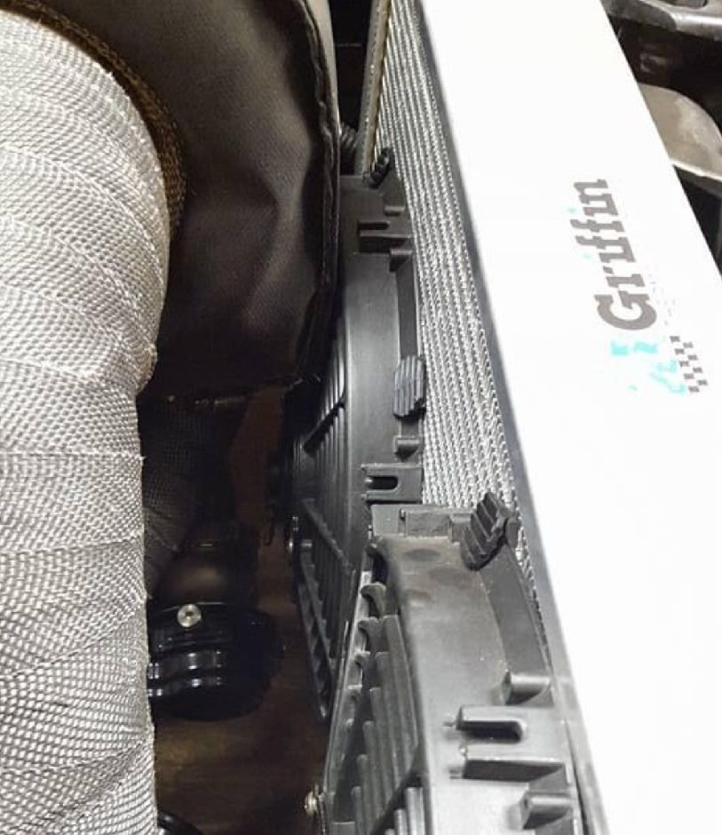

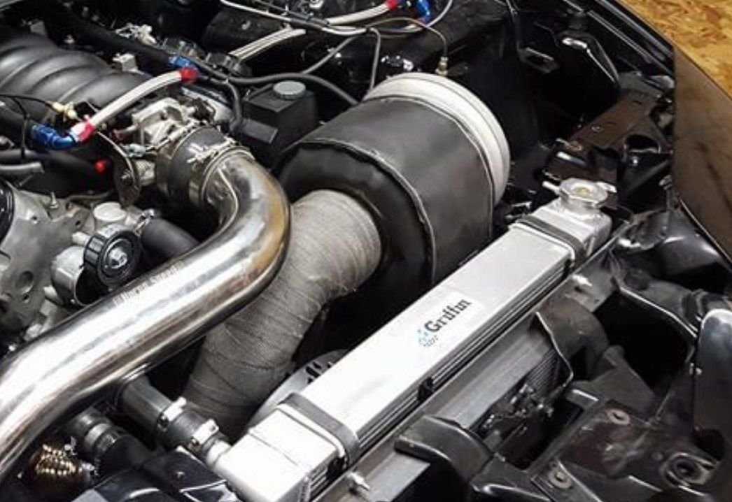

In this image below (not my car) a Griffin without the inlet and outlet on the passenger side was used. What about using a griffin 1-58241-XLS with a custom shroud similar to the one pictured below where the fan is on the BOTTOM, and maybe a smaller 7.5" instead of a 9"? (image below is a 9") The Spal Puller 30100394 is 7.5" and 500cfm and same 2" thickness as the 9" 30100452 that does 650 cfm. Hard to say, even with a 7.5" mounted on the bottom might not give enough clearance. Basically I took the image from MM site and relocated the fan to the bottom, but a 7.5" gives even more room but not sure if it will be enough room. This is just something that has to be mocked up I think because it's hard to tell if it will clear or not.
These images below were taken from evilz99's thread showing a S485 setup with a Huron V3 T6 kit.

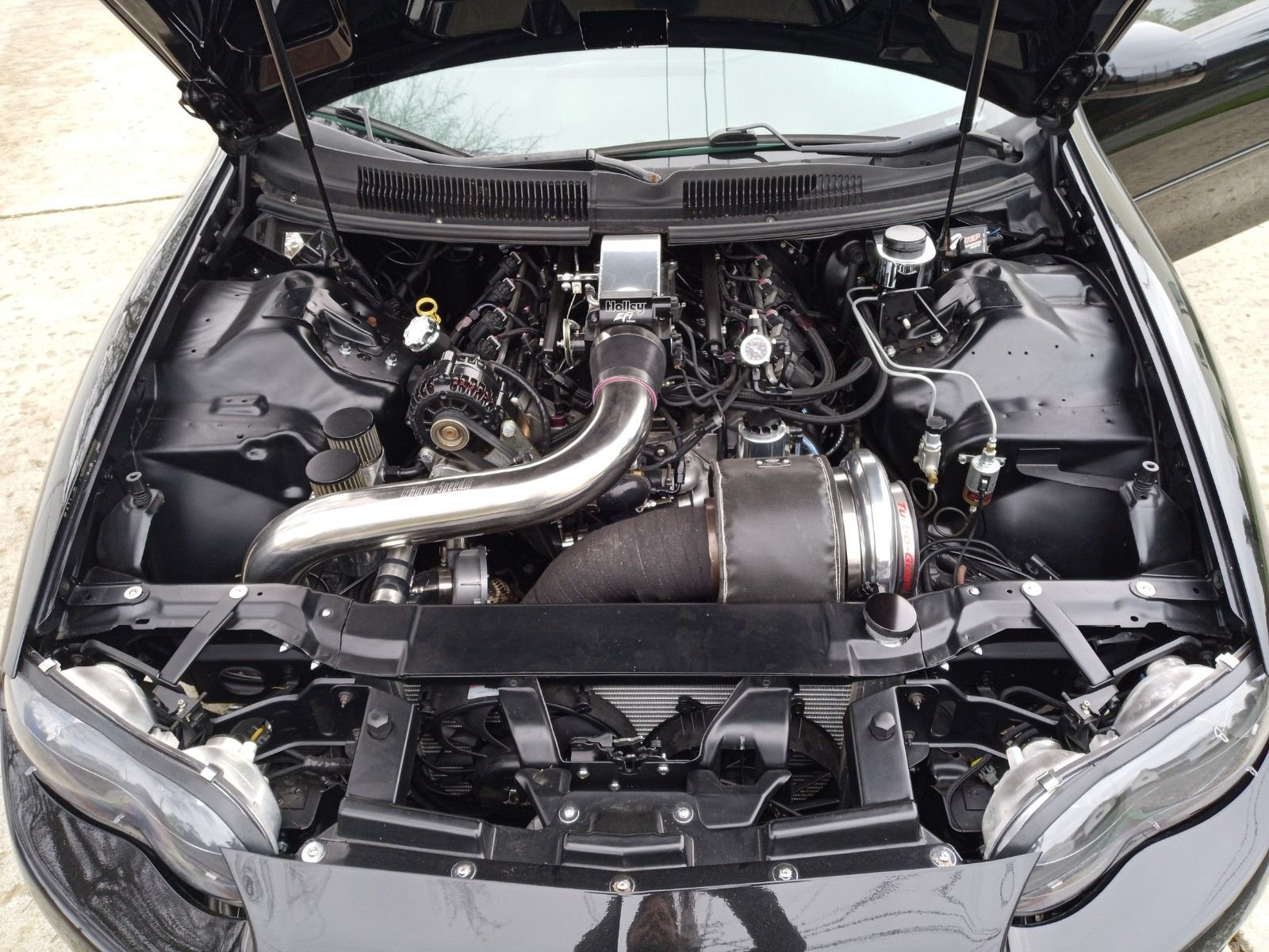

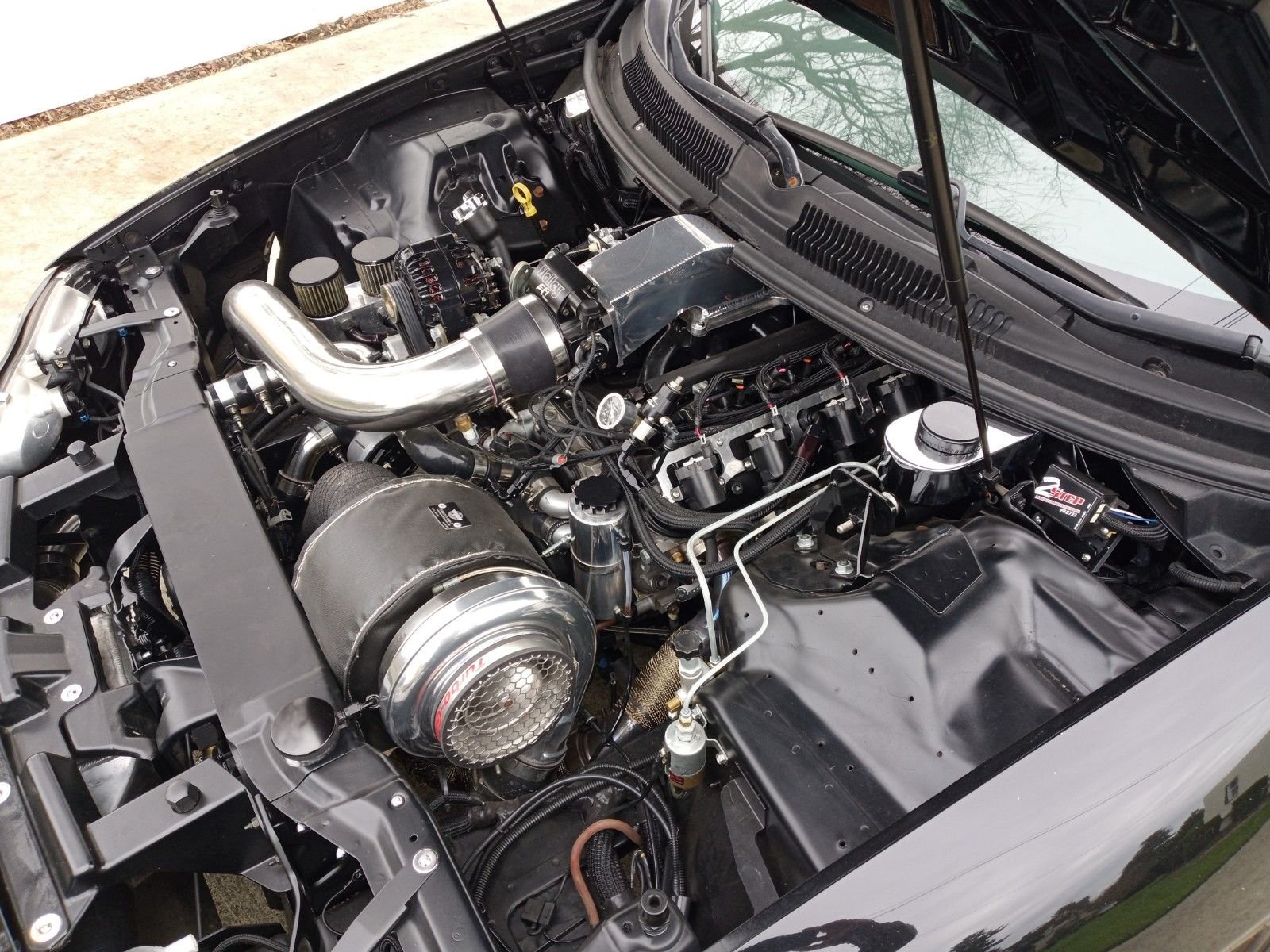

Huron V3 T6 kit here as well.
My car has both radiator ports on the passenger side and the radiator is flush mounted with the core support and there is no room between the turbo w/ blanket and the radiator.
In fact, I had to add a small piece of sheet metal to the radiator core to protect the radiator core because the turbo blanket rubbed a hole in the core.
You would definitely have to move the radiator farther into the nose of the car to accommodate puller fans.
As you can see, I'm running dual pusher fans currently.

Also what alternator relocation bracket did you go with? Looks like the rad will need to be moved up this much to clear based on these other pics I found. These ones are spal IX-30100400.

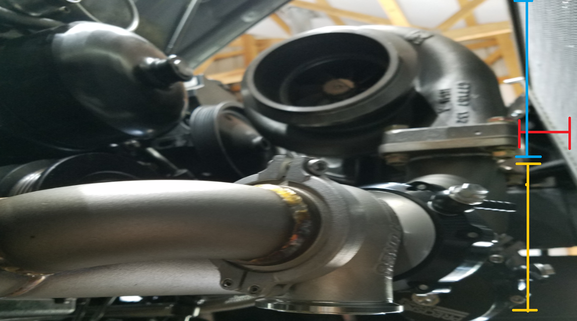

Turbo is on the driver side in a huron V3 kit so the area of concern is going to be the distance in red and the distance in orange and if the smaller 7.5" spal puller fan or even a 9" has the needed clearance in that area. I would think that the larger 16" fan on the pass side would be OK. Going to have to mock it all up with cardboard and if it's a no go, then probably just cut the rad support and push it forward. That should still leave enough room for the trans cooler, vinage air condenser and the 6" intercooler. Those items may also still fit using pushers but I would think that the air flow would be blocked. I have a burkhart front bumper support. Undecided on fully cutting it all up and using the RSM front end kit just yet. Going to open up the front bumper as much as possible for air flow. Power steering will be replaced by volvo electronic setup. Alternator relocated like you have done and maybe use an electric compressor with the vintage air mini setup to keep AC unless a sanden air compressor can go where your alt is at and not interfear with the BOV's and the alt mounted top driver side. Can't mount the alt in factory location because I'm going to use a 5" to 4" downpipe through the BMR turbo K-member with a cutoff to retain full exhaust and keep the center mount look. If it robs too much power, I got a full 5" downpipe ready to go and will just cut the bumper. The weight savings would be nice in that case. Rad in back or trucool in back with fans is another option but would prefer to keep it all upfront if temps are reasonable.

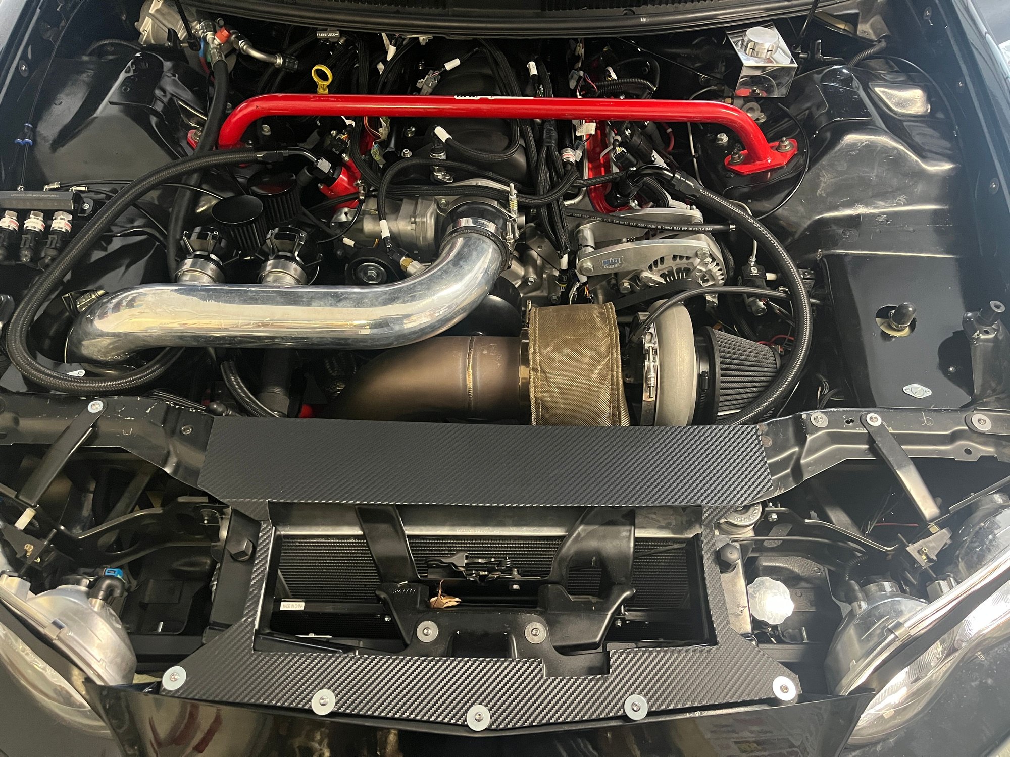

I wound up going with 2017 chevy 12” volt brushless pwm puller fans. I had to cut the bottom stock rad support and have a new one fabricated so that the griffin rad could be lowered and pushed forward, right up to the hood latch support. This gave the needed clearance for the S488 turbo with compact race cover to fit. Pics are in post #5 here: https://ls1tech.com/forums/forced-in...-220-pics.html
In the spring I’ll have a custom shroud made for these fans where the fans are built into the shroud to save another inch or so on clearance.
