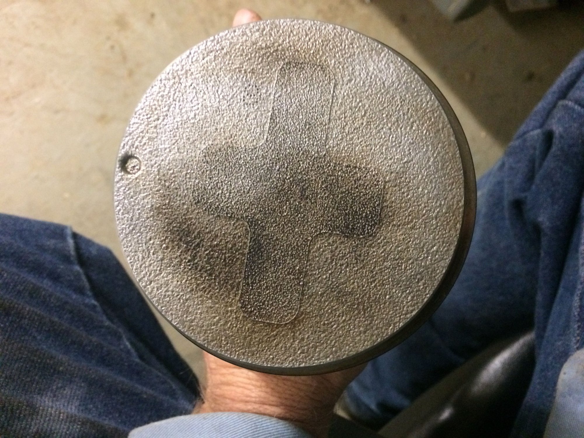

I turned up the boost on twin turbo l33 and bent number 7 rod and scuffed up the piston pin boss area also. I was looking for one or some stock gm l33 pistons to get it back together.After two hours of reading and looking i'm still not seeing want i want and am more confused as to what they actually are. Mine are completely flat on top with the big cross or plus sign in them. All the ones I found that advertise for l33 have the cross on them but are dished. Any help or info is greatly appreciated. Thanks Mark

Yours should be flat top. The dished are lm7 5.3 pistons.

Correct, but where to get them ? Most all listings for l33 pistons are actually lm7 pistons. I was looking for a stock replacement, yes mine are flat tops. Thanks mark

They are standard 4.8L pistons for a floating rod application.

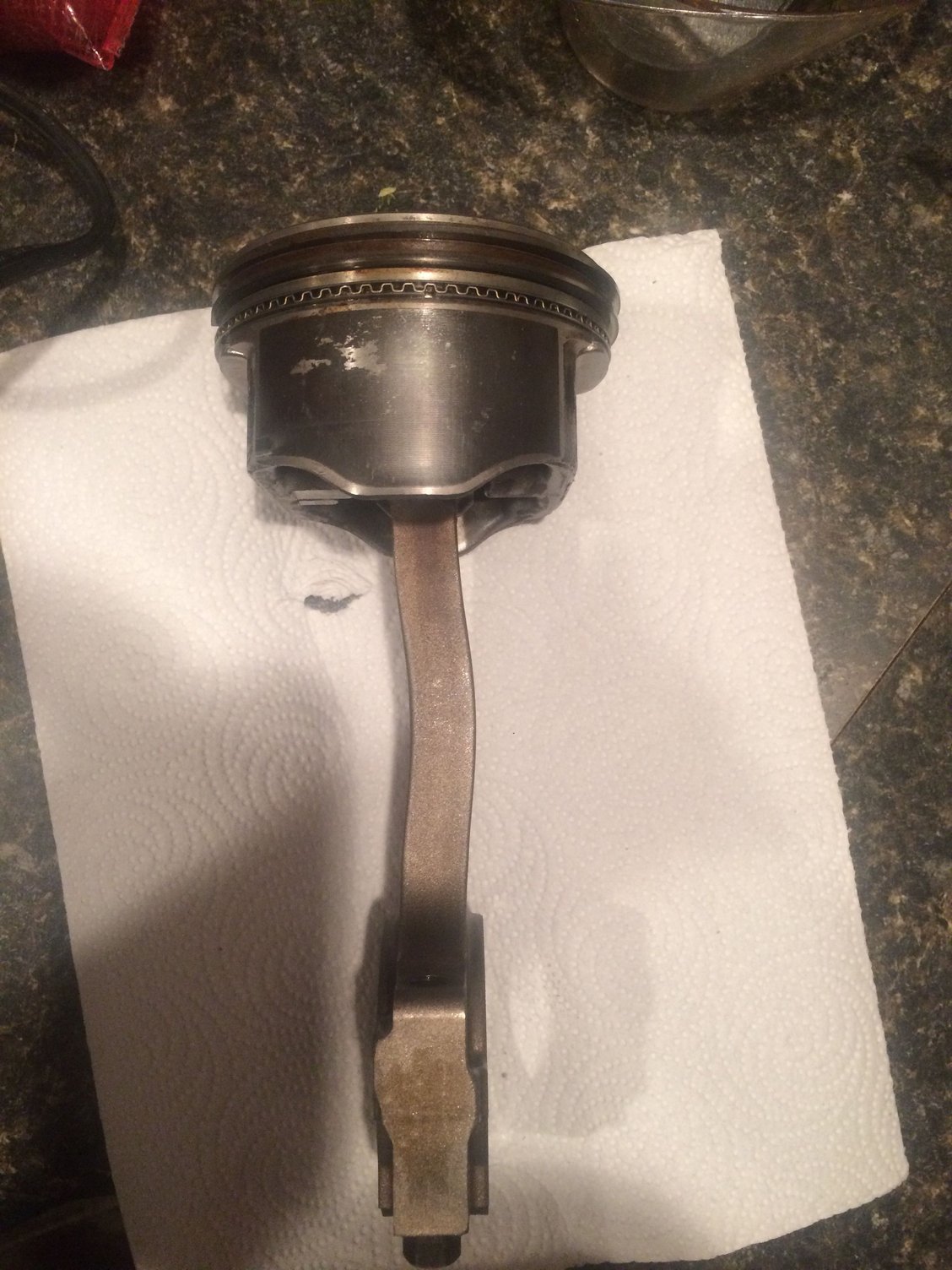

I should have some, send me a pic of yours to verify they're the same
will do just as soon as I can, thanks
