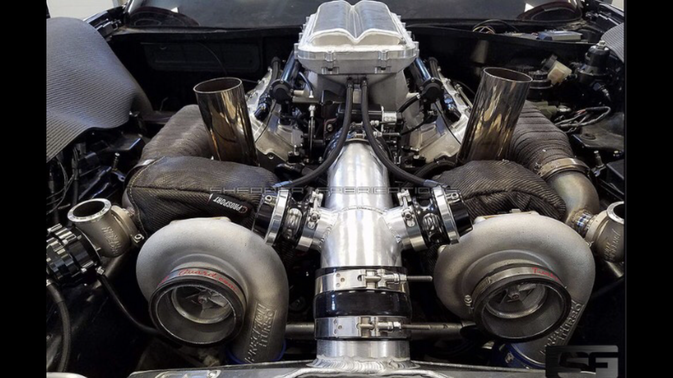

Thank you. Its a Gen 4 aluminum 5.3 with stock rods, pistons, and crank. The journals have been polished and king bearings installed. Rings opened up to 0.026 top and 0.028 on second. 1/2" studs and DBRods cutter gaskets. Studs where done in preparation when we build the motor later down the road if necessary. 243 heads with BTR springs, trunion kit, pushrods, and stage 2 twin turbo cam. Turbo is S484 with 1.58AR and built 4L80E with PTC converter. Holley Dominator ECU.

Thanks for the info. Ill have a forged bottom end now so rpm shouldn't be an issue. My limiting factor may be the lifters, but they are Johnson 2116lsr so I think I am safe to 8k. 3/8th Manton heat treated stage 5 pushrods are good to go as well. Cam is pretty tame and not really aggressive on the lobe so it shouldn't cause any valve bouncing or floating.
My issue is space. The Hi Ram is going to create some work in getting it to fit. Ill no doubt have to run the TB into the firewall because the snout on the intake sticks out too far to run it towards the front, I have no room to get my cold pipes hooked up. And Ill most likely have to cut the hood open. Im trying to keep the body stock appearing.

As Z says, this covers some of the height and forward room aspects.
http://shearerfabrications.com/sf06-05001.html
Must admit it would be nice as a fully fabricated piece, but starting with a cast unit does make a lot of sense too.
I did kind of ask in that G1Pro thread if the guy could make something like it and maybe an inch or so lower but he never did respond.
But Shearers is lower and shorter than a regular HiRam, and also looks shorter than even a stock intake TB position.
Very tempted by that myself, but still need to see if it would fit, height would be touch and go for me.
