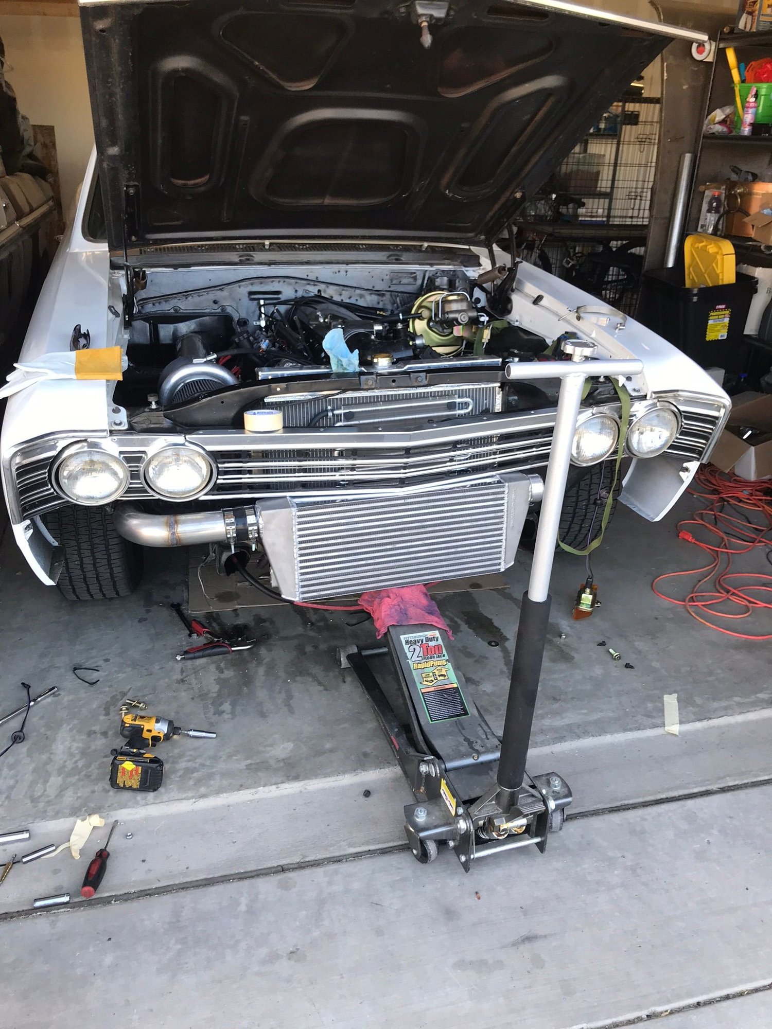

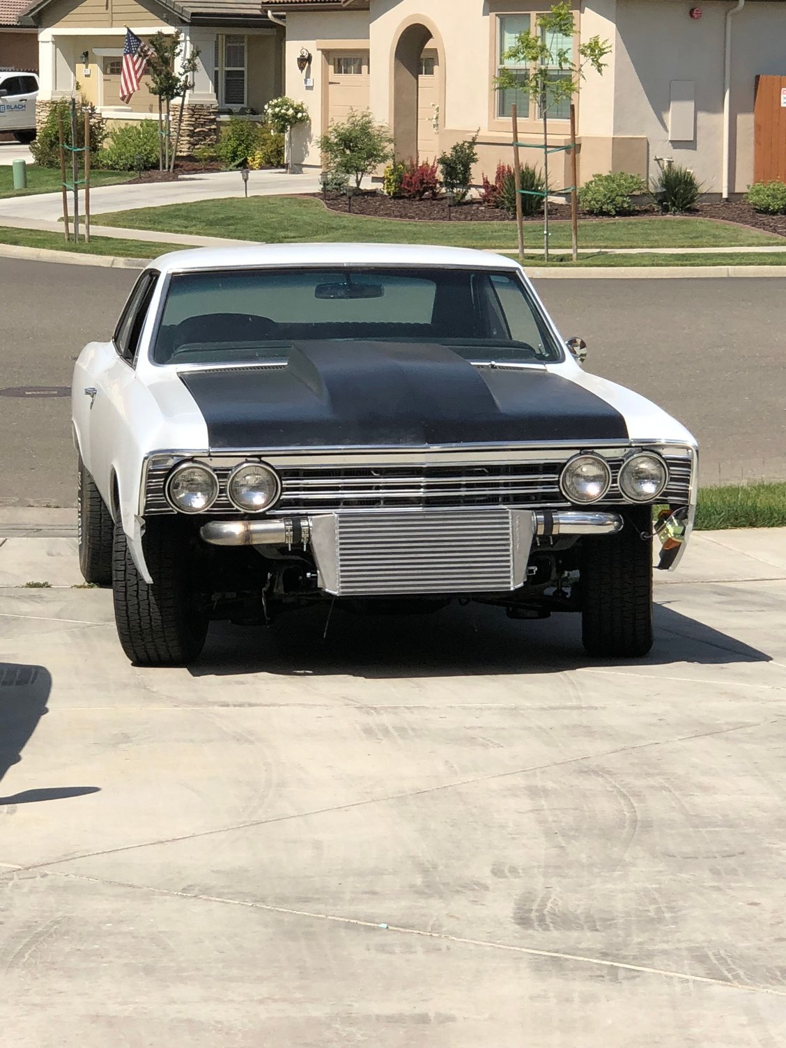

Ended up going with the Treadstone TR1045 (10” tall 4.5” deep)
