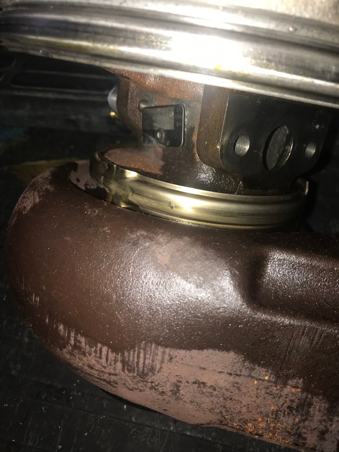

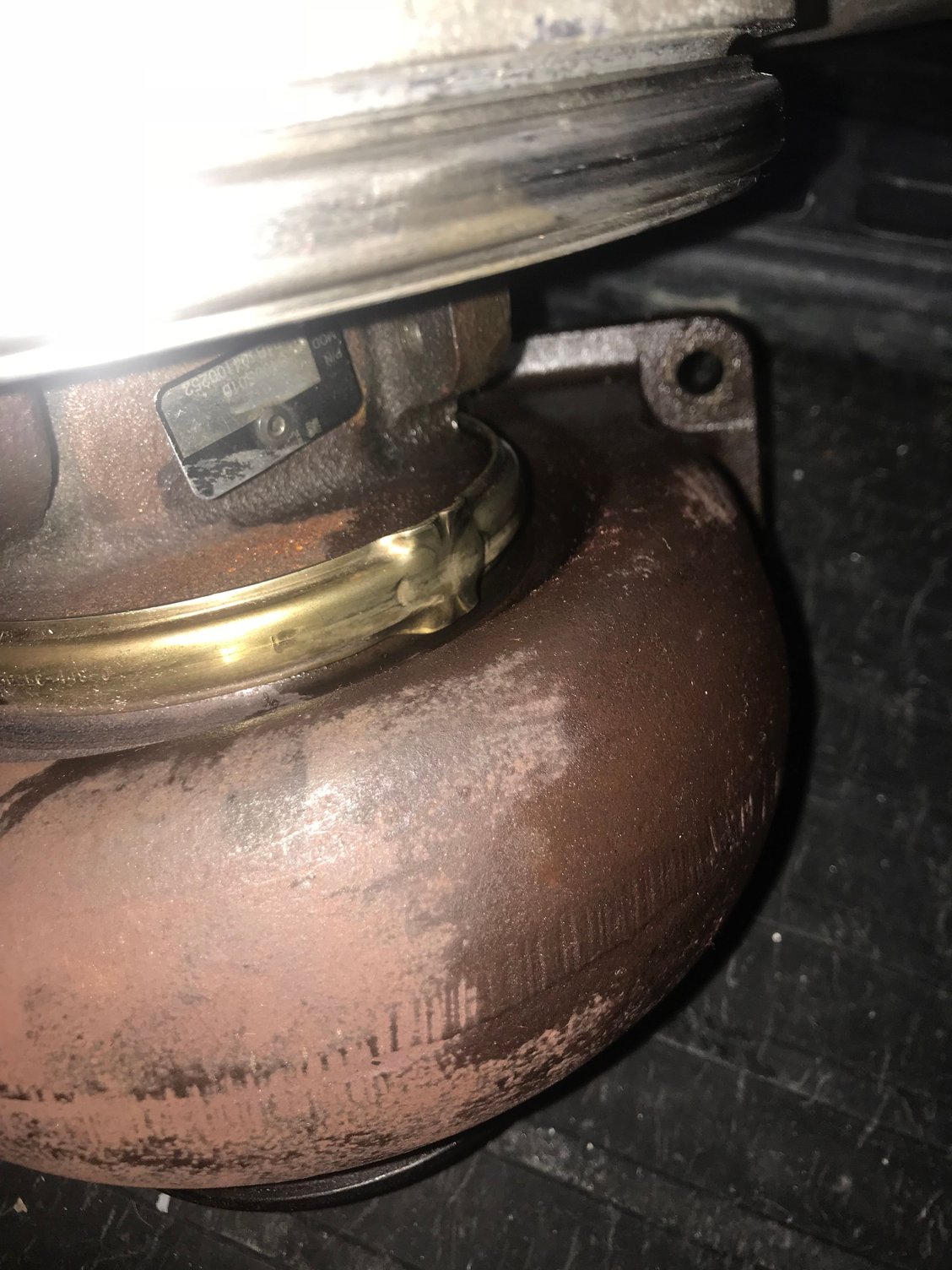

My set up is a Huron Speed t4 kit and a Borg s480 on a 408 stroker. After the winter I moved my car and noticed an oil puddle under the turbo. Took the turbo blanket off and it was soaked so I’m assuming it’s leaked for some time. The car smoked so I added a scavenger pump which corrected that problem. The motor has a high volume oil pump so I see higher than stock oil pressure. Fast forward to now I took the turbo off and rebuilt it. Installed and let the car run plus put a couple no boost miles on it and all seemed well. No leaks no smoking. Yesterday I took the car out and did two pulls into boost on the second pull the car was smoking from the turbo area, so I took it home and let it sit. Today I look and a puddle of oil is sitting under the turbo and my exhaust wrap has oil on it.
Any suggestions? I’m at a bit of a loss here as I figured the rebuild fixed my issues. Attached are some turbo picture before the rebuild.

I should mention the feed is -4 no restrictor and drain is -10 to the turbowerx pump and -10 to the pan from pump. Also I am running a vented catch can -10 from the rear of the drivers valve cover and -10 from the oil fill to the catch can.

Not trying to be a smart aleck, but did you put the oil soaked blanket back on the turbo? If not, pull the car out of the enclosed area...completely clean the turbo, start it and stand there watching it to see where the oil is coming from. If it doesn't leak then, have someone put a load on it as you are looking at it.

Another couple of questions, are you using a gasket on your drain? And is the drain above the oil level in the pan?

Yes gaskets are used on the drain and feed lines. I am pulling the drain line off the pan tonight to be 100% certain but I am pretty sure my oil level is below the drain. I placed the drain where a lot of others have and Huron recommends and am running 6qts of oil which I know others do as well.

Except as the video alludes...there are NO oil seals in a turbo.
Oil control is simply via having a drain that will always expel more oil than is being supplied, and oil will be directed away from the compressor and turbine sections via the oil slingers and oil path in general.
The piston ring seals are to prevent pressure from the compressor and turbine entering the oil section. not in any way to prevent oil passing into the compressor or turbine section.

Oil journal turbos want a lot of oil, it would be rare to need to restrict them.
Sort the oil drain and allow the turbo to work as it is designed.
