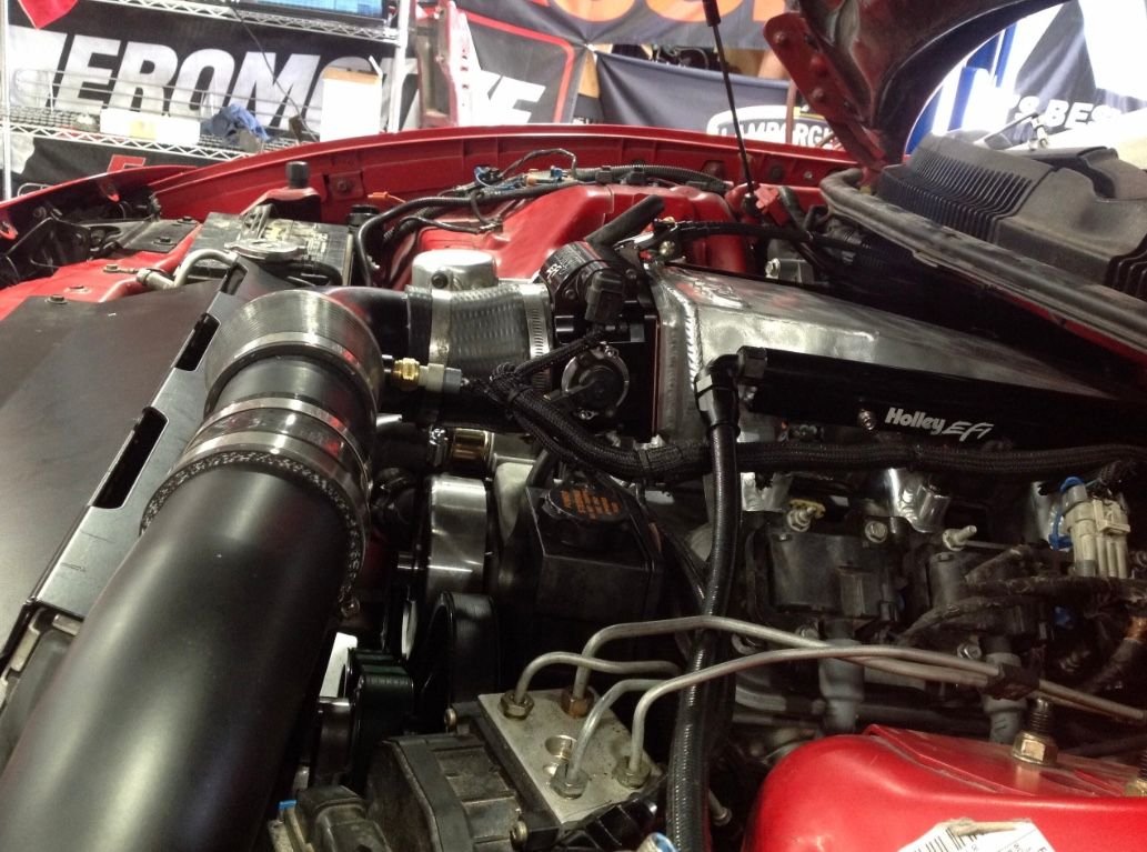

Awesome build. Good call swapping the worm gear clamps up front.

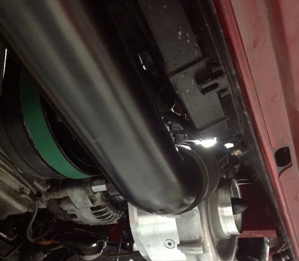

I popped the charge pipe off two different times @ 17psi doing highway pulls on one of my builds. The second time was during a random run, which was super embarrassing and pissed me off. Ordered a cheapo amazon t-clamp that same day and it never popped again.

Most worm clamps are such garbage. So many of those worm clamps use a cheap garbage screw, even when they are supposedly "stainless", and end up getting rusty and cruddy over time. I used to use worm clamps on my pressure tester kit for welding up I/C pipes until I almost broke my shop radio from the end cap blowing off, now I don't even use them for that. Not saying it can't be done with the right bead or lip on the pipe, but why bother when T bolts aren't that expensive and provide at least twice as much surface area of clamping force.

If you choose **** worm drives, then you're as likely to buy **** t-bolts.
Again the only fault there lies with the user for choosing **** or doing poor work. And you do not need huge clamping force, that's exactly how idiots damage pipes then still blow pipes off and then still blame the clamps !

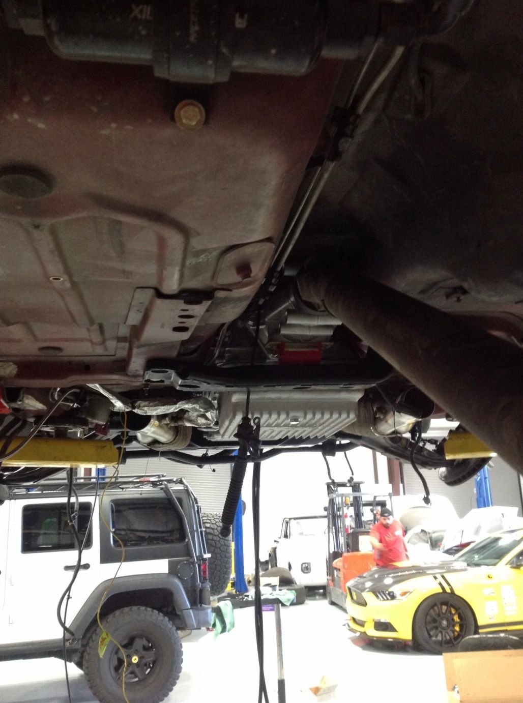

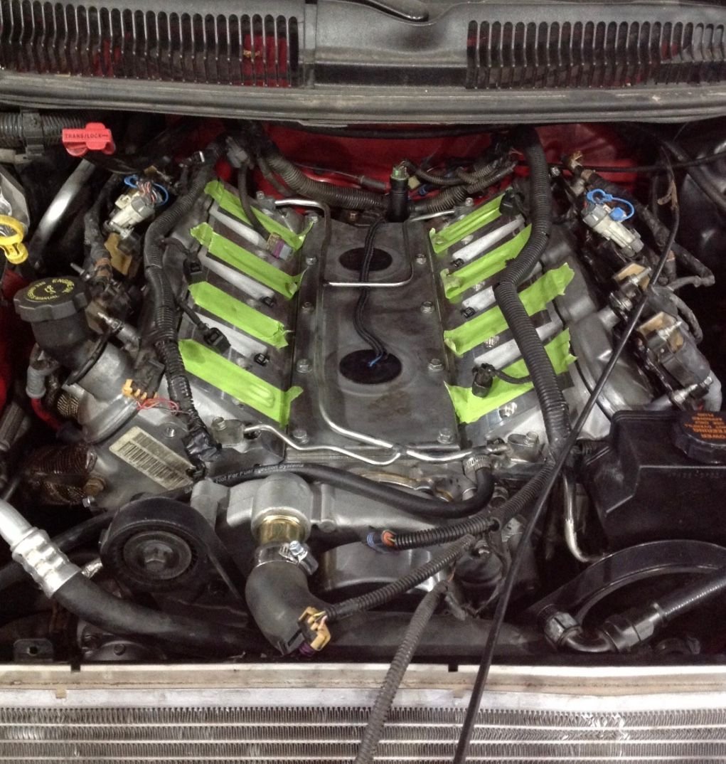

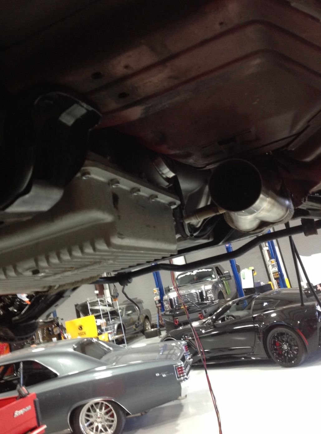

Motor installed along with all wiring and harnesses. Measured for the new custom drive shaft
