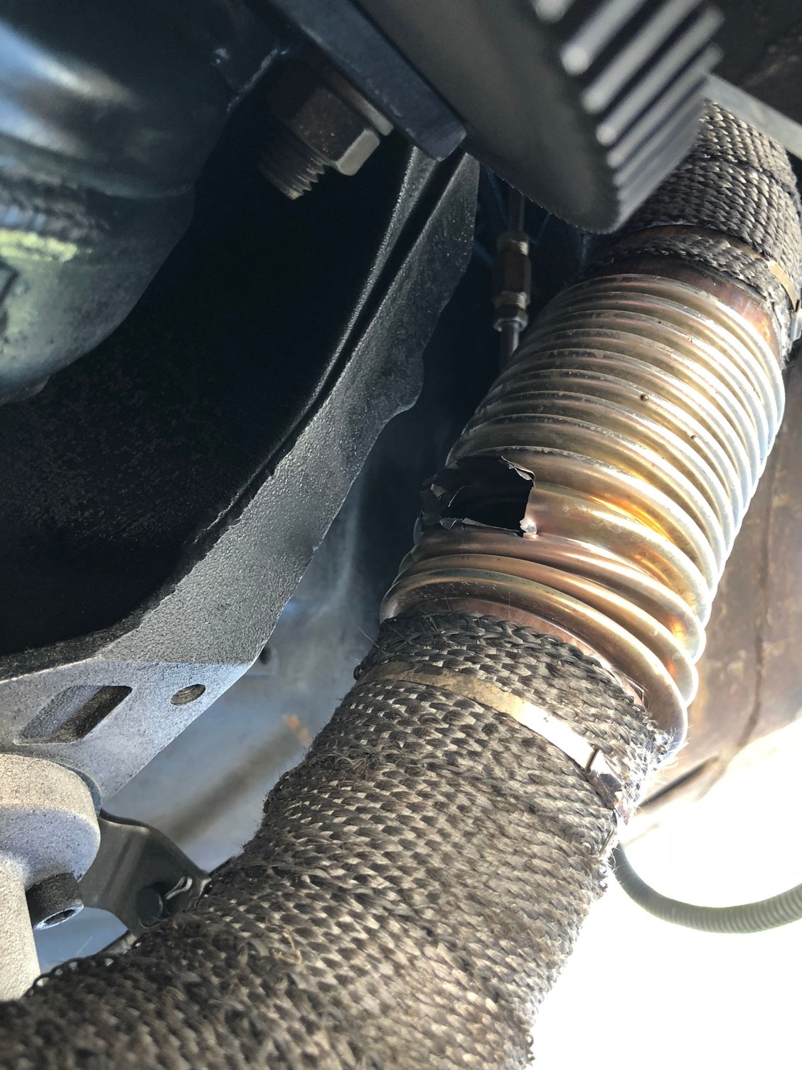

this is probably not normal
This is the cross over pipe from the Holley turbo LS kit. Little bummed out this thing hasn’t lasted more than 4 months of the engine running. Trying to hunt down down tuning issues/ possible electrical issues and discovered this. That hole is about the size of a nickel. Could be the source of the lag I was having with my turbo.

Flex pipe will almost never work for any boost. The only reason I say "almost" is because there may be some type I am unaware of.

If the engine/manifolds is supporting the weight of the turbo, a flex is a bad idea. If this is a crossover between driver side and passenger side, there is no reason to add a flex.

I have never had any luck with that style bellows... I had a 50 dollar vibrant one that started cracking after dyno tune.... cut it off and put a straight piece in....

that was my thought as well.. but this part of the hooker turbo manifold setup. They are sending me a replacement... we shall see how long it’ll last.

I've had this style flex in my huronspeed kit for 3 years its held up fine so far...

damn looks like something came out of there

vibrant bellows failure... seems like it got hot then split
