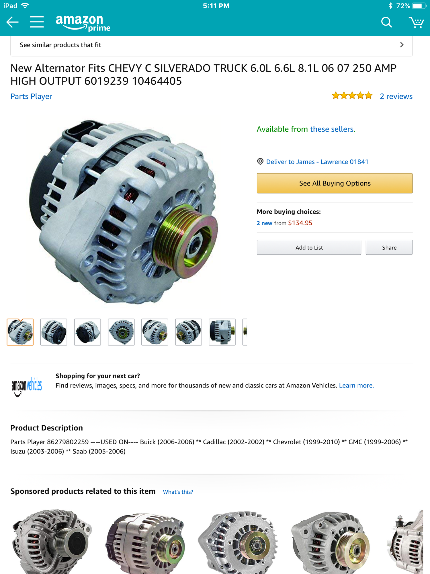

I got a 250 amp off of Amazon for cheap ($125?) it’s lasted 2years so far
Old Aug 21, 2018 | 04:15 PM
jimmyg's Avatar
Joined: Jun 2014
Posts: 1,533
Likes: 12
Like this
thanks, as luck would have it a family friend actually builds custom alternators. I just came upon this information & he is making me a 200 amp AD244 case unit as we speak. Should have it in the car by next week.
