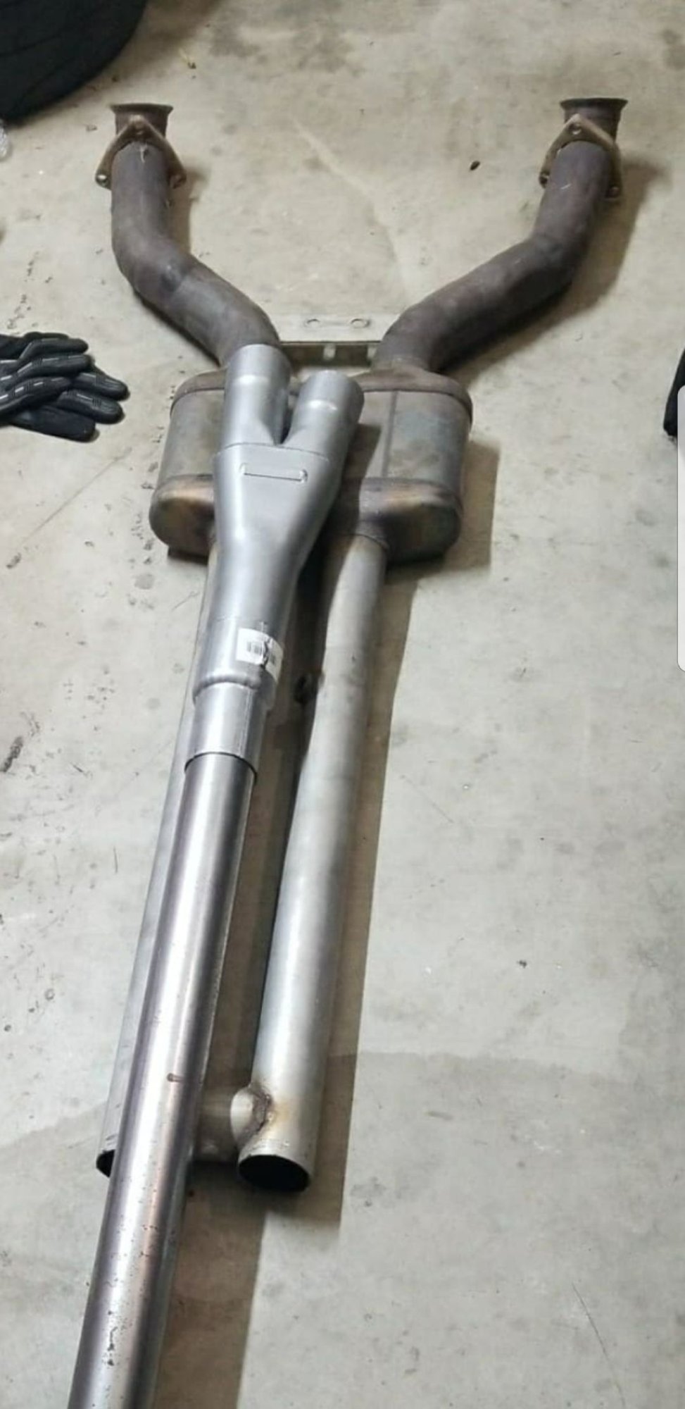

Oh yea,
I've got full plan my c5z, are wrapped. Gonna full wrap to the turbo. 2.5 off each manifold to a mufflex style 3in y then taper back down to 2.5 to the turbo. Then 2.5 from the turbo strait tinthe tb. Small nozzle #2 pre turbo and maybe #5 1-2ft from the tb. Ive got a full plan. Maybe ill throw it in the guys face in that post above that said I wont be happy!!
I'm copying danzglass and turboffr builds with a little change, both those cars make over 800, one is a 5.3 on is a 6.2. I laugh at people that say it won't work, hahahaha, most people do not size the piping and the turbo right. The people that have success love their setups. Only thing diff is I wanna try it with out a cooler. Im not worried just need to complete it. Sunday I put the custom gearing tr6060 in and a c6z diff to match. Need to put in the rear suspension and going rear coilovers.

I think going to a 3" Y is a mistake. It'll kill velocity as well as likely drop the exhaust temperature.
The plan
the two guys I know that make over 800 both run 3" hot and cold rear turbos.

Nobody's saying it won't work period, it just won't work as well. You really should dig up that thread I mentioned earlier. He had a TON of data and back to back testing.
