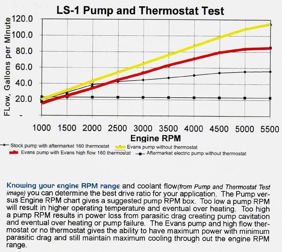

pretty sure those pump outputs are freeflow and not under pressure. If your overheating above 35-40mph then it’s not fan related and it’s airflow. This is of course if the rest of the system is sized accordingly. Fans are the same way, most inflate Cfm numbers with no static pressure, only spal posts that info.
Heres a good pic of a aftermarket electric pump with no Tstat, stock pump with Tstat and a Evans high flow pump and high flow Tstat. This is specific to the LS platform so it’s good info. A high flow stock style mechanical pump will outflow a 55gpm electric pump at pressure. Maximize your coolant flow, get good airflow and you should be good.
forgot the pic!
