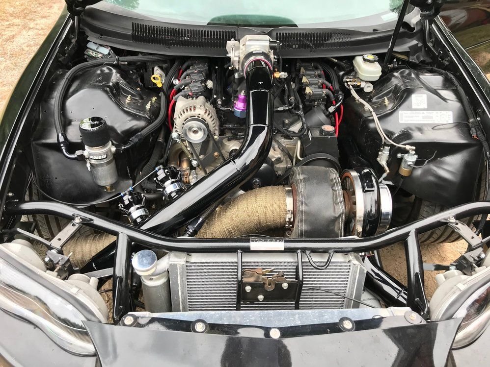

This set up is almost identical with my car same radiator but my electric pump was the 35gpm and his is a 55gpm and also he still is running the heater hoses. I am thinking may be moving to fast but not 100% sure. Hoping the t stat helps as it’s a bit strange I’ll make an air damn.but my car never had one and it never got above 195 (water and water wetter mix)
here are both set ups

His Set up LS2 Garrett 88mm Meziere 55gpm wp with heater hoses no stat Coolant water mix 205ish hot idle cruising will not go lower.....

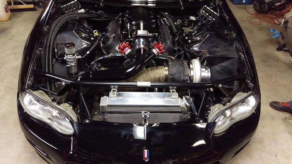

My set up
dart 427 76mm
meziere wp 35gpm
water with water wetter mix no stat never got above 195idle or cruising, most of the time was in the 175-180ramge
no heater hoses on my set up
im thinking/hoping it's moving to fast as the set ups gave identical fans radiators and all around similar set ups I've done.
it was working decent with the stock pump idle around 210 cruise was about the same maybe around 200 but with the luck I had I guess we go at greedy.......I think we will try the stat first and go from there

We will see he’s trying a few things. Which build? The one below is the thread starters and I did some street tuning and she goes Lol we have barely touched the surface ran 3.9psi then added a little on top of the gate couldn’t get a full pull but it’s going to make some serious power for a full on street car. No cage right now so need to be “safe”
