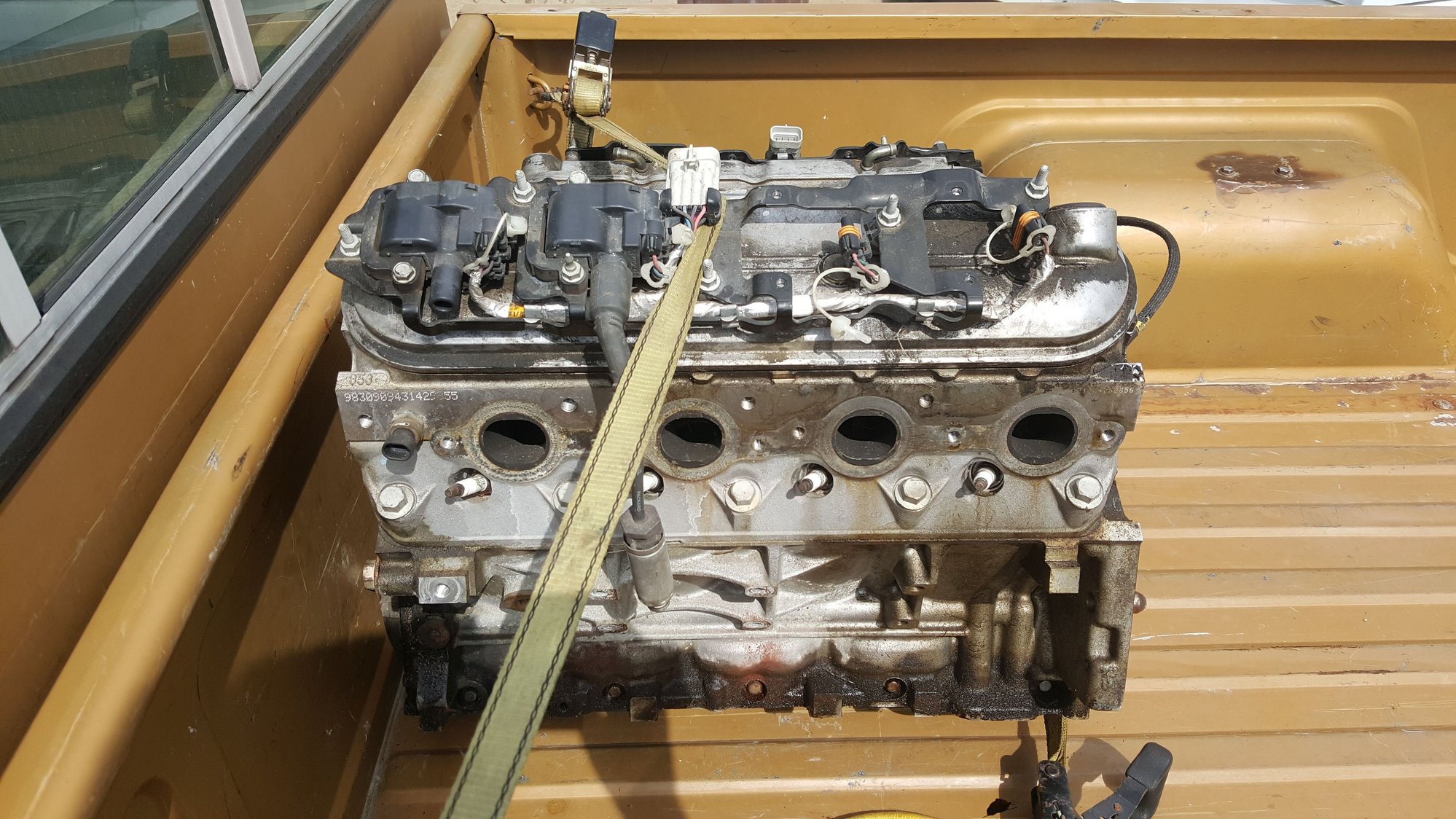

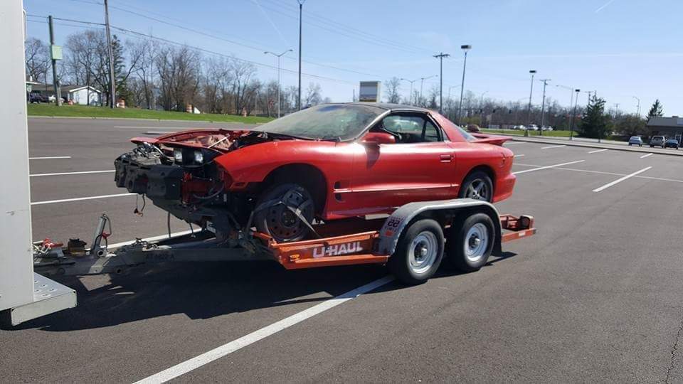

So far I am working on a 1998 Trans Am. Mostly collecting parts as overtime from work allows. Last year I picked up a 5.7 for 400 bucks with a broken intake and exhaust springs. Swapping in a t56 that I am converting from a corvette since it has the triple syncroes. It is getting a Ssr mainshaft since it has a 32 spline count and works with a Turbo 400 shaft as well.

You do realize that the 5.7 ls1 won't hold that much boost. That's why everybody started going 5.3 or 6.0. The 5.7 will be good for around 750 hp with good tuning. Some will say more hp with tuning others will say less hp.
Old Sep 16, 2018 | 05:57 PM
Transamthunder's Avatar
Joined: Feb 2007
Posts: 158
Its all in the prep. Its gonna hold the same power as a 5.3 or 6.0 on the internals. The blocks themselves are fine up to 900 before you need to start gusseting things. Gapping your rings out for boost off the bat goes a long way to help Is this the best engine to use, nope. I agree, but I couldnt find an L33 at the time, so this was the good deal i found at the time.

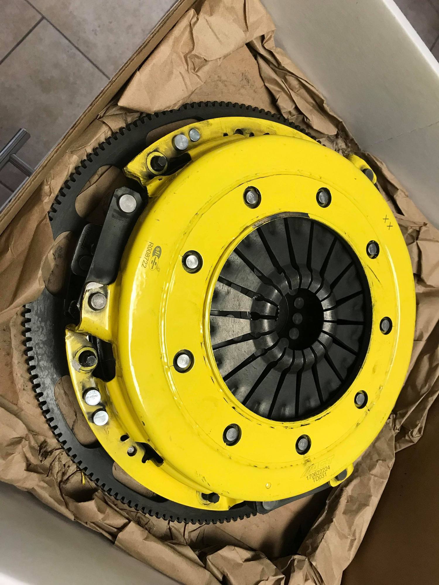

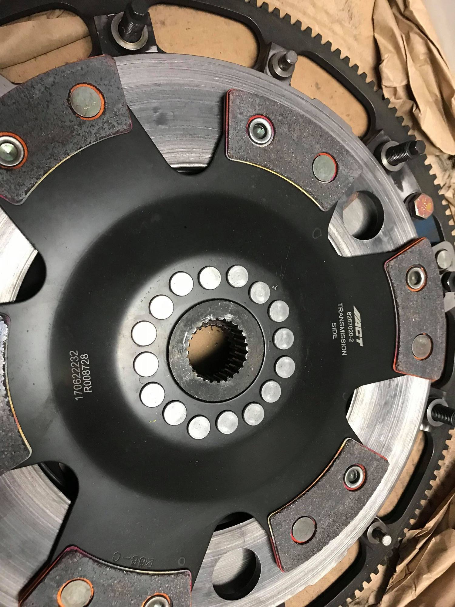

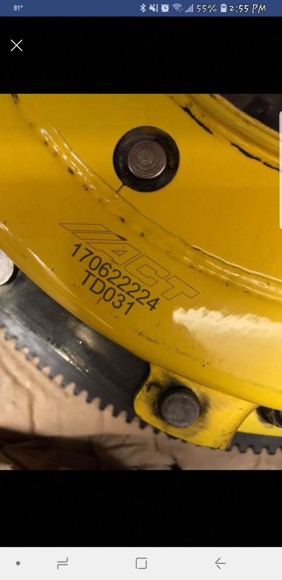

Act twin disc
China 76 64mm turbos

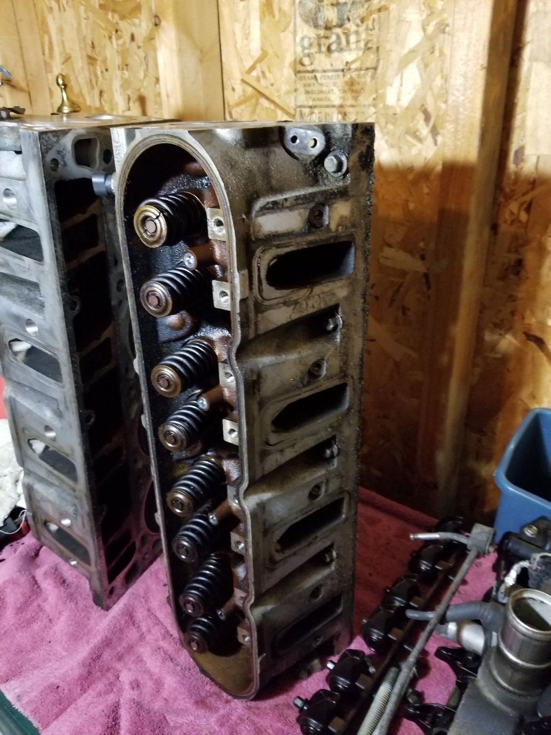

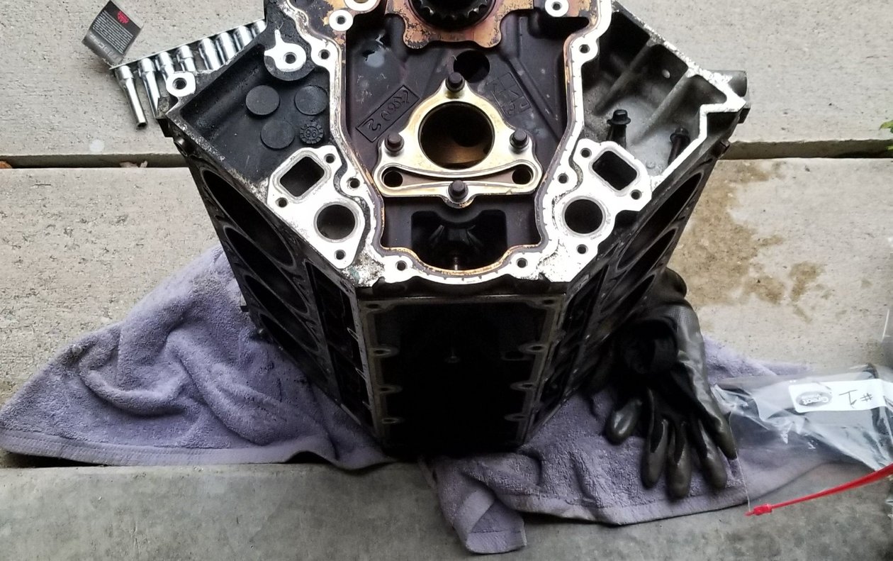

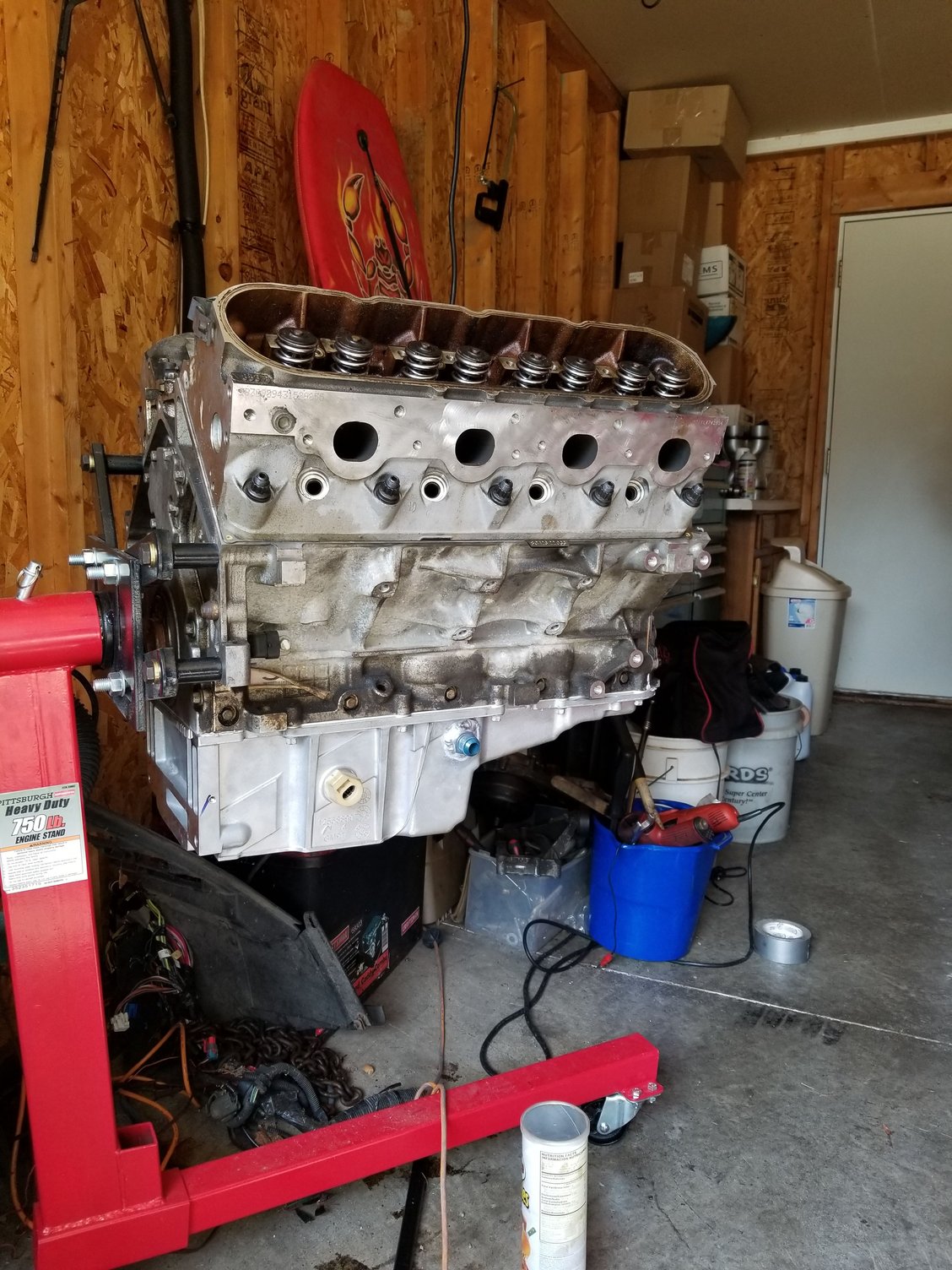

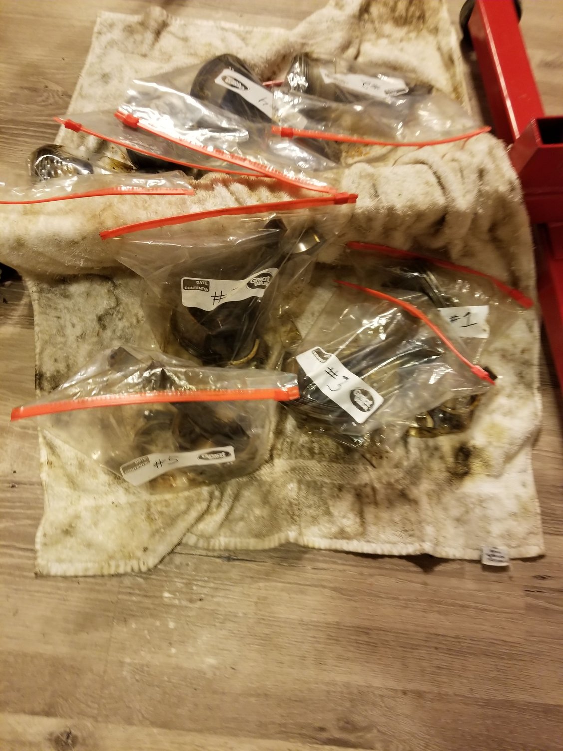

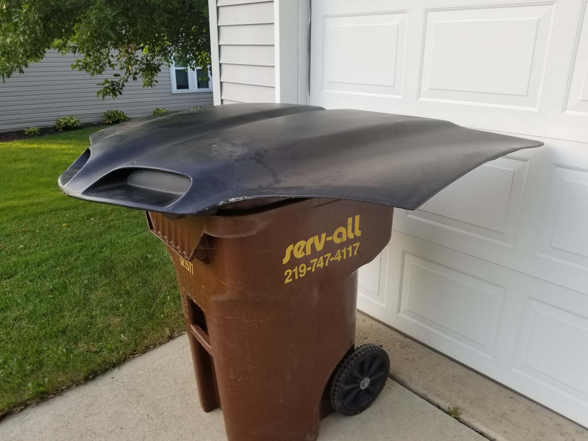

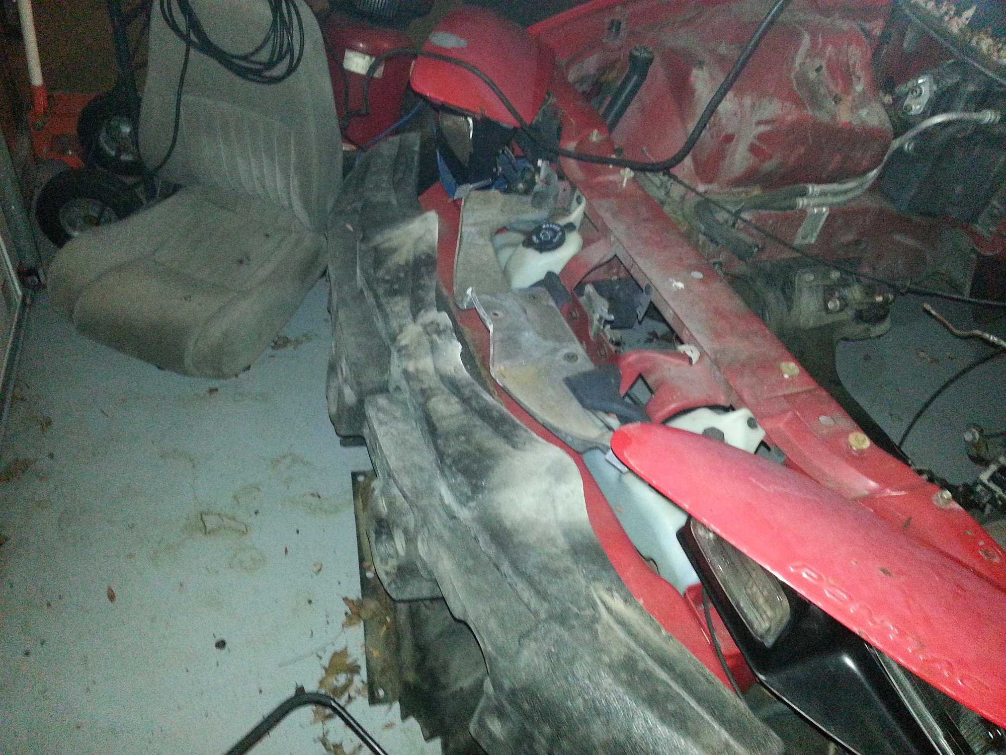

Unlucky subject for boost
Engine tore down with parts bagged up.

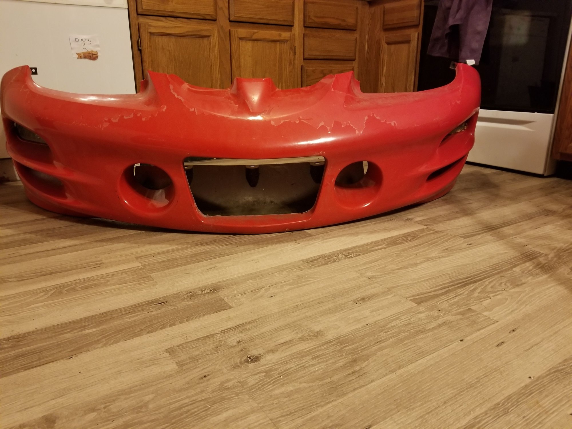

Hole for intercooler cut in front bumper

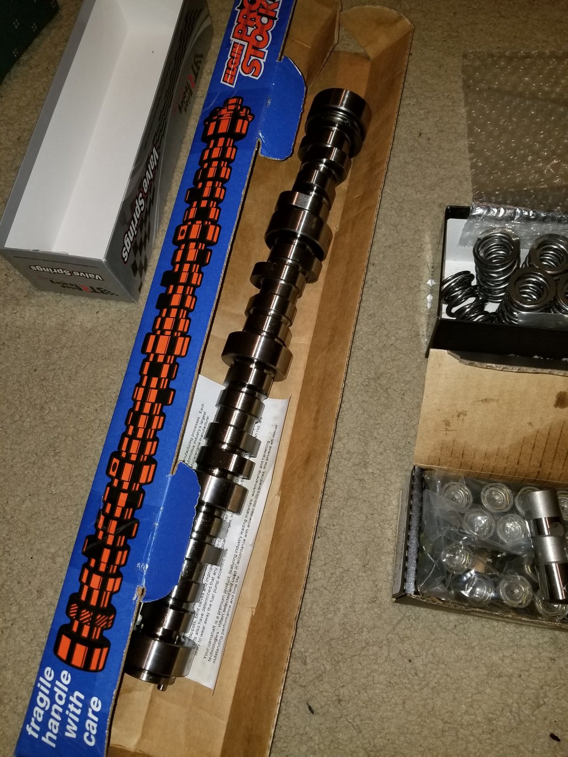

Btr .660 dual springs
Elgin 238/242 .595 lift lsa112

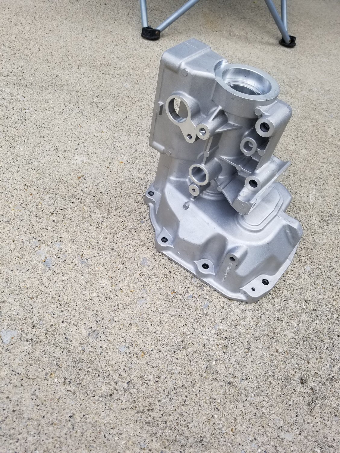

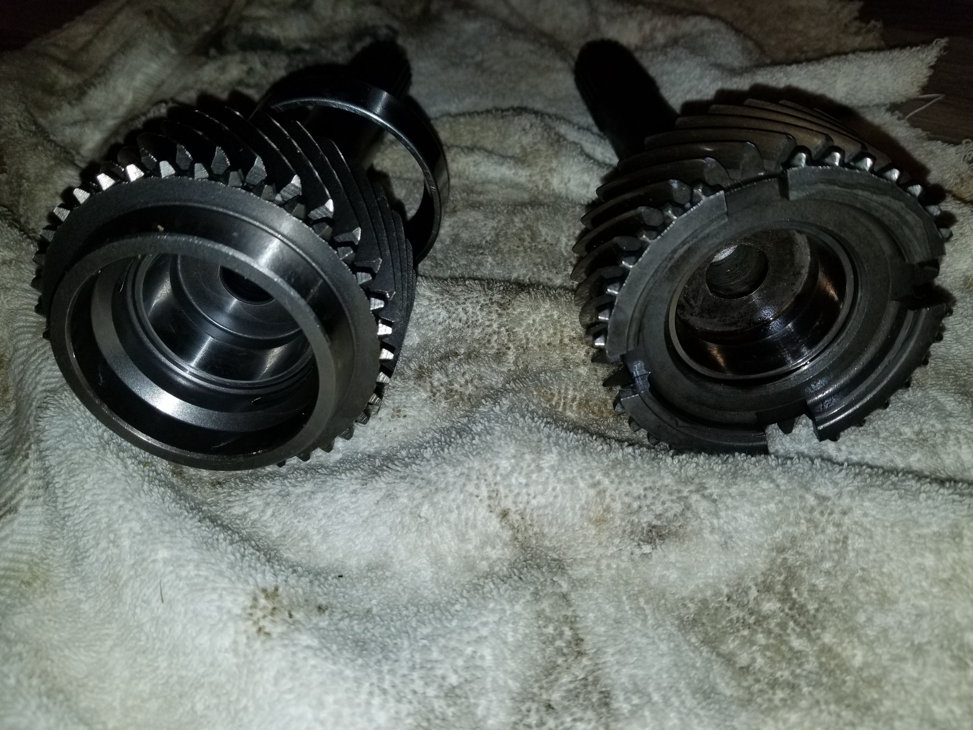

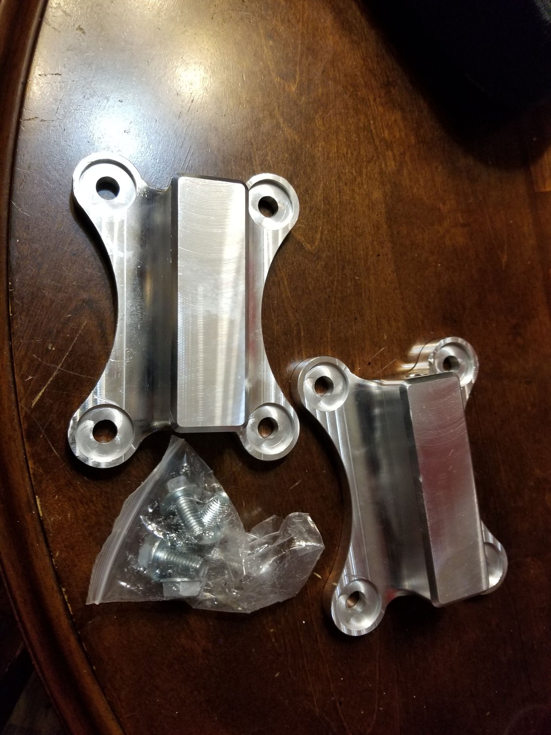

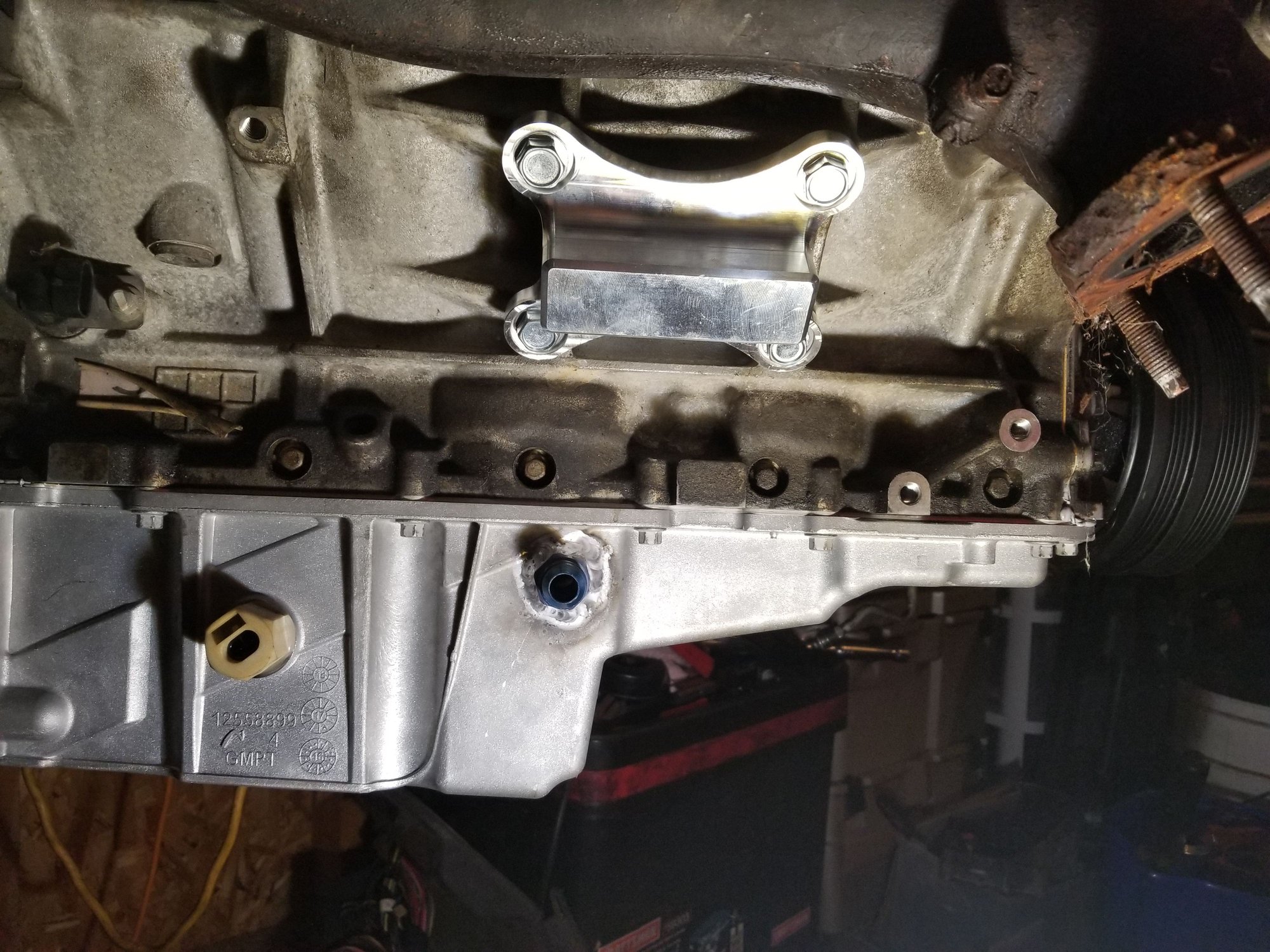

Corvette trans modding for fbody engine mount with ssr mainshaft, and z06 1 piece counter shaft
Mistakenly bought wrong input shaft. You can see the difference on the end of the shaft between double and triple syncros. Trying to keep my research up along with buying parts

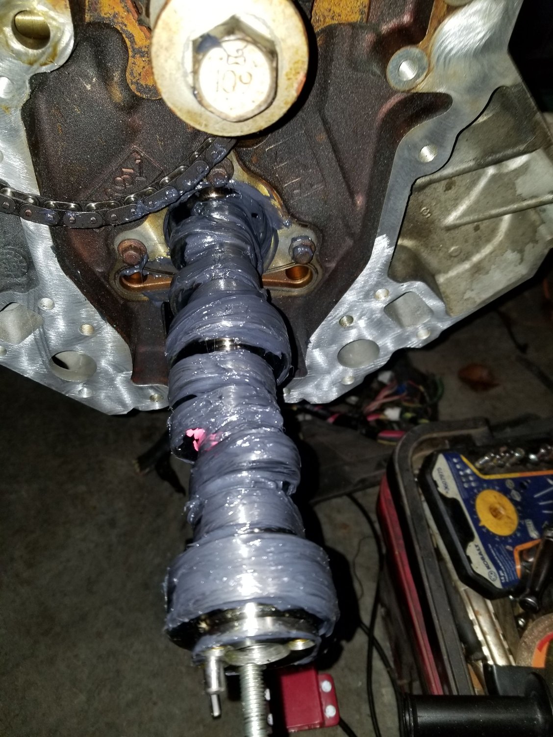

What did you put on the camshaft when you installed it?
Old Sep 17, 2018 | 06:12 PM
Joined: Feb 2007
Posts: 158
moly lube

From: Minnesota
Like the stuff you use on ARP headstuds?

Thats a big cam, too big.
Old Sep 30, 2018 | 04:47 PM
JosephIV's Avatar
Joined: Mar 2008
Posts: 652
Likes: 12
From: Valley Lee, MD. Southern Maryland
That is a big cam. It's like a "Stage IV, Non-turbo Cam" lol. I'm interested in the results. I say send it and see what she does!
Old Sep 30, 2018 | 05:24 PM
qweedqwag's Avatar
Joined: Dec 2016
Posts: 665
Damn thats a lot of moly but everything is better with a lil bit of lube.

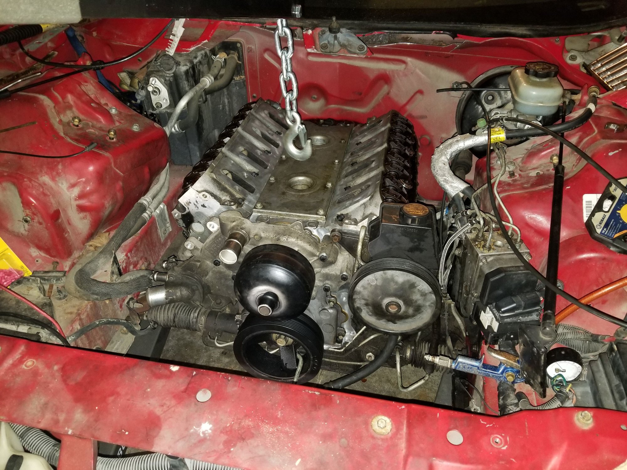

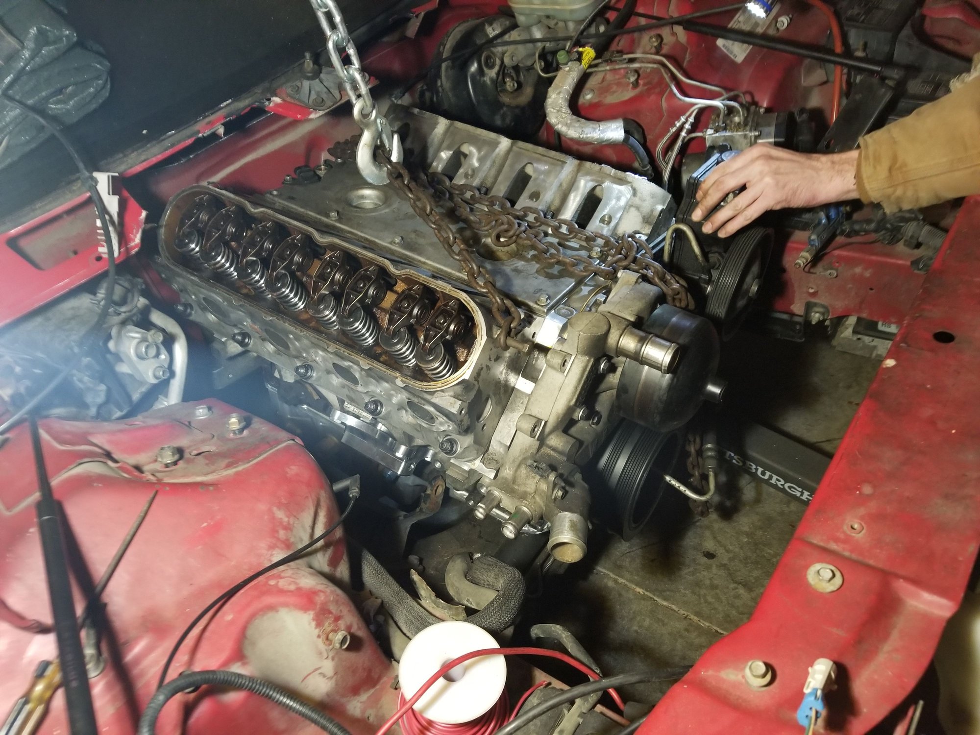

Finally getting around to setting in the engine
Old Nov 24, 2018 | 11:03 PM
Joined: Feb 2007
Posts: 158

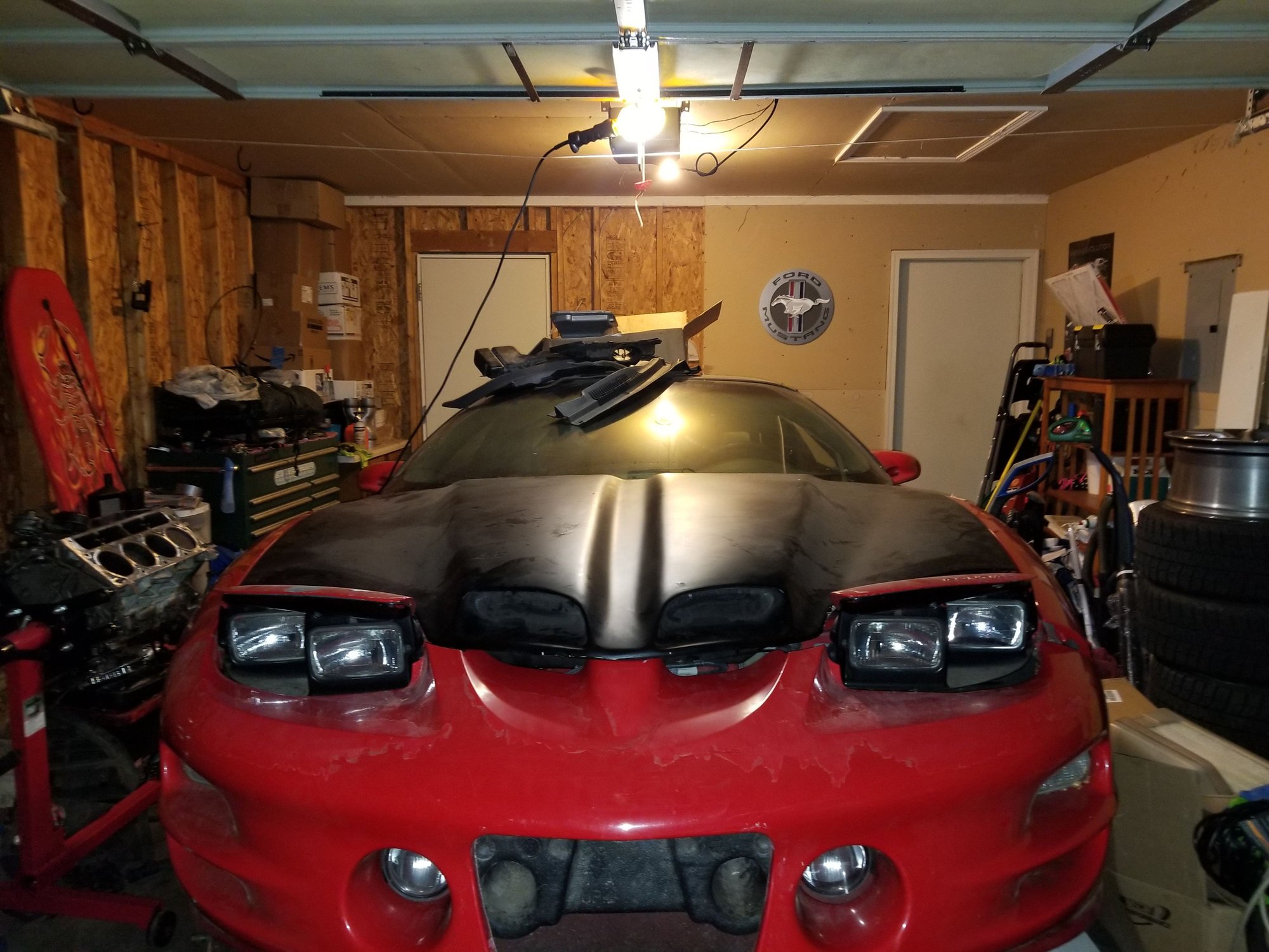

Still tearing into the trans to swap a bunch of parts, bit the engine can sit like this for a minute.
just what came in the ARP package.
Old Dec 23, 2018 | 05:43 PM
Joined: Feb 2007
Posts: 158
why I decided on this one. Wanted to see what a magic stick 3 spec might do with boost. This one is from Elgine, and has inder .600 in lift, bit it should be faurly similar. There has been a few guys try the magic stic with boost and weirdly enough liked it.

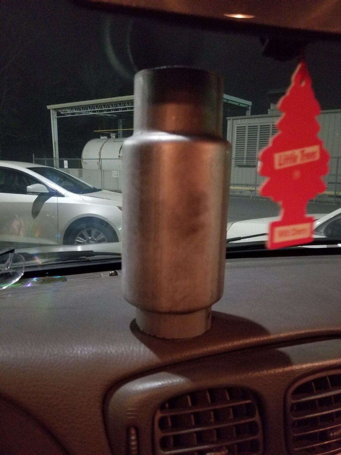

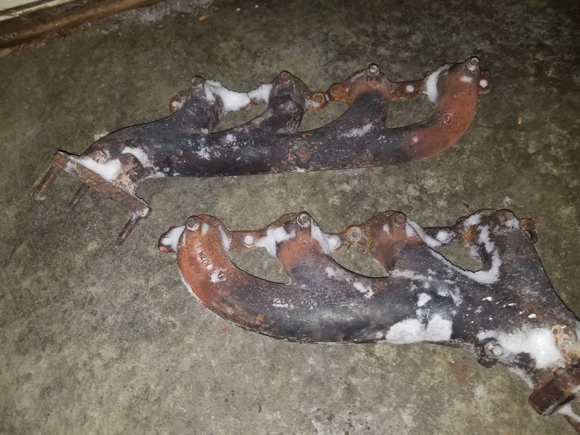

Dynomax makes'em in 3 flavors. Loud, louder, and f@#k you. This is the 3rd one.

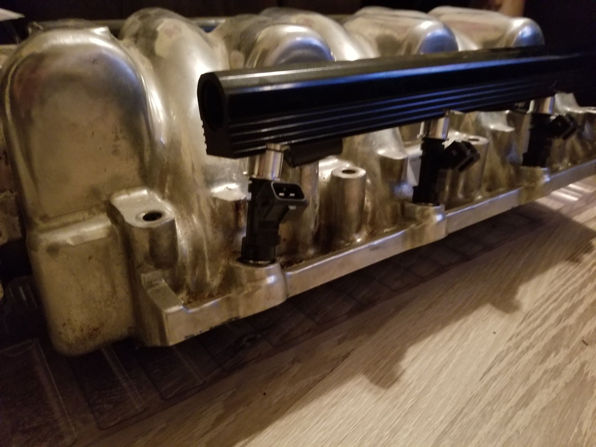

Bosch 210 injectors with some Ebay fuel rails on what I believe is a Professional products Typhoon intake
