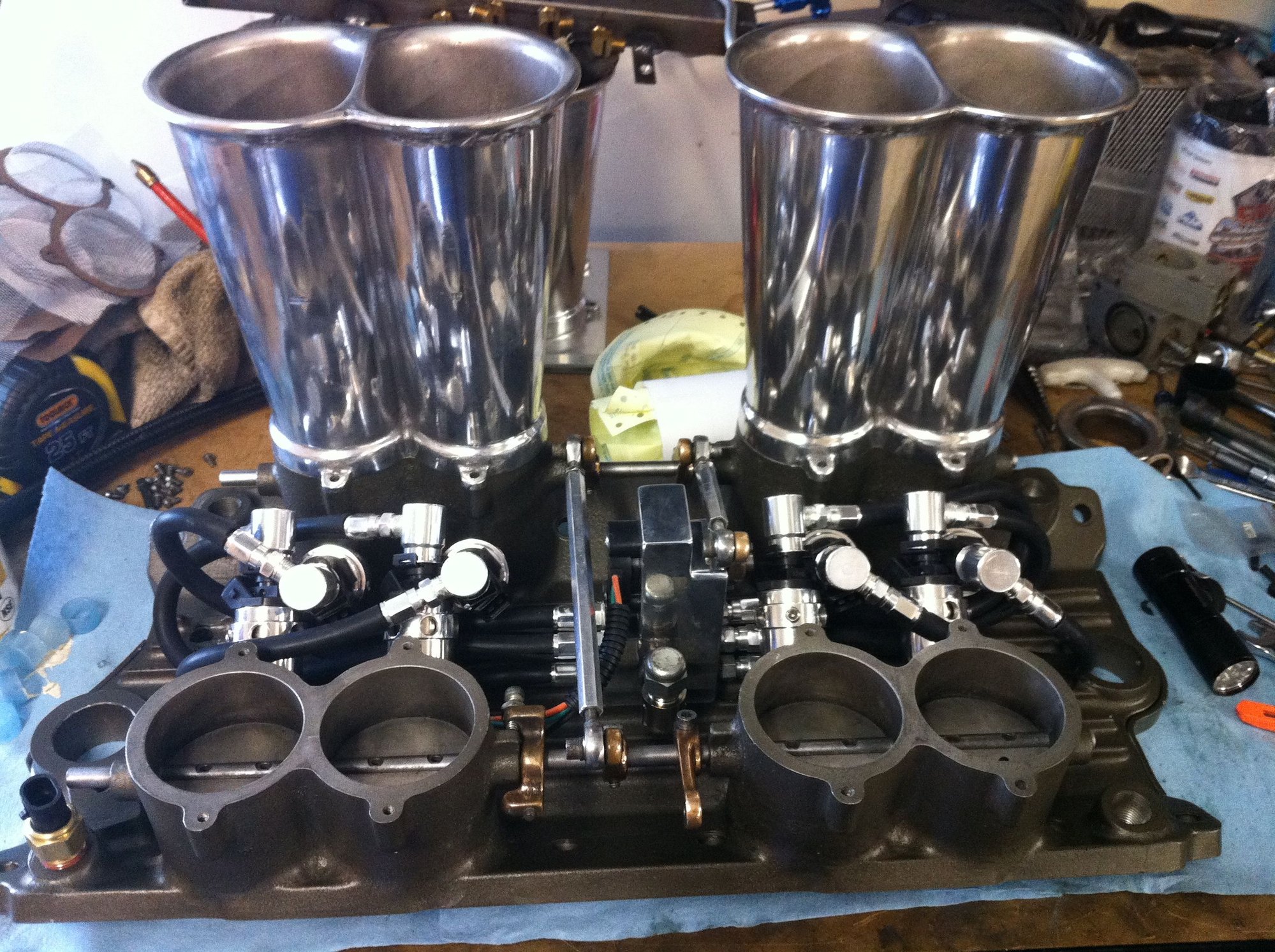

That Carabine ECU is pretty crude when it comes to tuning. I found info quite a while back when I did an electric conversion to a ‘65 Enderle stack intake. I ended until going with the Holley Hp and a small cap HEI distributor. Runs great! No IAC, rear mounted fuel regulator, dead head fuel system into the injectors. Basically all the stuff everyone said wouldn’t work. Reach in hit the key cranks once and fires. Drive it anywhere I want.
Here’s the converter intake
Here’s the car.

NICE CAR! That is what I am talking about! Old mechanical intakes that are works of art with modern control. I was wondering about the IAC for idle but I am sure this blower wont care!
Yea, the Carabine ECU is a headache. It makes fuel squirt but crude control and I dont like that I cant tune with precision. So it will be
sorry to hijack...do you know were to pickup those individual injector hats?

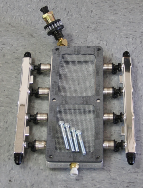

Here is the injector plate that I will more or less copy. I will make it on my mill in my garage.
I’ll send you a PM.
