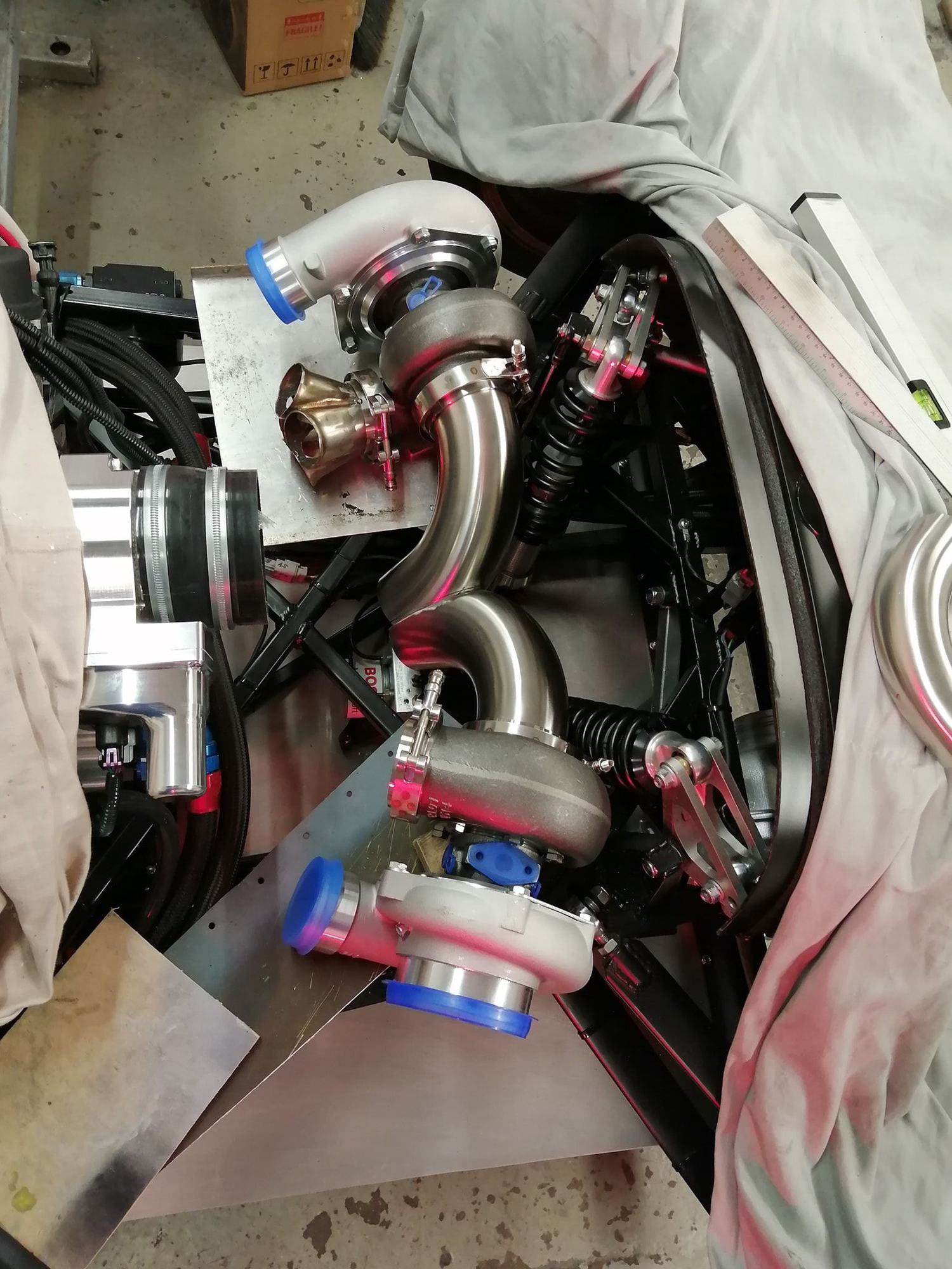

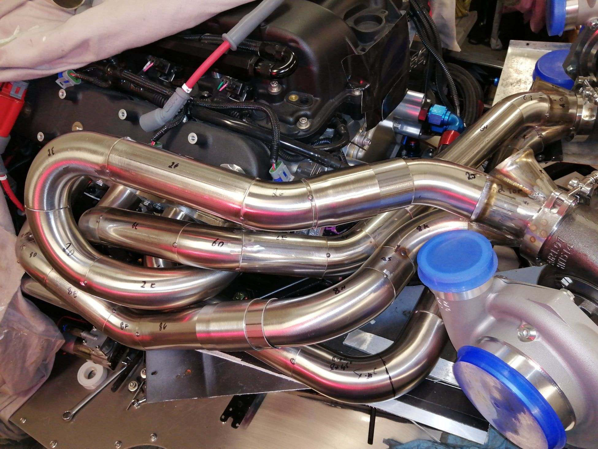

And then a friend in Scotland starts to build just that lol. And all in a lightweight Westfield chassis, AWD setup with a 7.2 LS with a pair of G35-1050's

I wouldn't say the benefits aren't' there. They seem pretty clear on the 4-6cyl world. A v8 would have even more interfering pulses and more frequent exh pulses, so wouldn't the benefits be even greater?
Wouldn't running a true TS with a single be more beneficial? You'd have divided pulses acting on the same exh. wheel with no interruptions. So the same wheel is hit with twice as many exh pulses. It think that would give it much better response than if you divided the pulses between 2 turbos?
Typical V6 TS setup VS open scroll on same sized turbo w/ swapped housings and manifold.
I think BMW did it right on their TS V8 setup. Simple short routing up top with the intakes where the EXH ports usually are. Don't get the goofy piping octopus that way. Seems like the examples above are using pretty huge piping diameter as well... is that 2"?

A V6 single wouldn't see the same possible benefits a 4 cyl would, simply due to the firing angles.
And normally an LS would not benefit either...simply because of the difficulty in routing the relevant cylinders to each section of each turbine, because crossing from side to side is needed.
But really...the work to achieve it vs rewards..is questionable. Although in part he's doing it for a better sound.
Either way, looks bloody impressive and the car will be an animal. Overall weight will be around 1800lbs or so.

It does look like 2", which is large, maybe just as it was readily available.
Isn't easy to get a wide range of sizes of stuff in the UK for DIY fab etc
