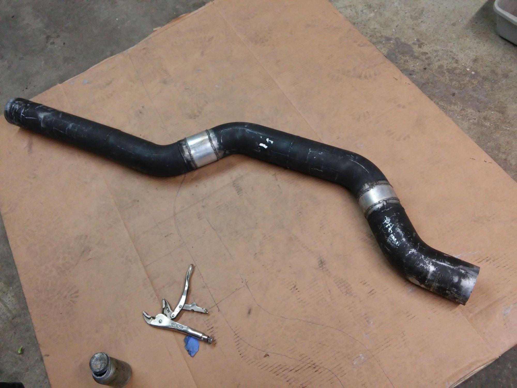

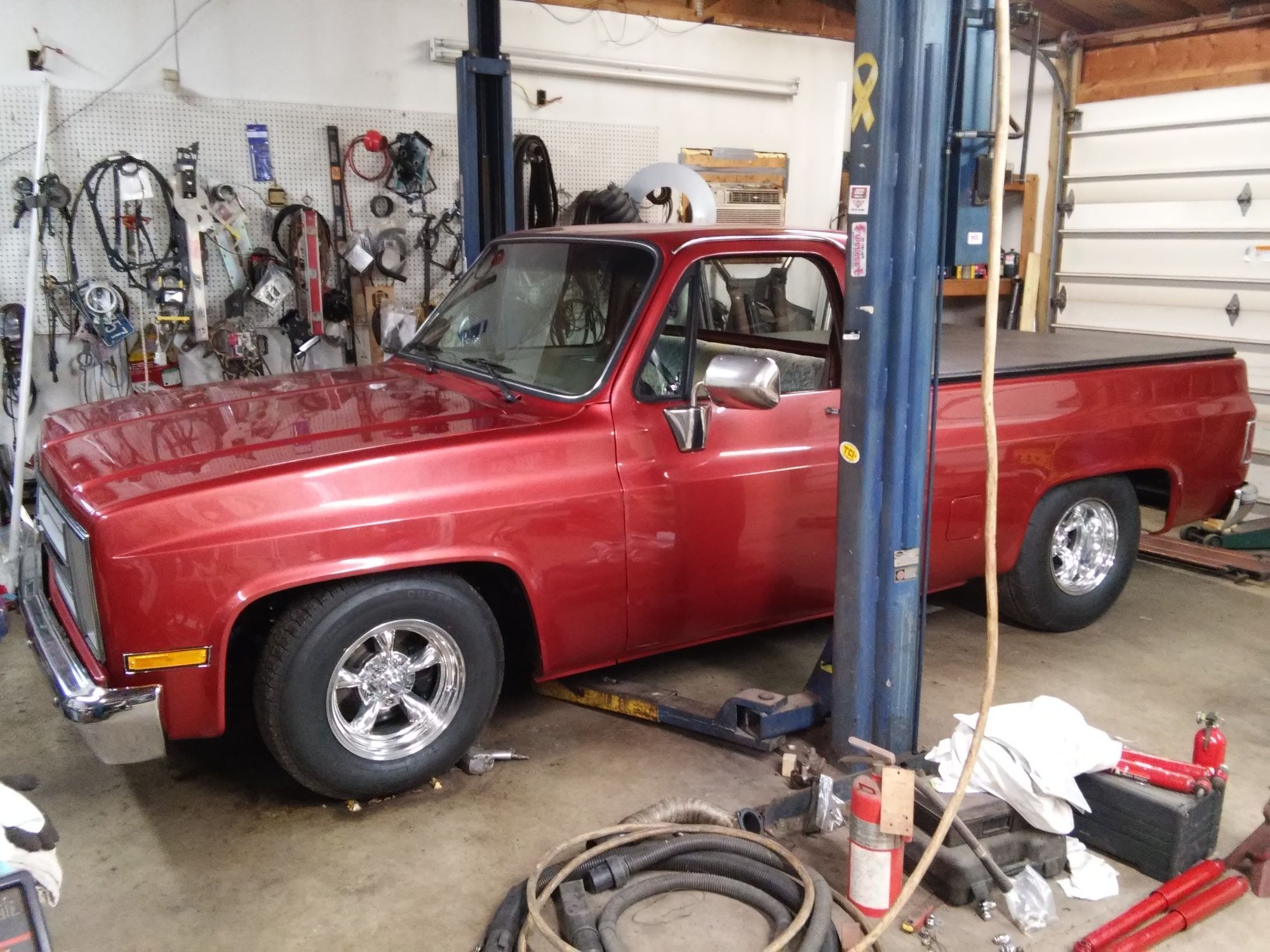

Well, I really wanted the 4" all the way out the back, and it actually ended up lower in the back after
I took the shocks off, so in order to raise it I bought a Rancho leaf and added it, also added a 1/2" lowering
block, so its right where I want it now. I was able to add a couple sections to the exhaust, cut a section of
bed brace out and stuff it up almost against the bed. Also found Belltech had a short shock with the correct
size bolt eyes. Had to notch the bottom CalTrac bracket for the lower shock bolt. Just to add to the joy of
it all, had to shorten the driveshaft 1/2", but gotta keep the economy rolling. Finally calling the bottom done,
Just adding some sound deaden-er to the cab, clean up some wiring, and I am ready to roll-now I have
untill Feb. 22 to decide on Drag Week. I may do LS fest instead.

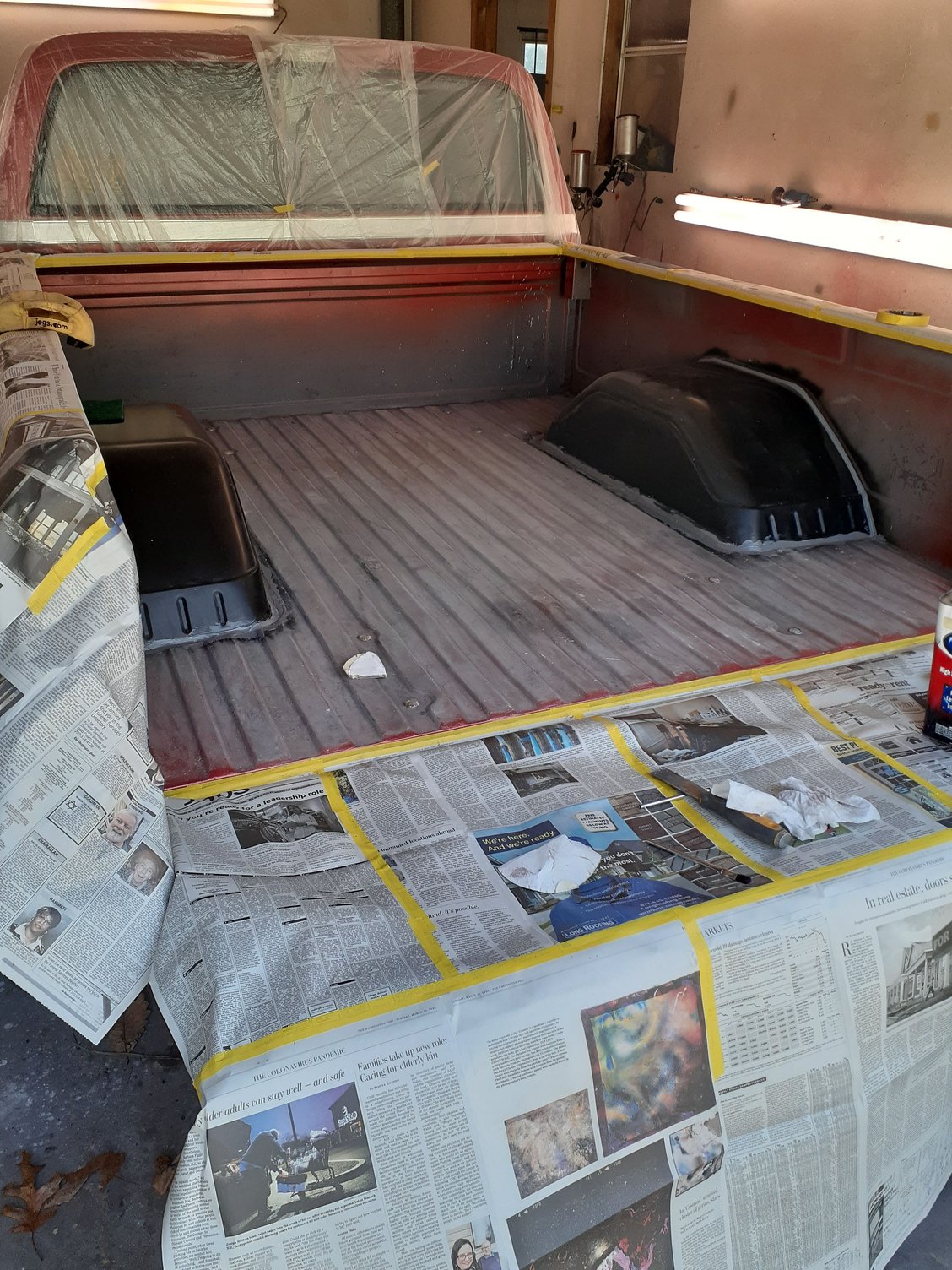

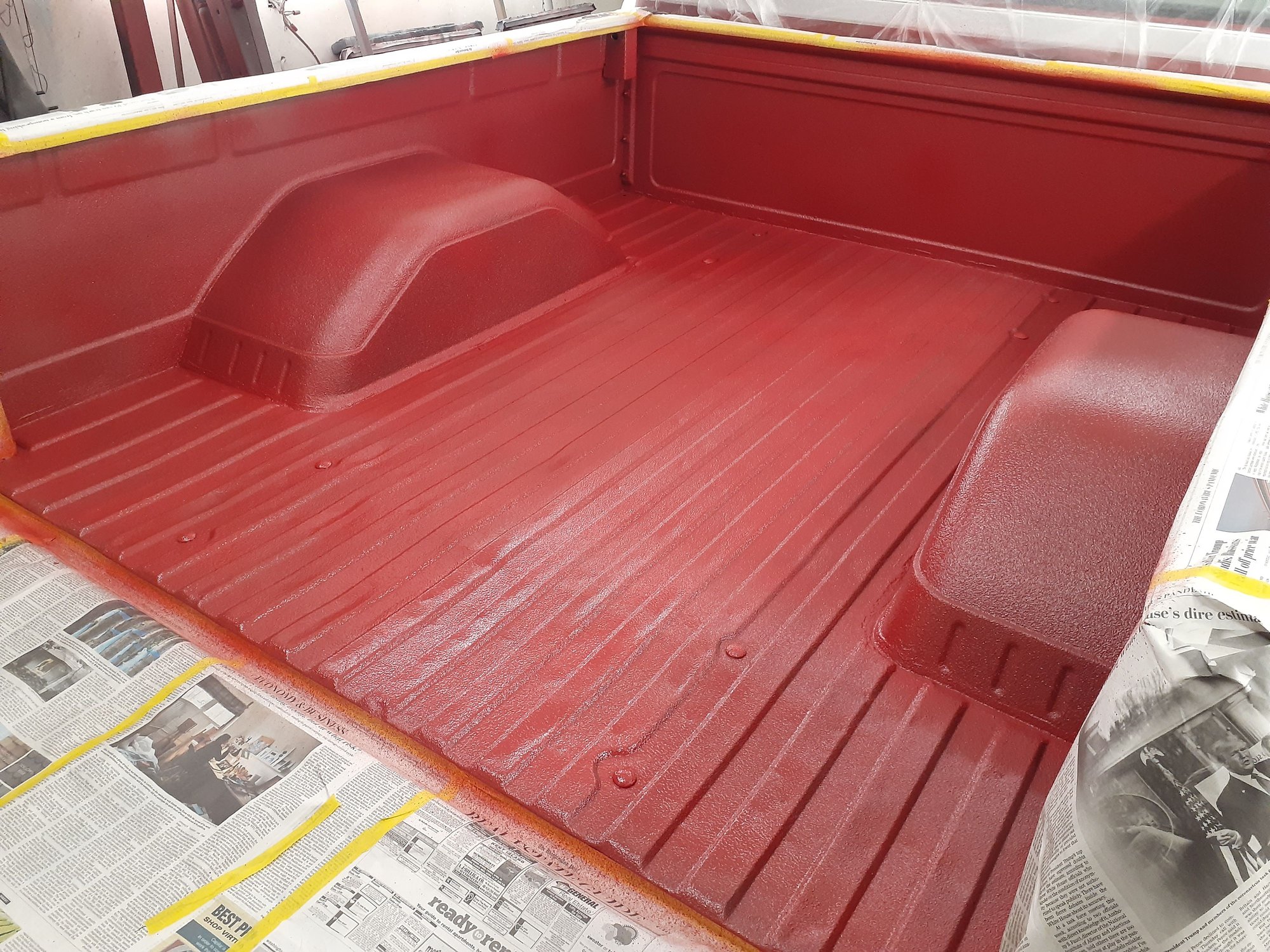

Since not much going on due to the Virus thing, decided to finally do something with the inside of the bed-It was still the nasty gray, although the cover kept it hidden, it needed to be done. I found that the Raptor spray liner had tintable stuff, so I ordered a kit. was pretty easy to use, came with 4 24oz bottles, hardener, and a gun. For the tint stuff, 4 bottles isnt enough, maybe for the black though. Def suck laq. thru the gun bet. changing bottles to keep gun open. I added 10% paint to each bottle. I was able to coat it, but one more coat would cover better.
