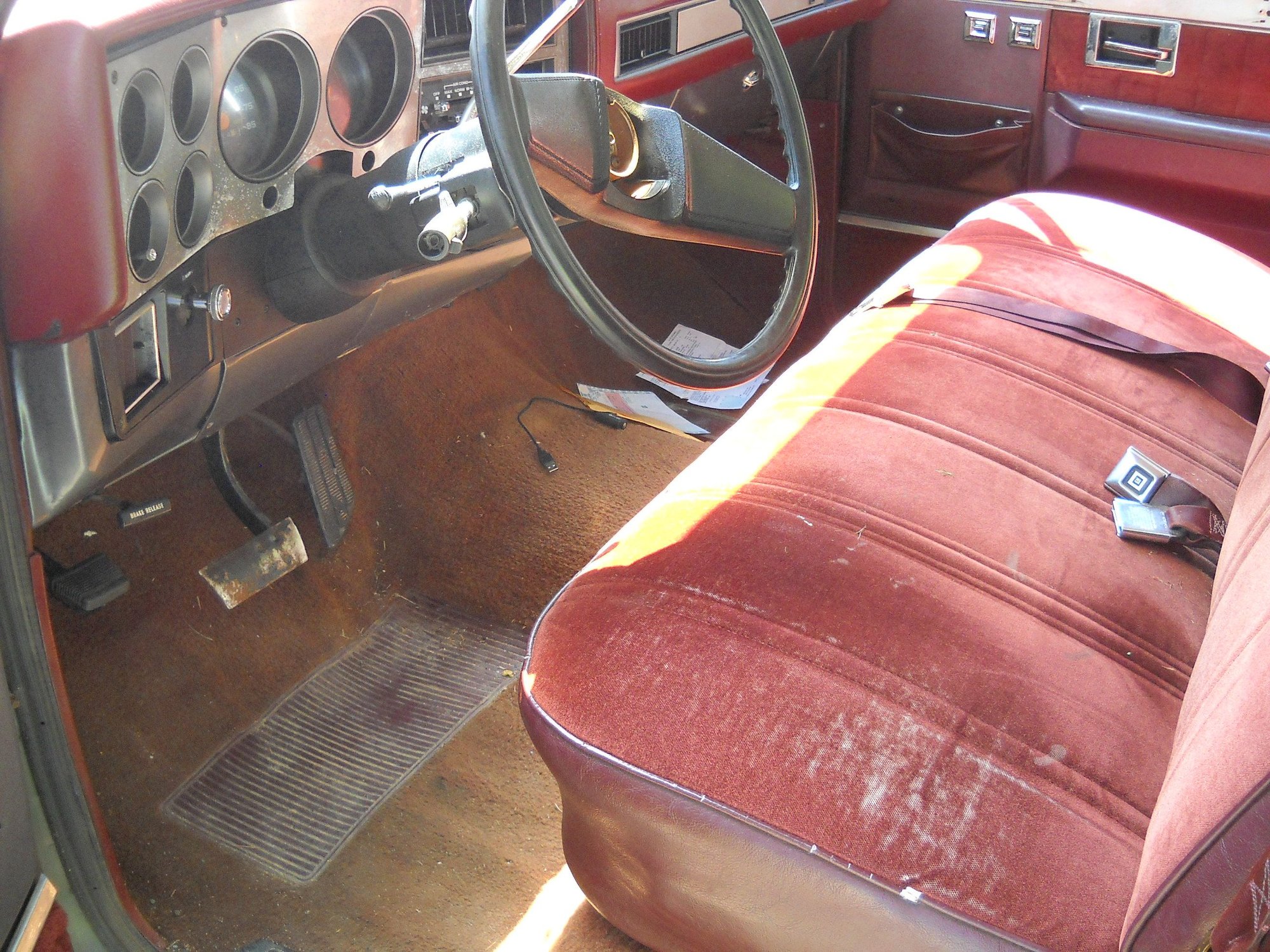

Decided to sell my nova, been wanting to build a nice driver, esp. a short bed, so I guess its time.
At 72, kind of leaning toward comfort vs speed, pretty much realize hitting the track just isn't going to
happen. Although Drag Week 2019 is on the radar, esp being in my backyard next year, lol.
Anyway, starting with an 86 short bed, from Georgia, dam near rust free, needs one cab corner, under
carriage is perfect. Couple dents in the doors, so paint, body work, stripping off ugly paint.

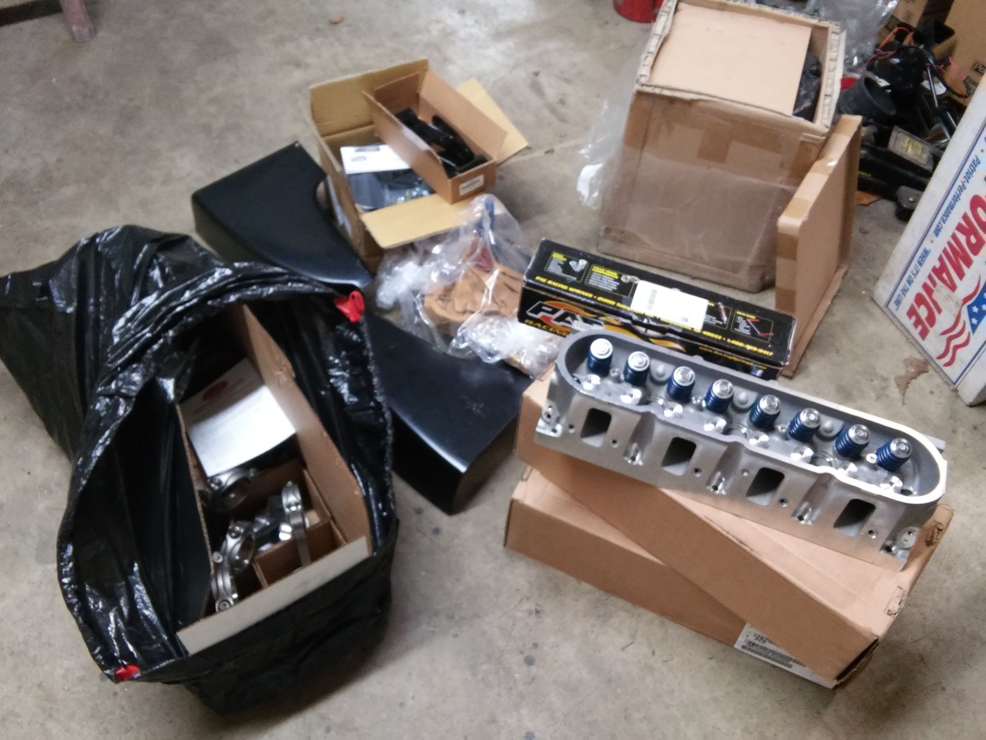

It will be a semi budget deal (remember that one, lol). I have a gen 3 6.0, used 4.005 forged pistons,
Scat rods discounted off Ebay. Scored new LS3 take off heads, intake. Looking at the Summit stage one
turbo cam, KB Racing log manifold, VS billet 78/75. Already have the engine back from the machine shop,
just have to put it together. Prob use another Holley HP, sep. controller for the 80E trans. Truck will be
lowered, but not laying on the ground, lol. I know what I want in the basic build, but will be kind of
fluid based on what deals I get-nice to have friends in high places, lol.

nice it looks pretty unmolested. full options, power windows and such.
you gonna keep a/c? even up here in the great white north I wish I had it.
things I would have done different is leaving the leafs in it and just adding cal tracs. instead of slamming i'd do a nice 3/5 drop and some rallys or turbines.

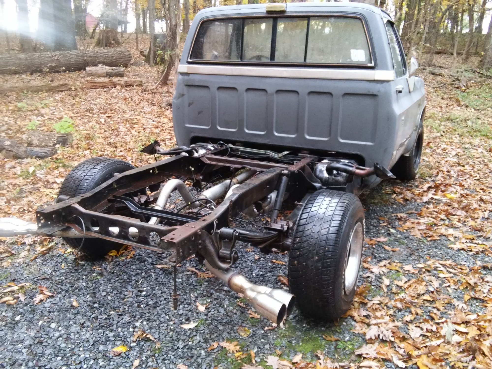

Getting started on the build, pulled the bed, power washed the frame. Got my 6.0 block
back from the machine shop, bored to 4.005, rods/pistons pin fitted, new cam bearings.
I got some LS3 (crate motor) take off stuff, heads, intake, VC's, etc. Sending the heads out
to have checked and springs installed. Got dropped spindles for the front, 4" drop kit for the
rear, new cab corners. Have Tejays engine and trans mounts coming, thinking of switching
to Vintage air If there's money left, lol.

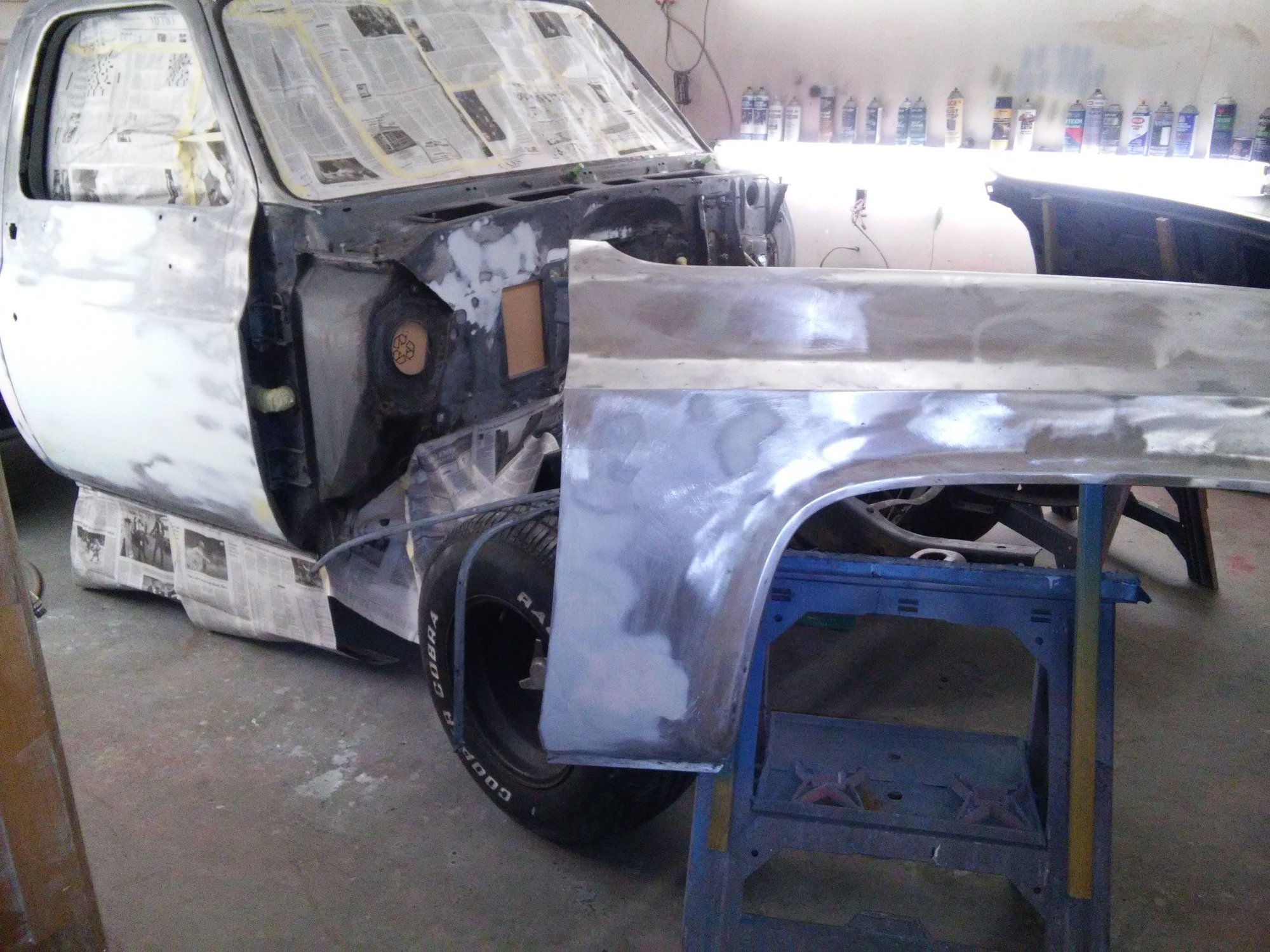

Progress kind of got slowed up, fell off the garage roof and got a little dinged up, but back at it.
Had a buddy come over and work on the doors, couple broken ribs wouldn't let me do the work, lol.
Finished up the fenders, painted the interior, now its time to epoxy, prime, block, paint. Just getting
paint on the cab will be huge, then I can move the truck out, switch places with the bed, and really roll
fitting the engine, trans, putting windows in, etc. i'll have to trial fit the engine to get a location for the
turbo drain, using the truck pan-kind of a pita step, lol, but need to test fit the mounts anyway.
On the engine the linkage on the 90 mm TB hits the WP, the LS3 intake kind of tilts upward so
the hit isn't as bad, I think I can clearance the pump enough. If not i'll have a buddy make a thin spacer
for it-down side to cl. the pump is if I have to replace it, have to rem
. that, lol.

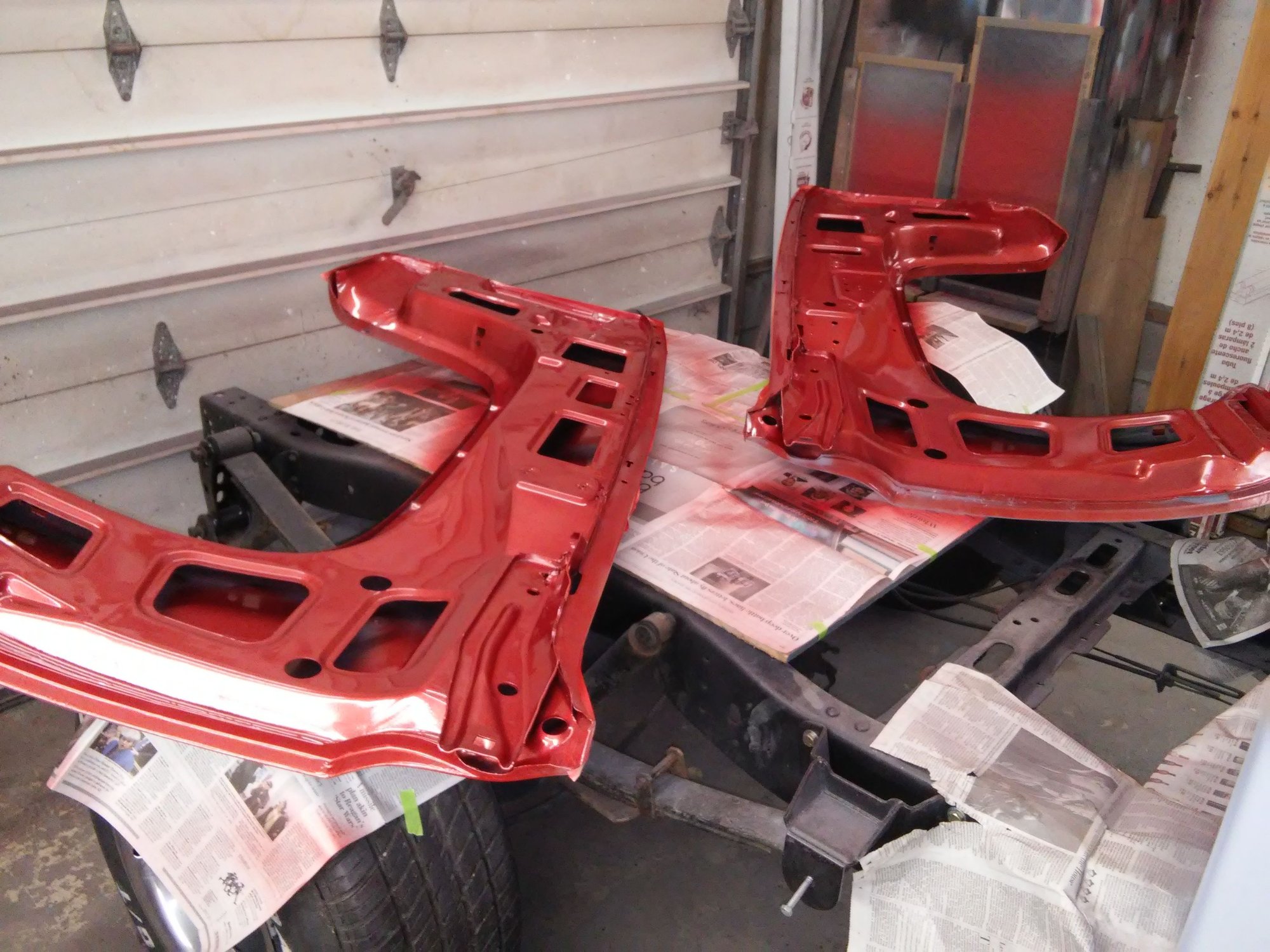

Finally got the truck primed (epoxy, then primer), shot the inside of the fenders, and the firewall,
now I have to block it out, hopefully paint the cab and fenders next week-Getting the cab painted will
will be huge, then I can swap places with the bed, work on painting the bed while putting the cab together,
trial fitting the engine, turbo, etc. Cured my problem with the water pump and linkage, used a 1/2"
spacer.

Its called Cranberry, one of Eastwoods intermix paints. Its a gold met, and a red pearl,
you mix them 1 to 1. Covers good, its a single stage, but I will clear coat the exter.
You get like the 2 gallons, 2 qts. of hardener, bunch of buckets, etc. Its dries quick, so best
used with a slow reducer. It almost looks like a 3 stage paint, rich mets.
