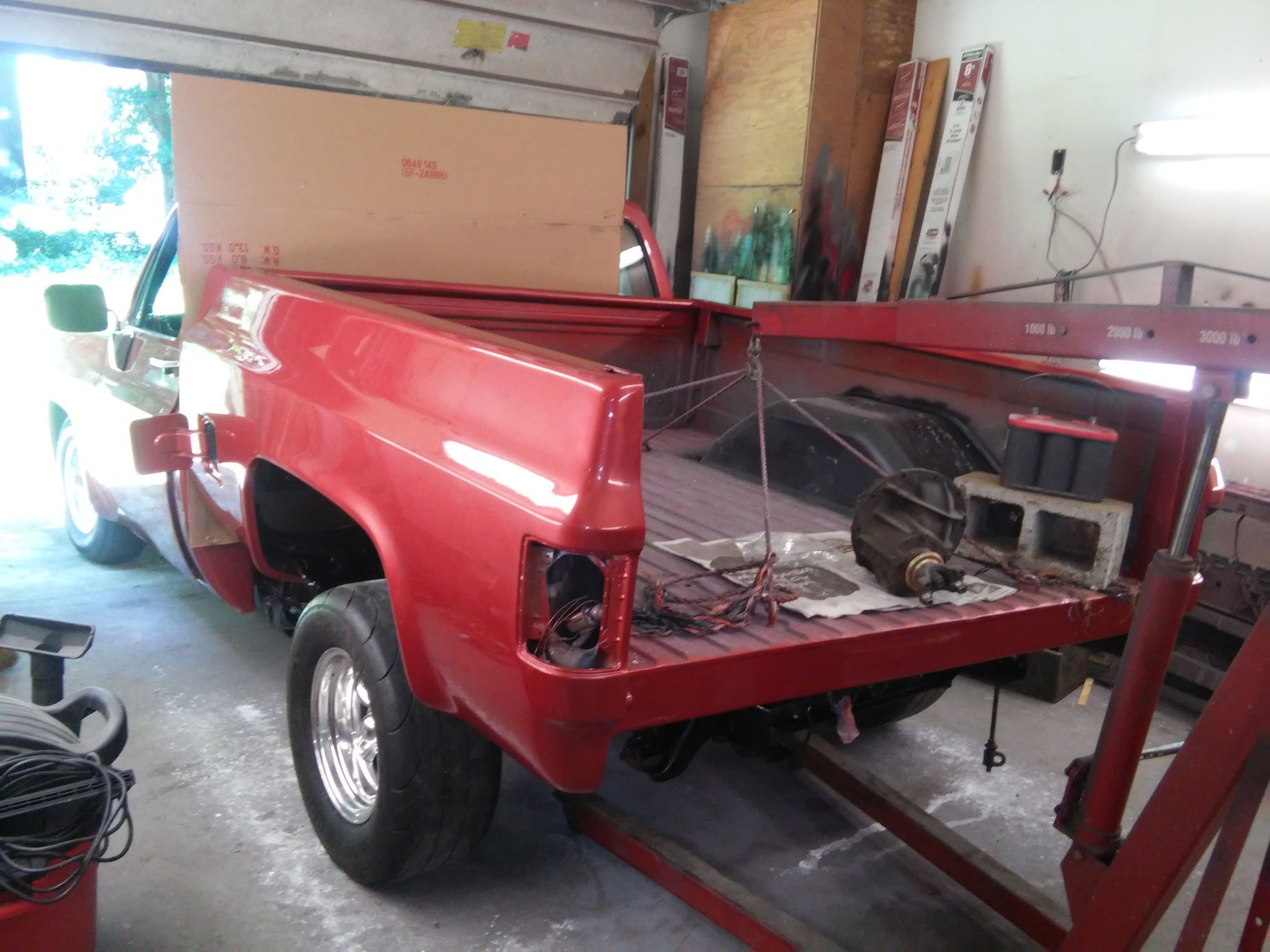

Took the bed off the rolling cart and now on saw horses, makes life easier. Using the
engine crane it was off balance, nothing a cinder block, bat. and rear couldn't fix, lol.

haha i did the same lol but I used a cylinder head
