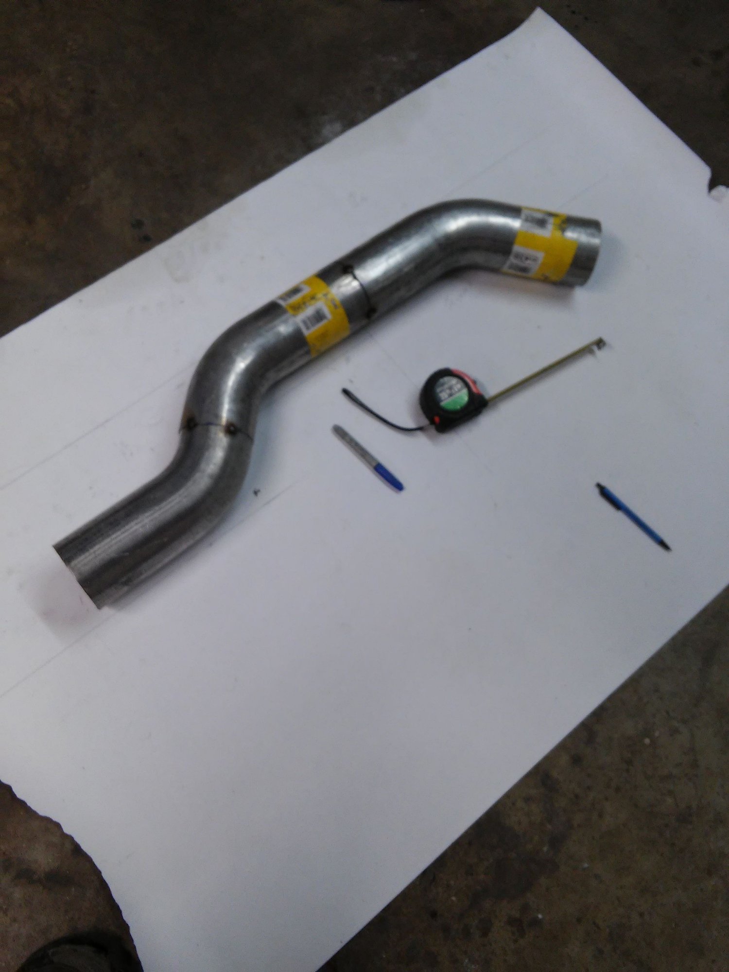

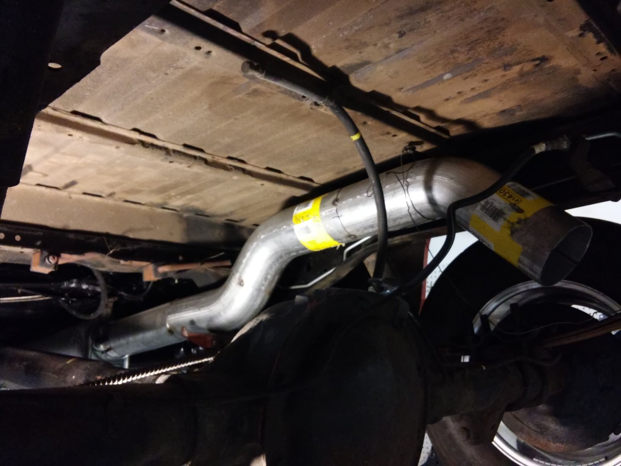

After driving some the newness has worn off on the exhaust noise, lol. I orig ended the
4" under the cab with a straight thru muffler. I bought some 45's, did some meas. so I
could get it past the axle, still need one more 45 to get it to the rear bumper, big improvement.
But it picked up a drone in sec. gear, hopefully that changes with extra pipe.

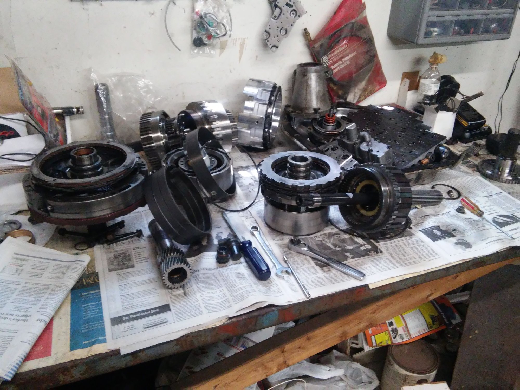

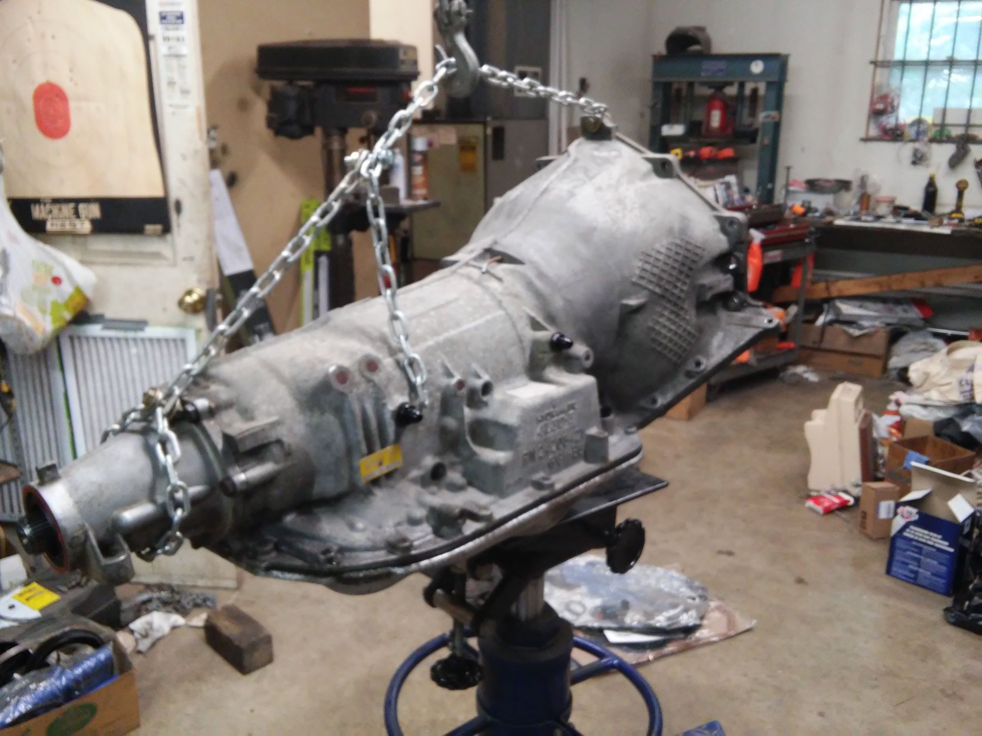

I want to put the 80E back in, but since I didn't really find a problem why it locked up, decided
to tear a 4wd unit down to build as a backup. It was in good shape, could prob. just add the
2wd tail shaft, plug and housing and have a working trans, but this far down but crazy not to
rebuild it. If I put the other in and it still fails, I will have this ready to swap.

I have pretty much just used the HD 2 kits, the experienced builders do other stuff, but
I have done some of the suggested mods on one, and some say to leave out that pressure
relief mod on the HD 2. I think the main thing on the HD 2 is to make sure you have a flat
case and VB because of the sandwich plates, people claim you can get cross leaks. I
make sure when drilling the plates to have then squeezed tight, you could get a little
burr and cause a leak. I was looking at the Jakes and CK Perf. kits, they use a single
plate and block off the acculm. and I think dual feed another way.

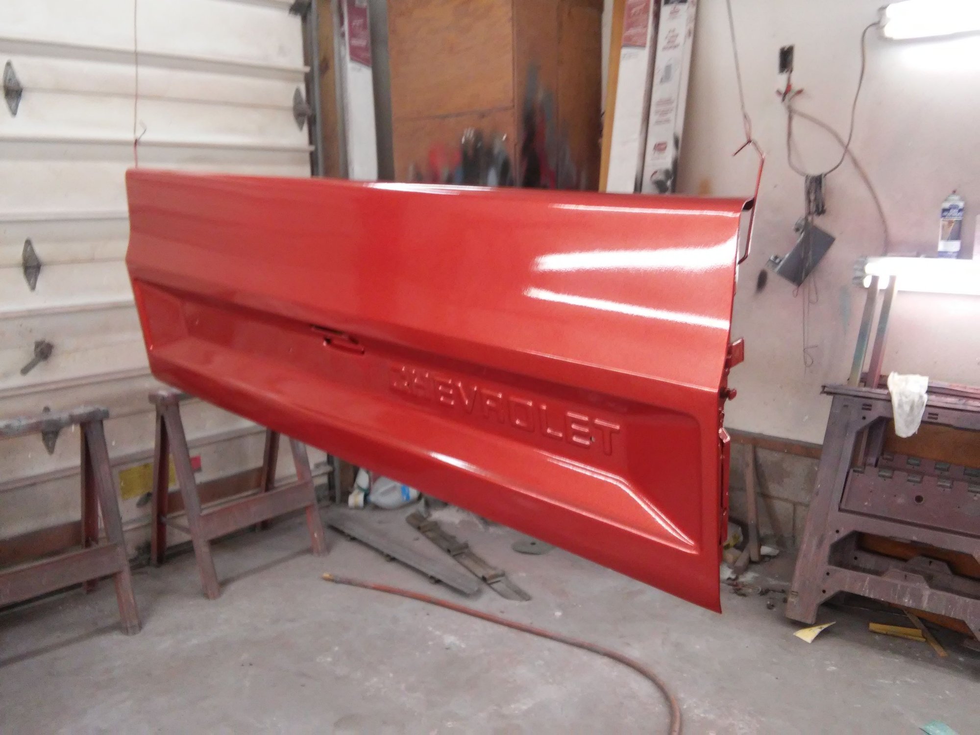

Finally got around to finishing the tailgate, so the truck can be whole again. It was pretty beat up.
so I didn't put a ton of effort into it, might pick up a better one later. Still have to cut and buff it.
Putting the 80E back in this weekend,

I wanted to get an idea where the truck was before swapping back to the 4L80E trans.
Made 9 lbs boost, 4200 RPM, 70% throttle (thought I had floored it, need to verify I get 100%)
With the old switch pitch 400 13" converter, didn't want to wipe out the thrust bearing, lol.
Anyway, installed the 80E, which I built orig as a backup to the first 80E for Drag Week.
It would lock up, never really found out why, will dig back into it later. Anyway this 80E
seems to work OK, gets all the gears, need a controller but running it man. for now.
The old back doesn't like lifting the trans anymore, so I resort to the engine crane, makes

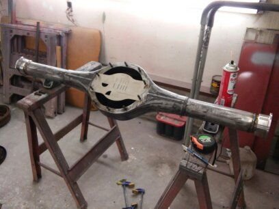

life easier. Hopefully this week I can start on the 9" rear, soon as I get the housing ends
I'll take the housing to my buddy and get it narrowed, order axles, finally have the correct pinion angle.

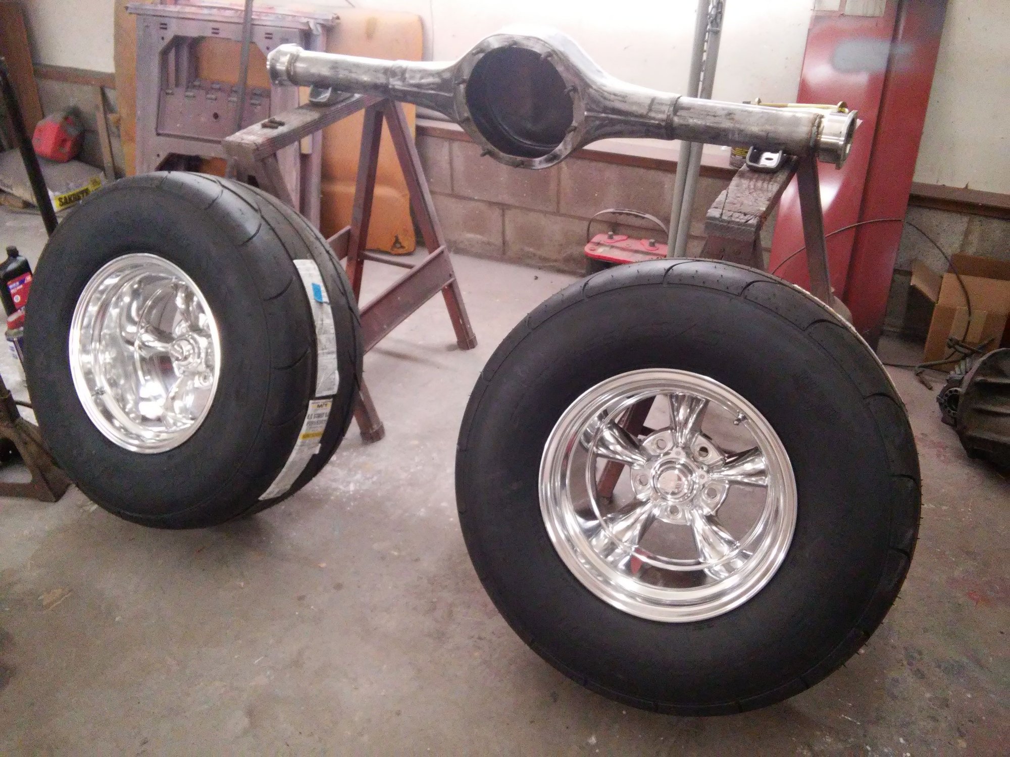

Going into winter I have a list of changes, one will be to reduce the cab noise. I want quite, lol.
Haven't been able to use the power, old open rear held it back, so I narrowed a 9", have to install
it and weld perches, shock mounts, once the pinion angle is set. Using 10" rims, 295/65/15 ET
Streets. Prob change around some plumbing also.
