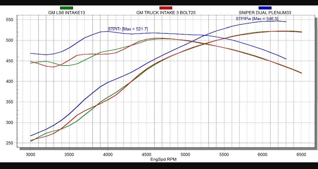

Hey did anyone see this yet. Looks cool and actually dyno shows decent gains over stock through out the rpm range.

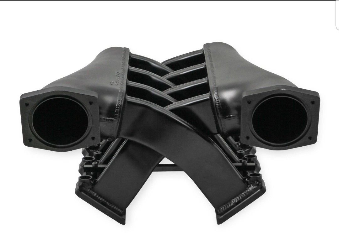

Lots of welds to blow apart under boost with that one !!! lol...and it looks very tall.
Normally an intake of that nature could be a thing of beauty too....just don't think they've nailed it with that one. Would be nice to see more info on that test though.

Looks like a plainer "Me Too" version of the Edelbrock cross ram (which is a nice piece). This wouldn't make the same gains over an LS3 intake, but the extra throttle response from 2 x TB's would be really cool if the TB's were kept smaller

Should run excellent with the long runner and ample plenum volume

Very underwhelmed for the price. I don't expect one off billet masterpieces or carbon fiber but it looks like someone welded two Honda civic intakes together in the middle and spray painted it black. Some nice engraving or subtle color changes would be better than nothing but I say the pro flow looks best then the high ram. Of course Frankenstein and companies like that don't count in this price range or they would of course be top pick

For 20-25 horse? I’ll throw another 2 psi on the dome.
