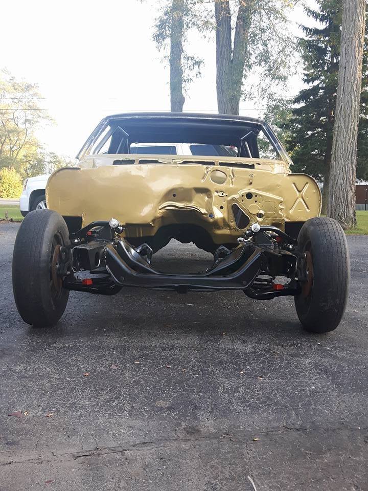

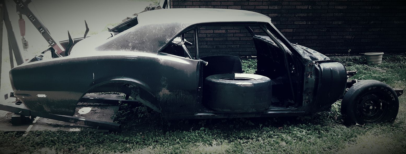

Old Nov 1, 2018 | 12:13 PM
MADSCI's Avatar
9-Second Club
Joined: Feb 2002
Posts: 306
From: Canada
Default The Road So Far....
Old Nov 1, 2018 | 01:26 PM
3 window's Avatar
Joined: Aug 2014
Posts: 2,051
Likes: 187
Awesome! Love the color.

Old Nov 2, 2018 | 12:31 PM
3 window's Avatar
Joined: Aug 2014
Posts: 2,051
Likes: 187
You build the core support?

Old Nov 7, 2018 | 11:42 AM
MADSCI's Avatar
9-Second Club
Joined: Feb 2002
Posts: 306
From: Canada
No picked it up for $100....could not pass that one up!
