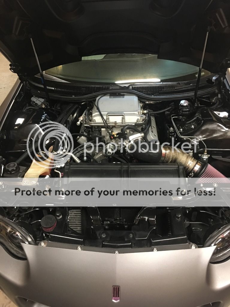

Hey guys, I posted this in Internal engine as well but thought i might get more of a response here.
I am going to be doing a crank pulley swap on my car in the not to distant future and while I was in there I thought I would go ahead and change the cam as well. Car is a 99 Camaro A4, stock bottom end LS1 with a set of PRC 243 stage 2 heads, 228R cam topped with the LSA blower @ 11psi and meth injection.
The car runs well but I am trying to get back to a more stock like feel, mainly idle quality and low speed manners. Getting the valve train quieter at the same time would also be nice. Car currently has a 4l60 with a yank 3600 stall. Will be doing a 4l80 swap at some point as well and will be doing a converter that will compliment this setup at that time. Any ideas or suggestions on the cam is appreciated.
