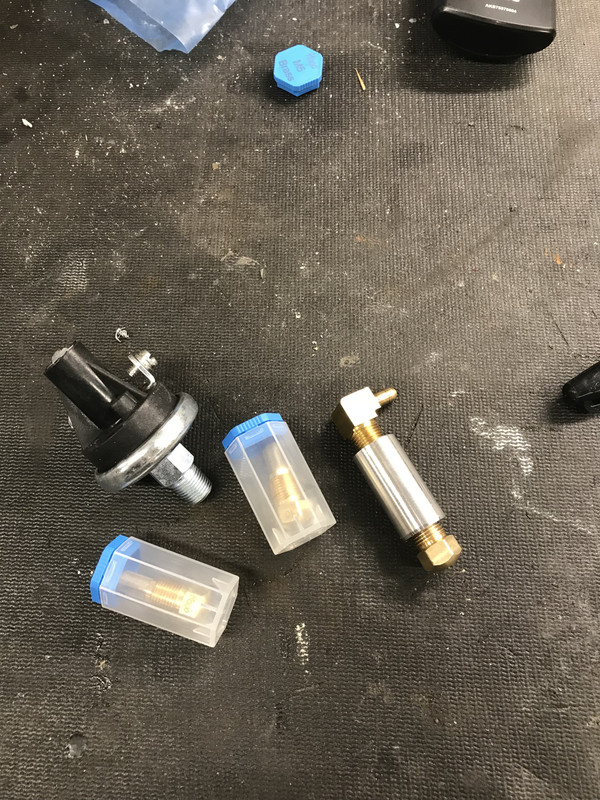

What psi should I turn the meth injection on? Here’s what I’m thinking. And give me your thoughts. The other night I got on it and it started clattering at 9.5psi. so I turned the timing down a couple degrees. I think it might have been lean but my wideband was inop. I was at 14 degrees and now im at 12 with 11.2-11.8afr. No clatter. Yea that scared the **** out of me but it happened and I immediately let off. I was gonna put a small nozzle (homemade kit with McMaster nozzles) and kick it on at 8psi. I can use my cortex boost controller to control it however I like. What your thoughts?
Car info is in my sig but 2004 ls1 gto, heads, cam, 7875 turbo.

I usually do somewhere in the 6-8 PSI range. Most of the time its tied into the 2nd fuel pump and powered through the same relay, so they both kick on at the same time.

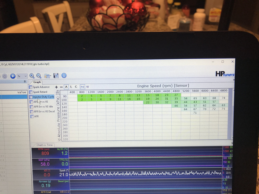

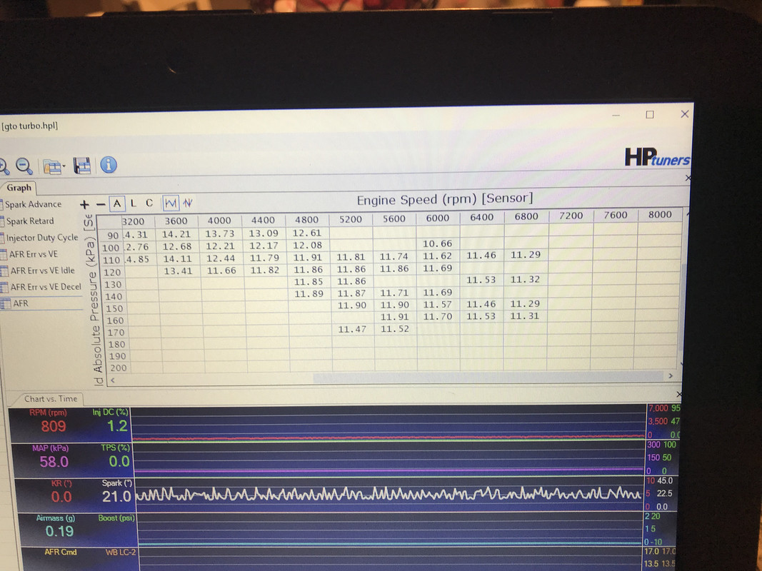

i have 60lb dekas. Duty cycle is at 75% at 6800 rpm with an afr of 11.31 so I’m getting a little close but I think I can squeeze anoth 80-100hp out of it. I’m upgrading the downpipe to a 3.5” oval from a smashed in my vice 3” pipe. I ordered a bigger airlter because the one I have is pretty small. It would choke an NA motor so I know this one isn’t breathing. Probably gonna end up getting 80lb dekas when someone sells some and then I’ll do a boost a pump for now. I have an aeromotive 340 right now.

Here’s my afr and duty cycle from last night. Looks like 10psi on the 2-3 shift. But levels out right after.
