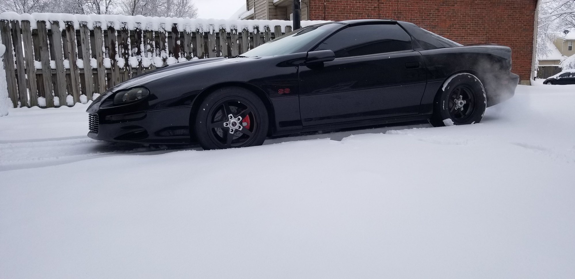

Don't want no stinkin racecar! MAN UP!!

This was from March, but yea, gets chilly/snowy here. Was 20 degrees the other morning and it's still a month from being winter. But about the vid that OP posted, I can't hear the clatter, but if you are hearing it, that is absolute murder on bearings/pistons. I really am surprised that it hasn't come apart yet.
