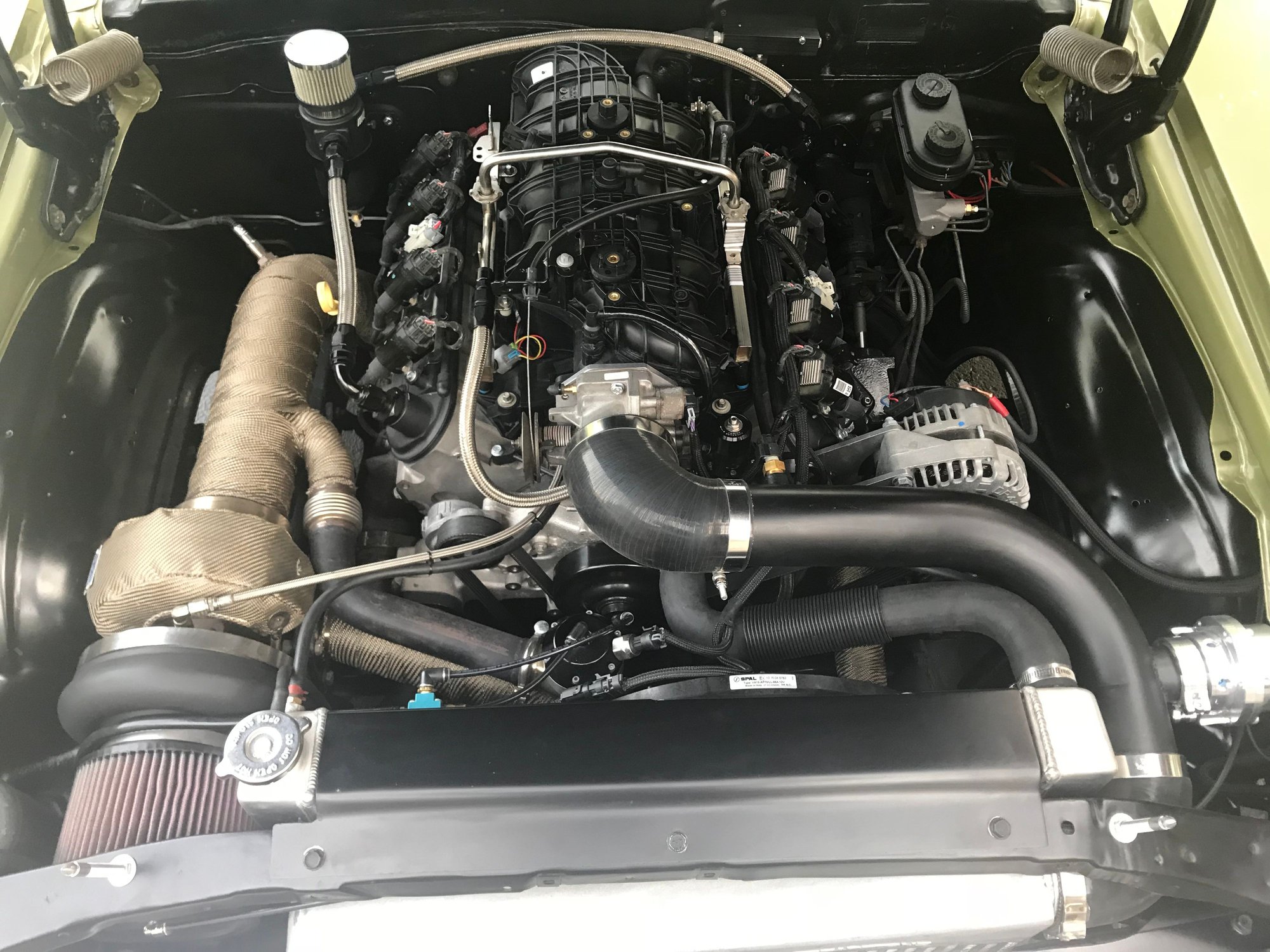

I run a mightymouse can setup draft style. Really cut down on the fumes at idle from engine bay.
Pulls from driver side VC and breather on the pax side VC. Suction is gotten via a hose attachment to filter on turbo inlet.

Here is mine. I should have taken pics when I built it, but it's 2.5 exhaust pipe with a cap on each end. Then there are dividers or baffles inside and the center where the hoses go in is stuffed with stainless steel scrub pads. Still need to throw some paint on it
