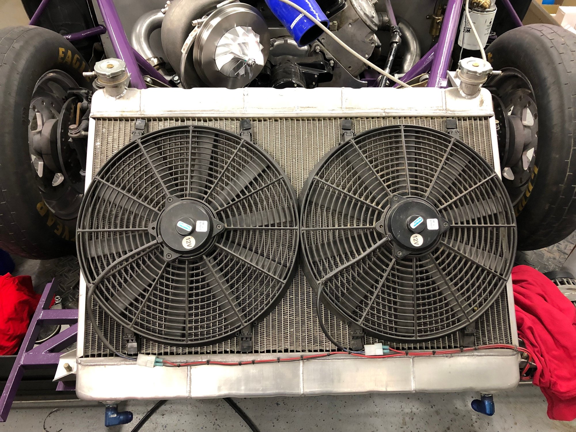

The car had a massive Griffin down flow radiator in it which I plan to use. It is somewhat split in half and suspect just a hole in the top and bottom bulkheads. So what I’m thinking about doing is blockimg the hole and run the right half to the engine and the left to the A2W IC. Aka heat exchanger.
You don't need a heat exchanger on a drag car. Heck you don't need one on a street car either if it's setup correctly.
