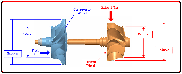

A/R is area/radius. Its a size ratio for the housing. You see people discuss it a lot as if it indicates the size of the housing itself, but it doesn't at all.
You can have the same A/R in two different housings with one being 3 times the size of the other.
The mm measurements are for the wheels. Inducer/exducer. Basically the small and large diameters of the wheels.
Look at a compressor wheel, the top edge of the wheel is the inducer diameter, the bottom end larger diameter is the exducer.
Most turbo sizes are rated by the smaller diameters, which are the compressor inducer and the turbine exducer.

Generic google pic, but this should help visualize what Joe's talking about.
Learn something new everyday, thank you sir!
