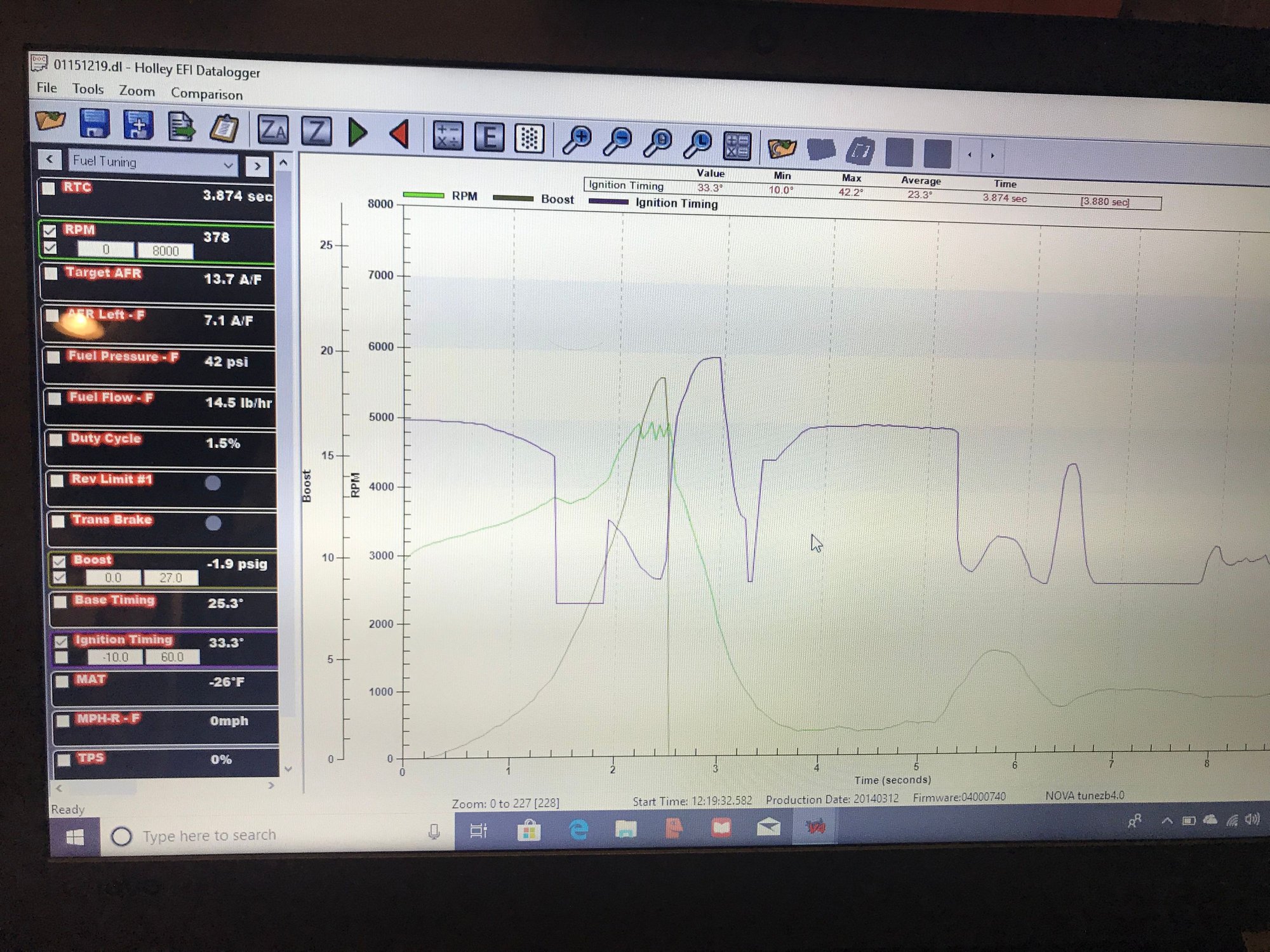

I run 2.25 off each manifold to a single 2.5 into the open flange. My 5.3 will make about 20 psi on the brake in around 2 seconds. This is with an S475/83 t4 1.25 turbo. You can see where pulling timing caused the dip in the RPM trace. Without pulling timing, it’s build faster yet. I wouldn’t worry about being divided on your t4 IMO.
