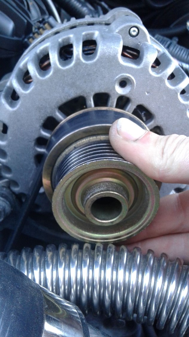

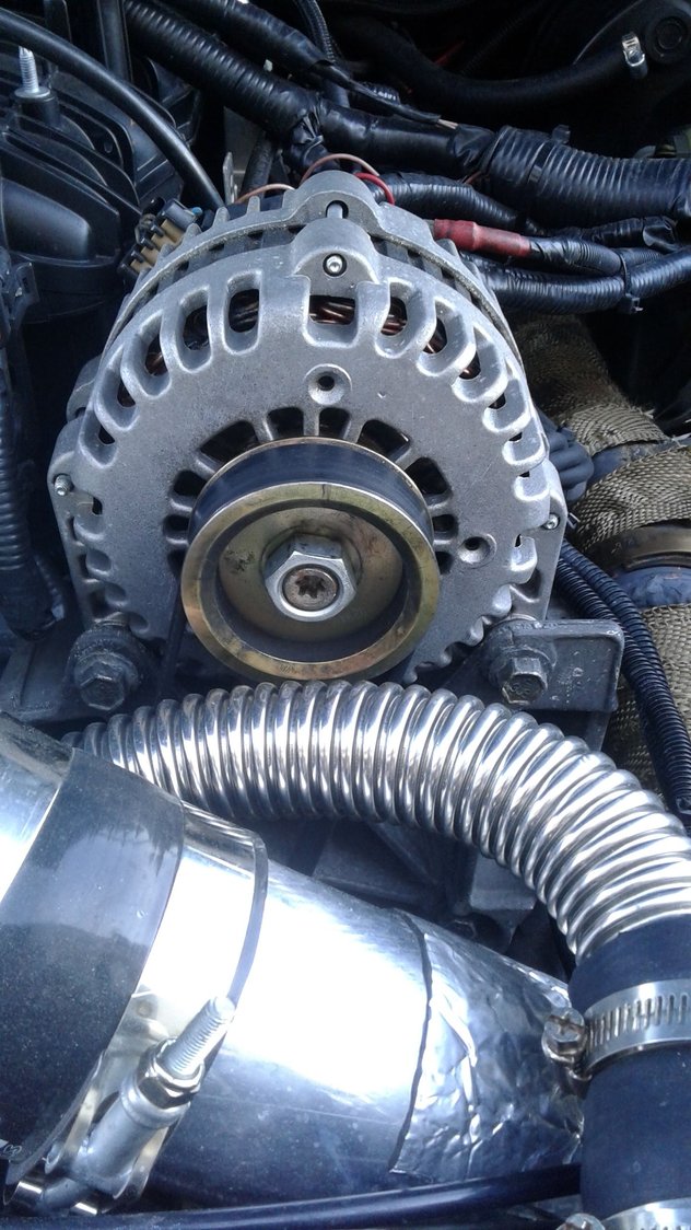

Hey guys, just wanted to share my fix for overspinning my alt and floating the brushes over 6000 engine rpm. Every one knows to increase the alt pulley size. But finding 1 in a junkyard can be tricky.
I happen to find 1 off of a 99 mercury cougar 2.5 v6 car. The shaft size is exactly the same, right at 17mm iirc. I measured it and it seemed to put the belt in the right spot. This pulley is really close to 3 inches in diameter. Before my voltage would drop to low 12s when I got the engine over 6000 rpm. With the new pulley it holds strong at 13.5 up to 6500. It also sits at about 13.5 at idle. This is with using the big truck 145 amp alt.
This is new pulley with stock truck pulley next to it.
This is a shot of new pulley. Upper hose isn't as close as it looks.
Moral of the story is you dont have to look at other gm cars to find little **** like this. Would be nice if we could get a list together of alternator pulleys that you have used to fix similar problems. If anyone wants to add theirs please list what it came from, the size, and which ls alt you were messing with.

Your problem here is your alternator. It has been well documented that some alternators are just **** and stop charging around 6k. Best to avoid them and get one that works fine.
The pulley in this instance is sort of a fix, but not the actual solution.

nah he's on the right track. the alternator shaft speed needs to stay under 18k max

Right with stock sized pulleys 7.5 crank and 2.4 alt at 6600 engine rpm the alt is spinning close to 20-22k. With this new pulley which is about 2.9 iirc puts me right at 17k.
Now I will agree after you have floated the brushes a few times it's prob cooked. Which is why I got a new replacement alt. But I installed this pulley on my old alt and it was wayyyyy better. Log showed voltage only dropped .5 volt. But the new alt is steady eddy with bigger pulley. Not willing to put the smaller pulley back on to test it tho lol
