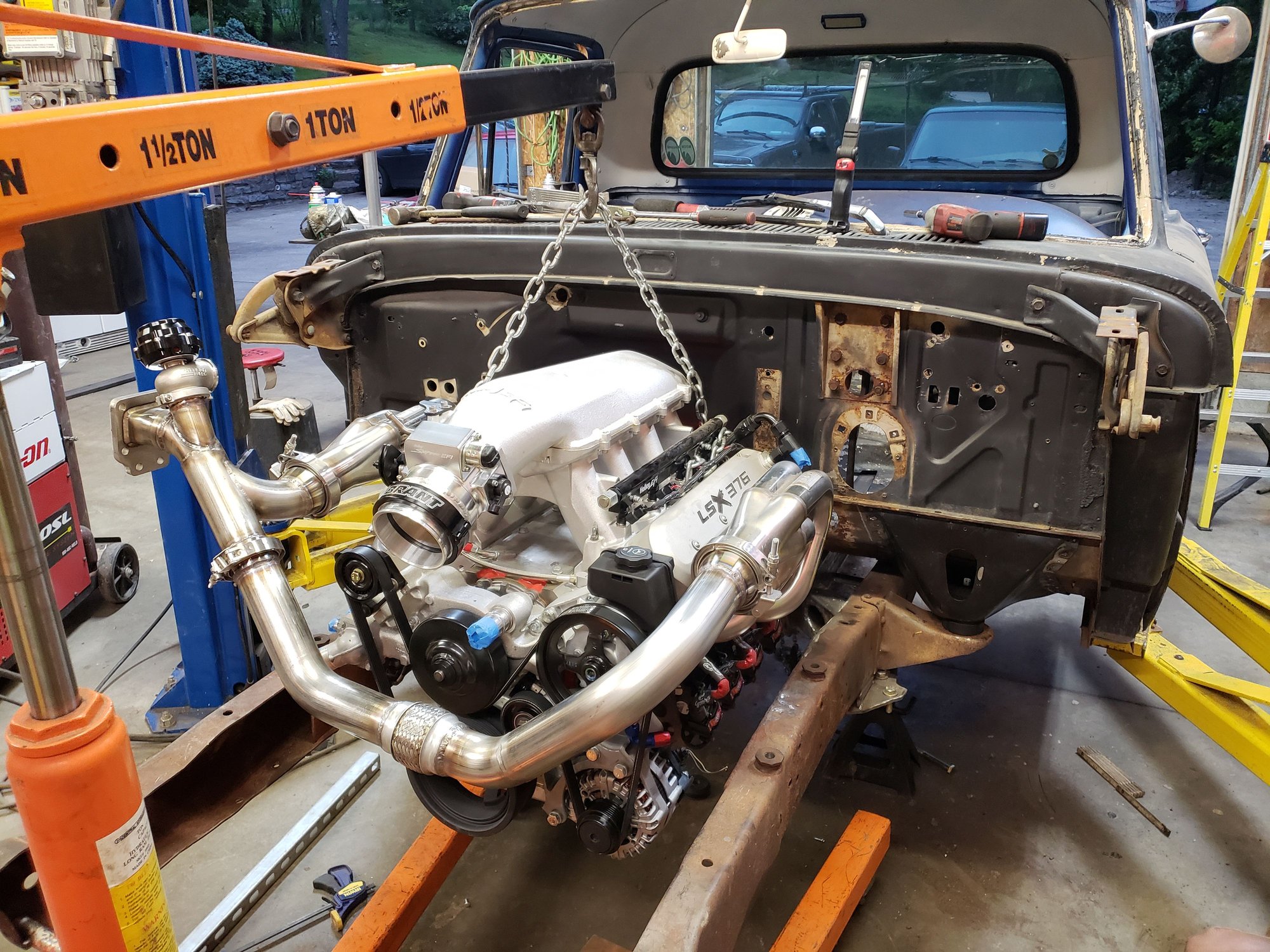

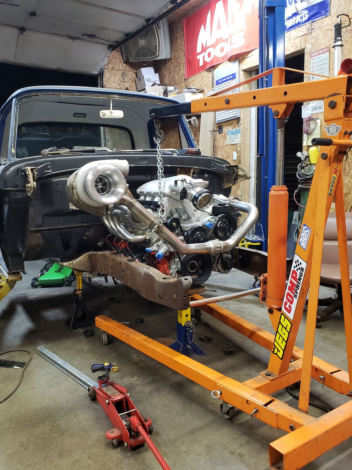

I'm having trouble finding info on this mod. I would like to know if its possible to drive on street with just a master. How do the brakes respond? What if any thing special do you have to do. I'm running turbo with forward and up headers" no room for master and booster" any part numbers recommend or just a bad idea. As you can see

Looks like you could get away with a snmaller booster and you regular master. Its hard to tell from pictures but it looks like a 7 inch brake booster which alot of folks sell would work there by the picture. Tuff stuff makes good 7 inch dual diaphragm booster but any brake company makes them too.

I did purchase a 7 inch booster and master but I have about 3 inchs from bottom of master to master. I think I'm going to try the manual road just have not seen much info other than putting on Hondas. I guess I need to call wilwood and talk to a tech. Just a little worried about drivability on street with manual brakes
