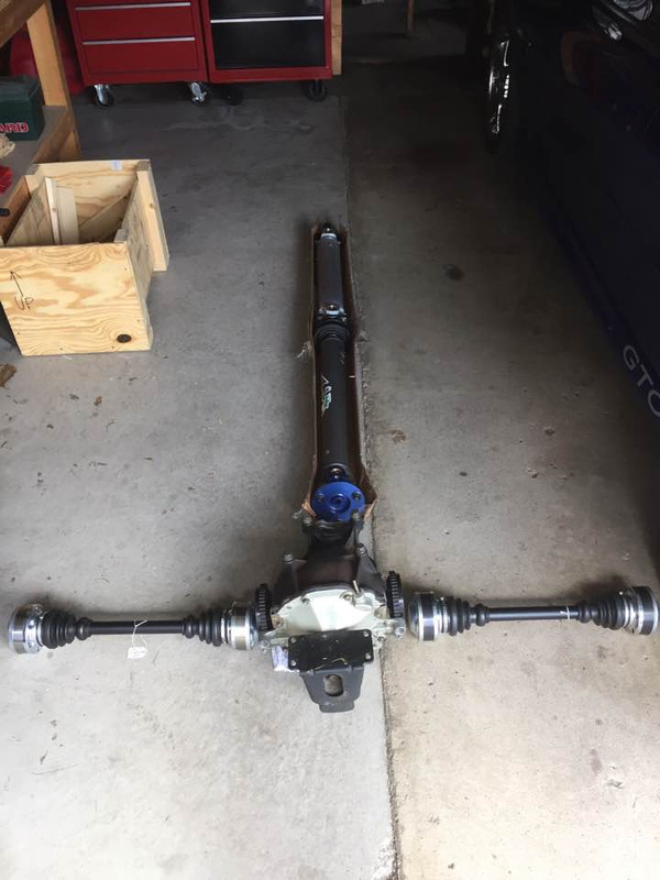

The original 1000hp aftermarket options ARE what I am talking about. They were modified 930 halfshafts. I have no knowledge of whether or not anyone actually had dedicated GTO halfshafts fabricated. As to what had to be modified, I never got too deep into the specifics. I can tell you that MT/DRs will twist the splines on the stock ones with anything much more than stock power. In my case, the CV joints broke before the twisted splines caused a problem. As an annoying coincidence, the only track footage I ever saw of my car was when the CV broke on a 1-2 shift. The rearmount never built boost before the launch (no 2 step), so the 1-2 shift was what really hammered the drivetrain. I think you are an a4, so your rear parts might survive a little longer.
You had a rear rear mount on a gto? I’d be interested in pics.
I guess ive just been lucky so far. My next purchase will be inner stubs then outer stubs. I have spare axles. After those break, or maybe before, I’ll replace the axles too. I don’t have a two step so I leave in vacuum only pulling 1.7 60 ft’s. I am going to add more boost in first gear so maybe I’ll get that down to a 1.6 but I’m not interested in leaving hard because parts won’t last at my power level. I hope to make up the time on the other end with high mph. I’ve always been one to worry about mph vs et because most street races around here are from a roll anyways.

Why not keep running the motor in the car now? SBE GTO record is 9.43 at 143 mph and that was with an F1a-94 so I’d figure with a turbo 140 mph should be doable.
Back in the day the first 9 second GTO was a rear mount sts kit. Outer stubs are the least of your concerns and the most difficult thing to replace. I ran hundreds of 1.5x 60’ times on stock outer stubs.

With an A4 and no wheel hop with 1.7x 60's you may be fine with stock stuff actually. For safety I'd at least do a drive shaft that is something I don't want to worry about. The posi units are hit or miss some last well into the 9's on A4 cars others do the one wheel peel in the 11's. I've replaced both of mine almost immediately so I didn't have to worry about it. First car was a kaaz posi and I loved that thing just not the $1100 price tag. This time around I got a deal on a low mile diff out of an 05 with a spool and fresh rebuild for cheap so I went that route.
If you drive the car to the track I'd spend money on the driveline for sure while continuing to run the stock motor. I take pride in driving to and from the track even though I have friends with truck/trailors ready to come get me. This is my current setup and I have $2500 in it. The rebuilt diff with spool plus brand new never ran level 2 gforce stubs cost me $900 to my door and I bought the driveshaft and half shafts new from a non-sponsor for lower than the DSS price with free shipping as well. If you trailer the car I'd do a driveshaft with safety loop and then run the rest of the stock stuff as it might hold up better than you think.
Pm me who you got your half shafts from. I was trying to keep the stock driveshaft because 1) don’t want vibration and 2) I believe the stock shaft takes the harshness out of the drivetrain and limits shock.
