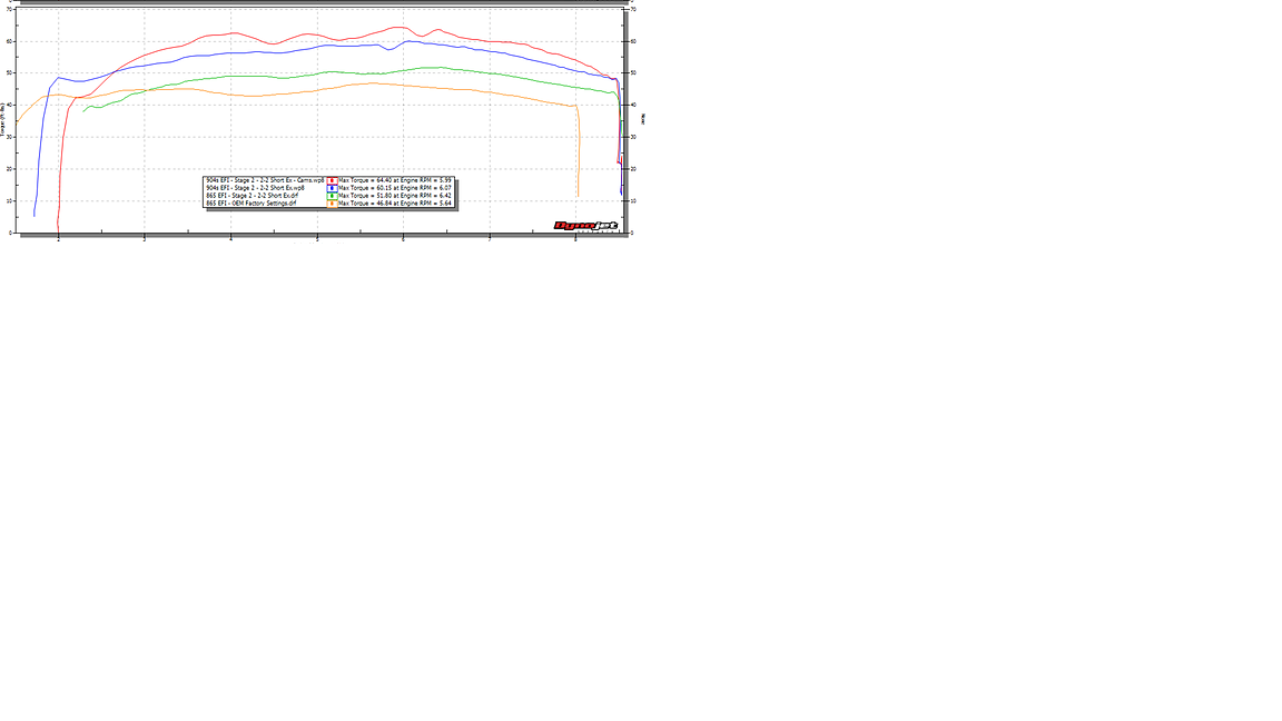

It's not that I don't want HP, I just don't need more power than I have now. What I need is the ability to apply it to the road for longer periods of time. I want to be pulling hard in each gear from 3000-7200 RPM, instead of 3500-5800. It just makes more sense to be able to put the power down longer, then to be flying through gears. It is a 6-speed after all
HP goal = 700 @3000 RPM and hold it through the power band (all the way to 7000). The smaller turbine was to support spooling to such high numbers so quickly. Would also like peak torque a little earlier, but hold it through the band. Unsure about the gate pressure, but there is a manual boost controller.
I have attached a dyno graph to try and portray what I am going for. I am aiming for the SHAPE below, not necessarily the numbers.
I am not opposed at all to talking to some suppliers about a good combo for my needs. I would like to use Precision, but don't have any previous experience with them.
The big thing here is I think that the car can be sportier. Trying to keep up with the STI's around town. On the highway it's no contest, but from light to light it's a little embarrassing. I don't have to crush them, but it would be nice to be in the race. Maybe even win one if they make a mistake.
Please keep in mind that I personally don't know what I am doing. If I did, I wouldn't be here looking for help LOL. I just have the info of the people doing the work that I myself can't do.
The turbo came off an old build and it was just an On3 ac delete kit, bigger fuel pump and injectors, on a stock everything else. Now that the motor is built, it would not surprise me that the setup needs to be changed.
Hopefully this can provide some clarity to those of you following along. I do appreciate all of the comments here, even the not so helpful ones
