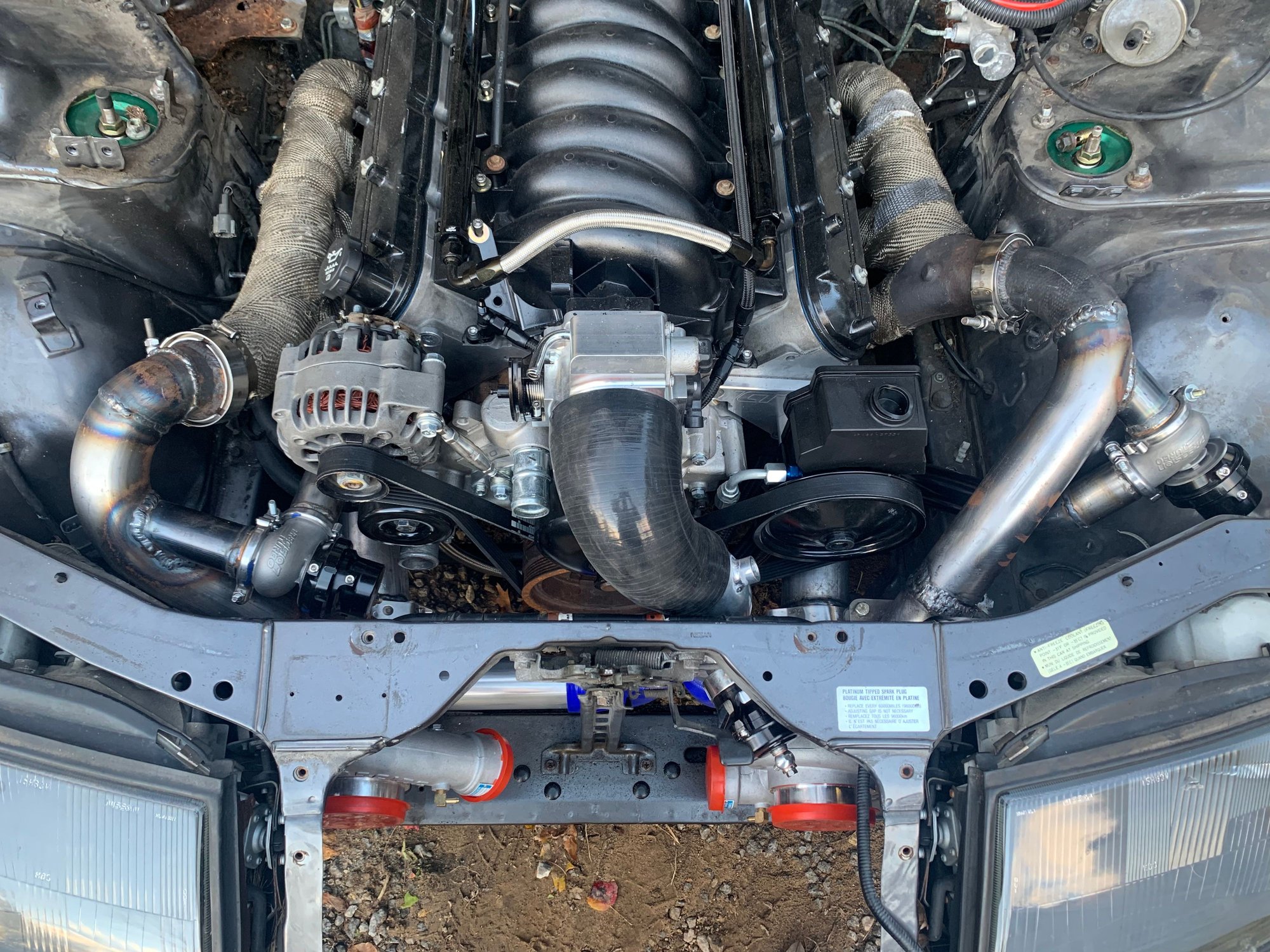

Sorry to beat this subject up as I’m sure you regulars hear it all the time. However I’ve searched through many posts. Always bring up old post from years ago. Anyways to the point.
i have truck manifolds up and forward facing. I’m not trying to have my wires burn up. So is there any better options that are proven and doesn’t cost $100 for a long uncut set?
https://www.jegs.com/i/MSD/121/31229...SABEgLnY_D_BwE
I cannot move my coilpacks from valve covers cause I have don’t have much engine space. Also downpipes from turbos run by motor mounts so coil packs are stuck on the valve covers. Just easier with them there. Since the picture taken, the turbo kit has been heat wrapped completely.

I'm not sure how you can avoid longer plug wires, The stock ones will obviously come up short and with boost you'll want a good set of wires because it's harder to fire a plug under boost and cheap wires will be the weak link. If that were mine I would figure out a way to mount them on the side of the strut tower.

look on ebay for a set of used nascar wires. i think i paid $10 for the ones on the blue truck.

i dont, sorry. sold the truck. I have also put them under the manifold next to the engine mount and used stock plug wires. cant find any pics of that either lol. but then you have to extend the coil harness and thats kind of a hassle

Use the 90's LT1 camaro wire set. Cheap auto zone set is fine. They are plenty long for most and they have the correct boots. They are plug and play. Also a neat trick is to wrap them with a metal hangar in them adn electrical tape. You can shape them however you need.
Personally I'd move the coils under those manifolds and extend the coil pack harness.

I ran pepboys lt1 stock replacment wires on my turbo ls3 coil relocation for a long time. Coils where stacked behind the heads. I bought msd custom fit wires eventually. Really couldnt tell a difference at 700rwhp between the two. Didnt seem to run better but they did fit a lot better. A couple of the stock replacment wires where too long so i had em looped and even though no one else could see it, it bothered me to know it was there.

eBay heat shields ( sleeves) on the plug wires

Fire braid sleeves to protect the wires..

The msd ones were only like $90 so not much more money. I’ll just get the msd ones I guess... I’ve spent so much more money on these little things than I feel necessary lol. Fittings, hose, ties, more fittings. I had the motor running already for the $5k and now I’m at about $8k and still buying small stuff like this. I’m super close and the money went into custom hotside, twins instead of the single before etc. just more than I thought it would’ve needed.
