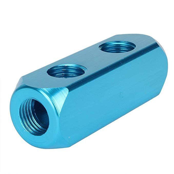

I almost did the same with some 2" aluminum round bar, but then I found this guy on Amazon for like $7. It wasn't worth the effort to do it at home.

Can't you connect one of the big ends to brake booster. The other big end to back of manifold. And the small ports to ur bov and boost gauge!
I agree. No use to reinvent the wheel when t blocks are reasonably inexpensive to buy online.
IMO a good mounting place is near the fuse box (assuming you have an fbody). I made my own angled bracket to mount the block using Harbor Freight alumarods with a Map gas torch. The angled bracket allows the block to be mounted level instead instead of at an angle if mounting the block directly near the fuse box.
