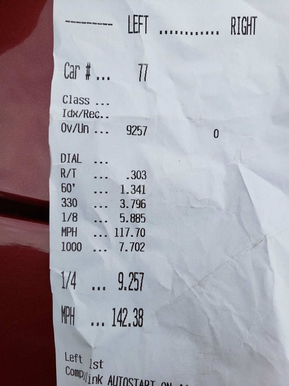

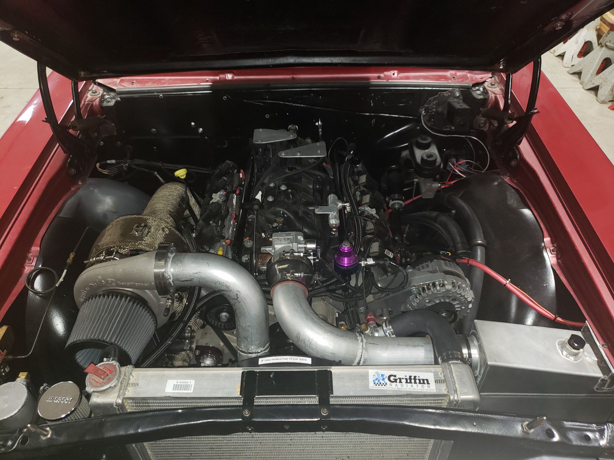

The car has been running for a year and ended with a personal best. Nothing record setting, but a good start for next year. It's a JFR 218 with valve springs in a 6.0, s478/92, powerglide at 3350lbs. This was leaving on 7# and going to 16#s. The internet almost had me convinced the 20 year old 3 way comp and single adjustable shocks would never work. Thanks for all the info.

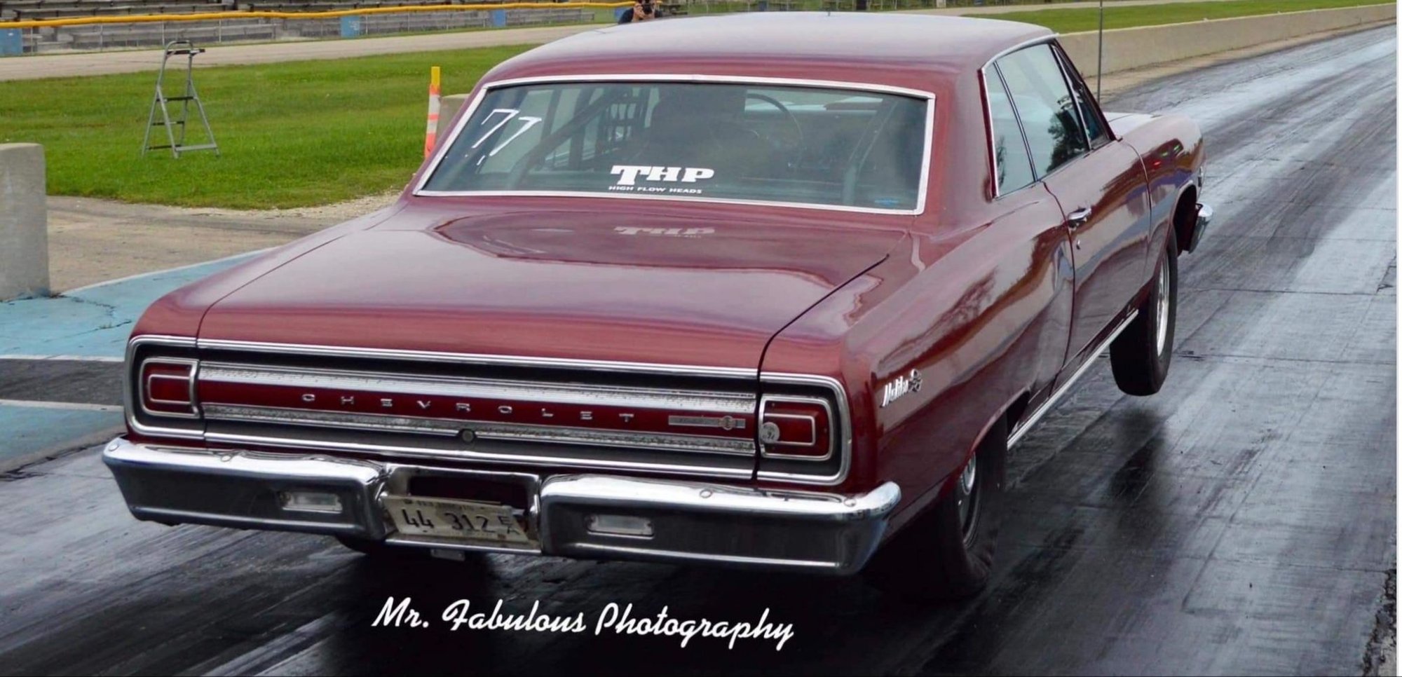

Leaving hard enough to open the fuel filler door! Need to see more pics of the car and hear about the build. Car looks great! Seeing less and less of the '64 and '65's.

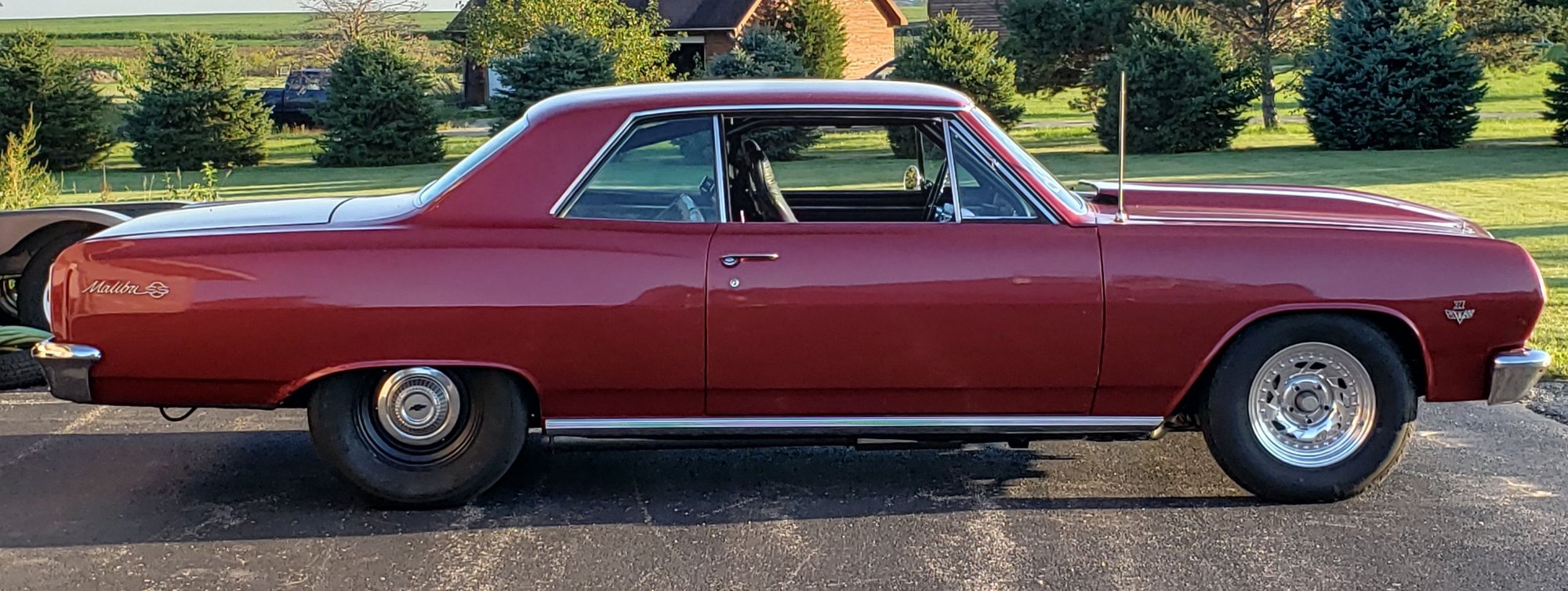

This is how the car has been since 1998 when I installed the cage and did the rear frame notch

looks good. love the dog dish look.

Thanks, next year they should be all four corners of the car. If it wasn't for 3 window helping we out with the Holley it still may not be running.
Good catch on the fuel door, now THAT'S how you leave!! Car rolls out nicely.

That was the “g meter” back in the day! How long it’d stay flapped open and how far down track fuel would be dumping out of the filler neck!

It's has only been on e85 so far. The motor is a smijin over 10.1.
