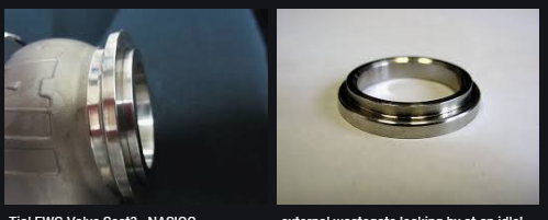

So you ruled out the BOV leaking, thats good. Should still try to rule out the gate IMO. Did you install the "seal ring" under the WG valve? Verified the valve is 100% closed and opens with shop air around spring pressure?
