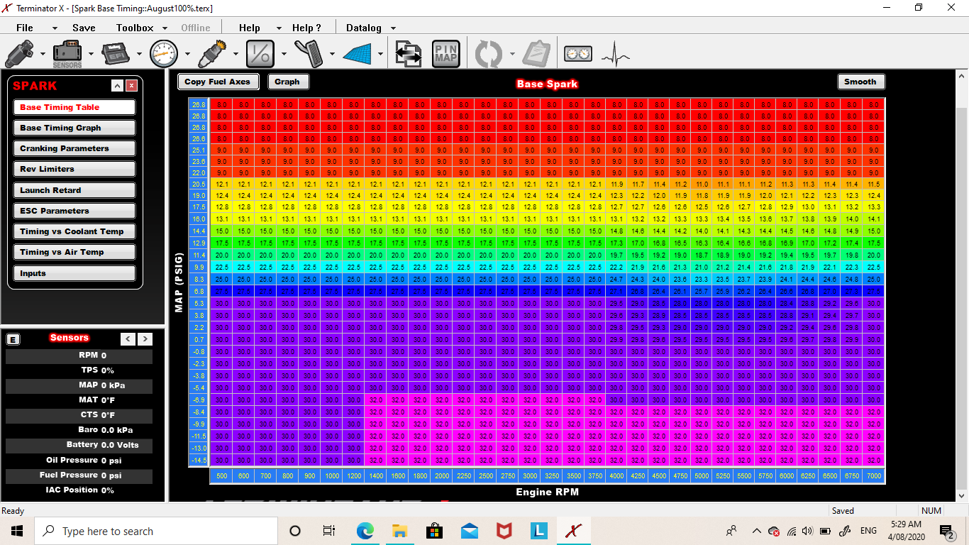

Old Jul 28, 2020 | 11:09 PM
  #65
lscamaro234's Avatar
Joined: Feb 2019
Posts: 157

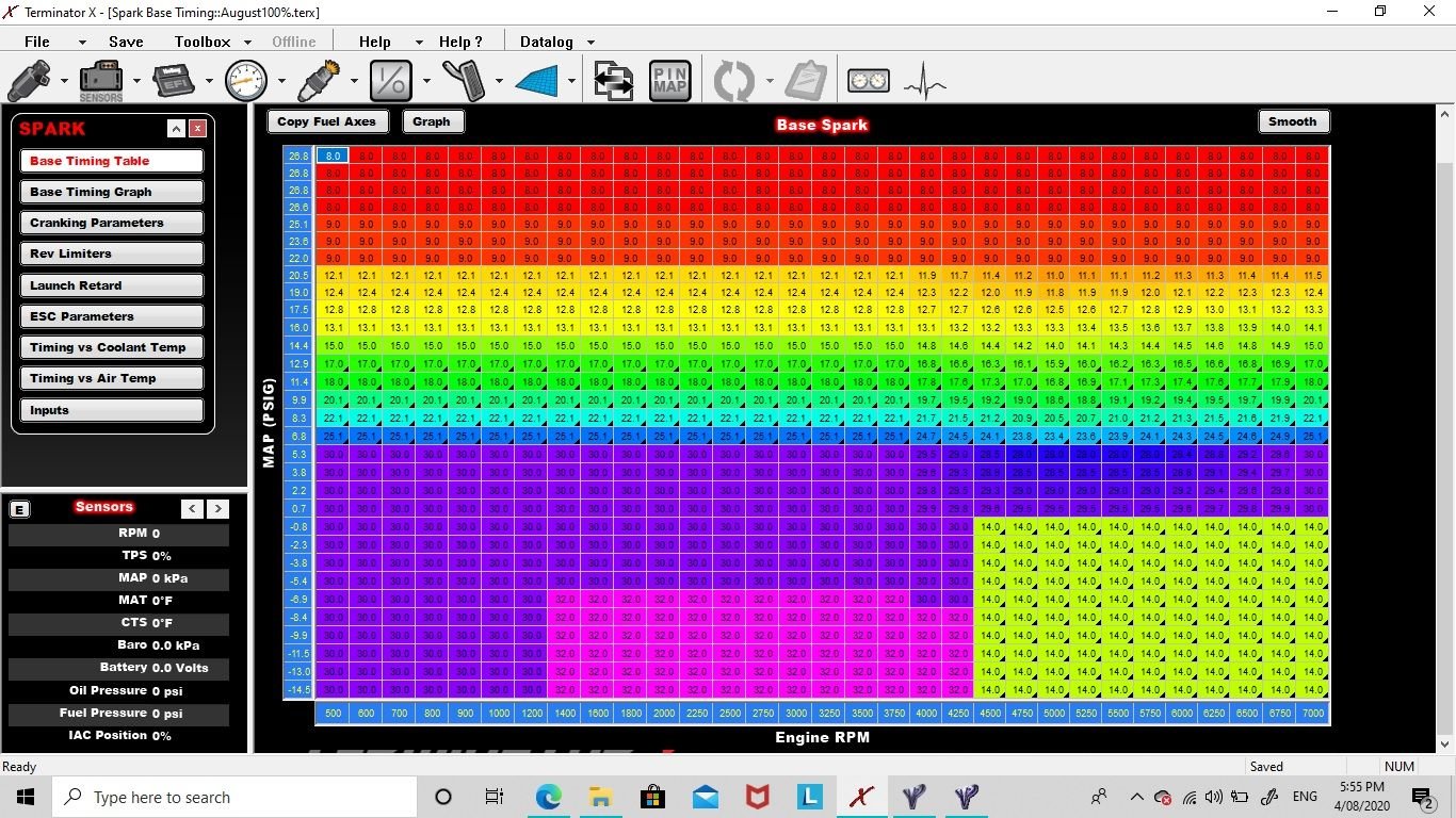

Old Aug 2, 2020 | 11:38 PM
  #71
Joined: Feb 2019
Posts: 157

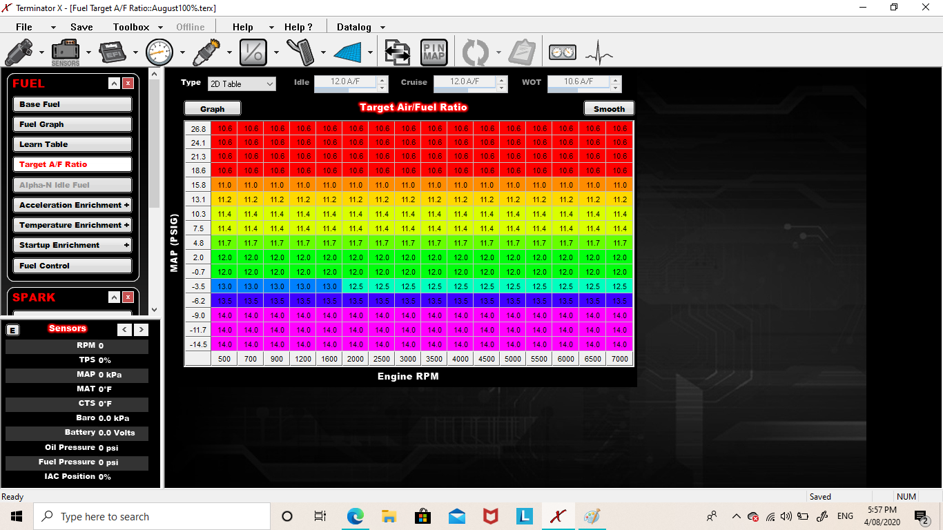

Old Aug 2, 2020 | 11:44 PM
  #72
Joined: Feb 2019
Posts: 157
the idle seems to be a bit rougher , like not as strong .
could this be the plug gap? ive got it booked for another dyno tune soon , so hope to get some good power figures

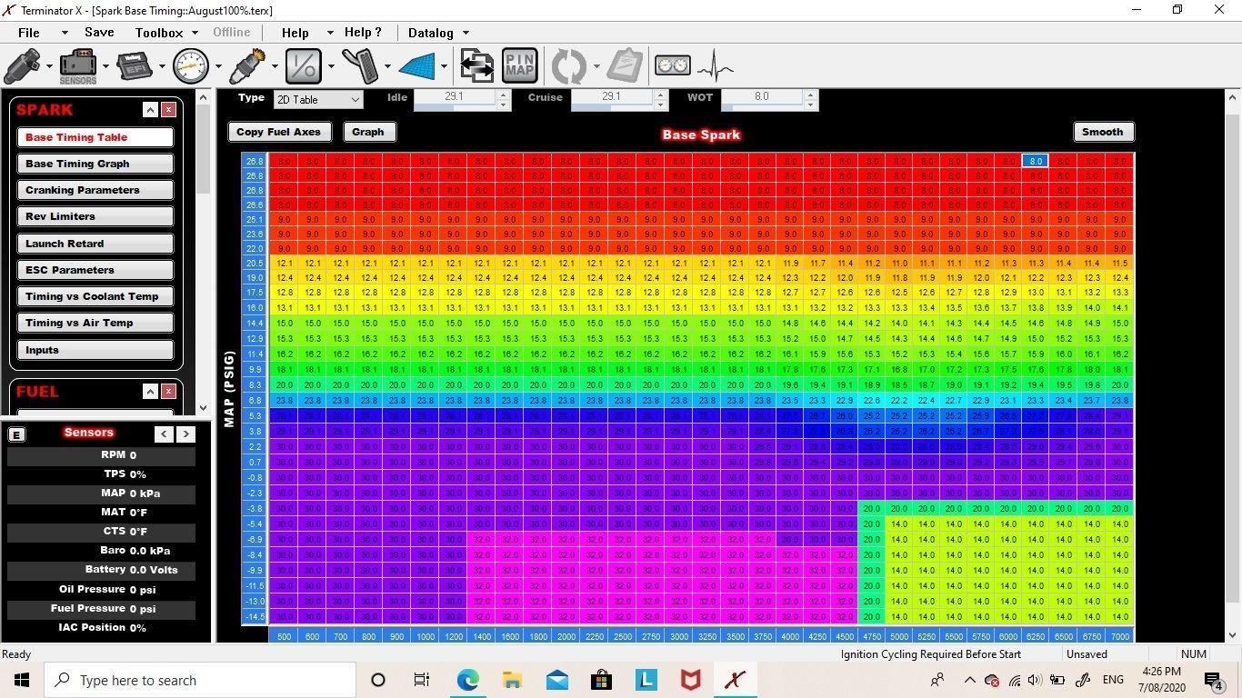

Old Aug 3, 2020 | 03:00 PM
  #74
Joined: Feb 2019
Posts: 157

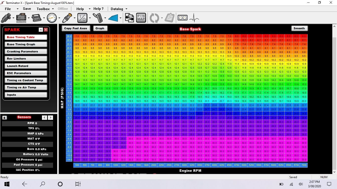

Old Aug 4, 2020 | 03:29 AM
  #78
Joined: Feb 2019
Posts: 157
Old Aug 4, 2020 | 09:46 AM
  #79
Forcefed86's Avatar
Joined: May 2011
Posts: 8,483
Likes: 1,027
From: Wichita, KS
Pretty much! Every combo is different. Some setups are more sensitive to AFR than others. My rx7 picked up a full mph back to back leaning it out from 10.8ish to 11.5ish. My mustang could care less if it's at 11.0 or 12.0. So I run it at 11.0. 15lbs IMO is still reletivly low boost on E85. You shoudl be more than fine at 11.5 from 7.5 to 15.8psi... assuming all the plugs look relatively similar heat wise.
