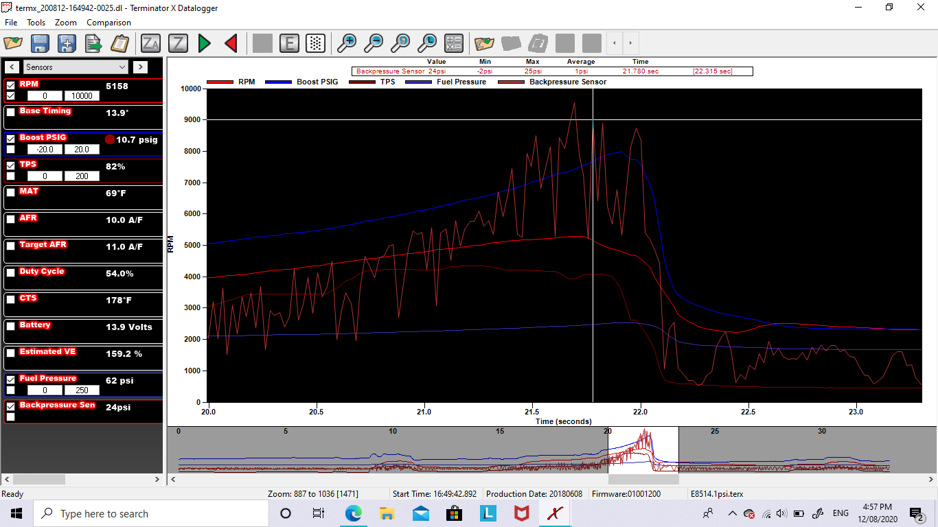

whats a decent backpressure ?
mine seems pretty high , finally got the gauge hooked up
reading peaks of 24 and 25psi @ 11psi boost
22@9
Old Aug 12, 2020 | 02:46 AM
  #84
lscamaro234's Avatar
Joined: Feb 2019
Posts: 157
although at 10/11psi the backpressure jumps from 24-16-24-16
so would i call this in the middle and say 20Psi

No solid answer there... less is best. 2:1 or greater and your done for the most part. A lot will depend on the cam and overlap. Do you have a smoothing option on the Holley? That's a heck of a bounce in that signal. Where do you tap for BP?
Old Aug 12, 2020 | 07:43 AM
  #86
Joined: Feb 2019
Posts: 157
sensor line is tapped into the exhaust housing of the turbo.

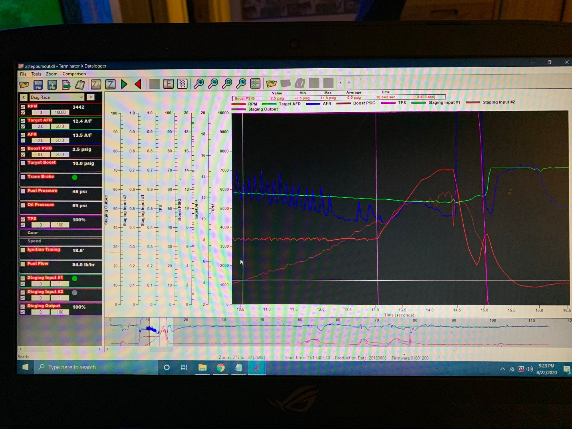

Hmm that’s pretty weird. I had a strange thing happen with mine yesterday. Was playing with stuff to build more boost on the foot brake. I left on 9psi and it tapped the 7k limiter a couple times and almost like... ignition cut. Came back on around 1900 rpms.
You can see in the log where I have a strange sudden dip in the boost And the rpms drop like a rock, picking back up at 1900rpms
