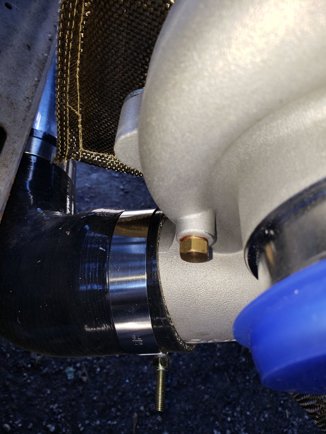

Also to run just on wastegate spring. Do I need to run a hose from the turbo to the bottom port of waste gate or not

Standard silicone hose off ebay/Amazon works just fine. And to run of wastegate spring only you need to run a hose to the bottom/side port of the W.G. Typically you would reference it from the intake piping pre-throttle body though to account for any lose of boost due to the intercooler/leaks.

Standard silicone hose off ebay/Amazon works just fine. And to run of wastegate spring only you need to run a hose to the bottom/side port of the W.G. Typically you would reference it from the intake piping pre-turbo though to account for any lose of boost due to the intercooler/leaks.
I think you made a typo -should be post turbo. To the OP many turbos have a npt port at the outlet - perfect for wastegate reference
It should have said, pre-throttle body. Had a brain fart, thanks for the heads up

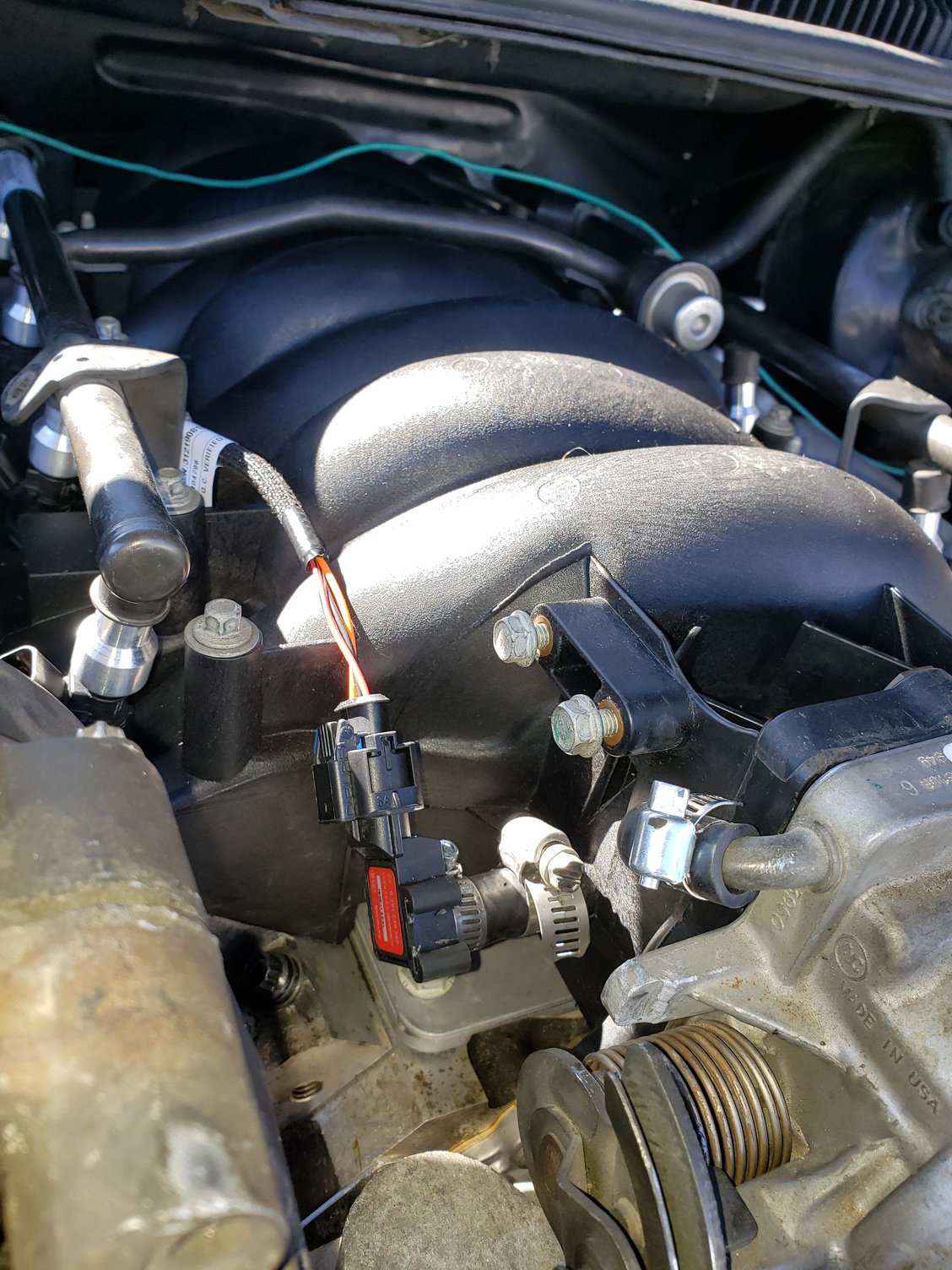

Is this ok location for map sensor

Can I run a hose from here to my blow off valve

Yep. Stock works well too for the map lol. Bov location is fine too.

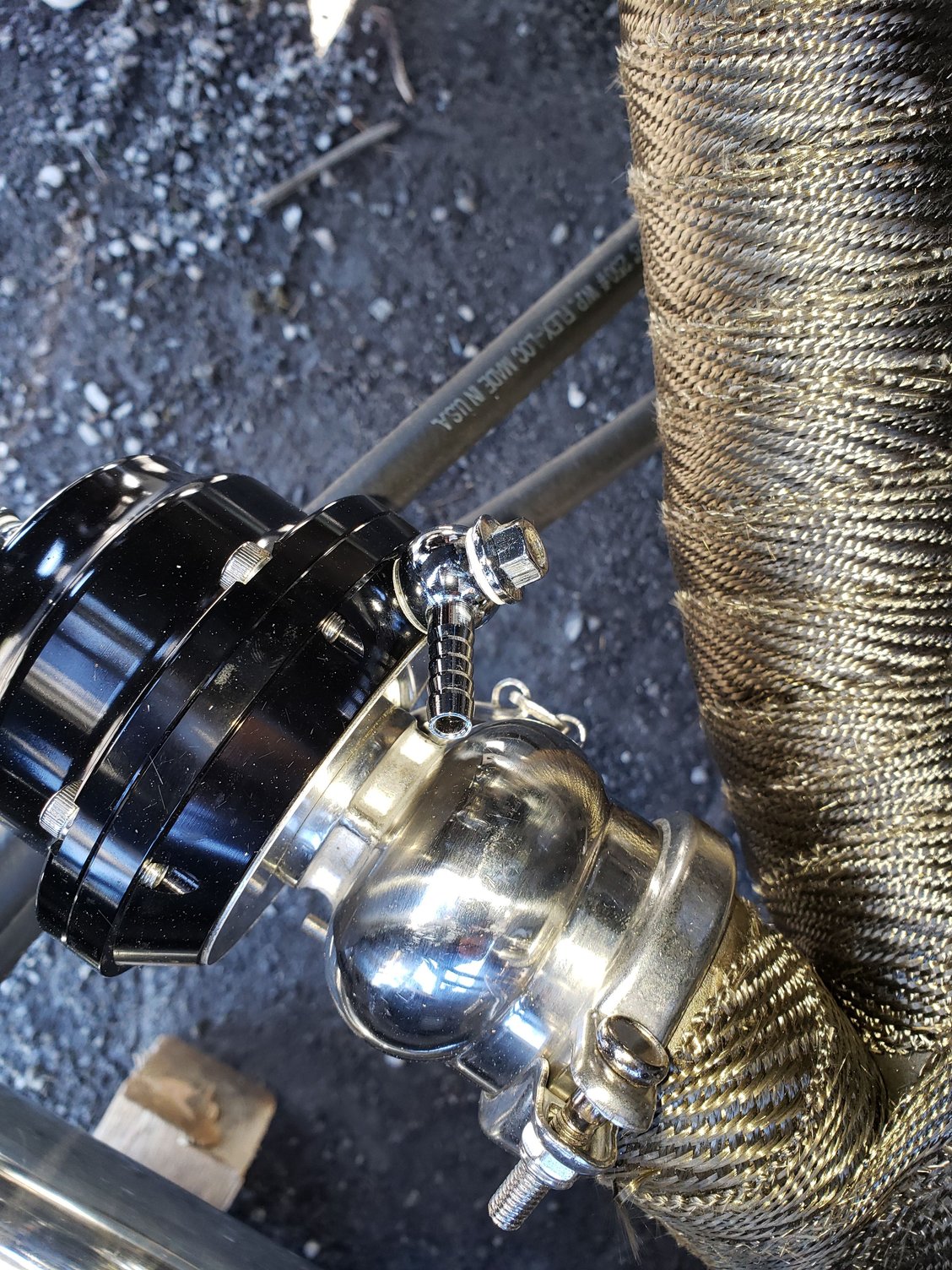

Can I take this plug out and put a nipple on it. Then run hose to bottom of wastegate. It should then be running on wastegate spring only. Right
Old Feb 19, 2020 | 06:34 PM
Jwooky's Avatar
Joined: May 2013
Posts: 270
Likes: 30
From: Detroit
Yes thats correct
